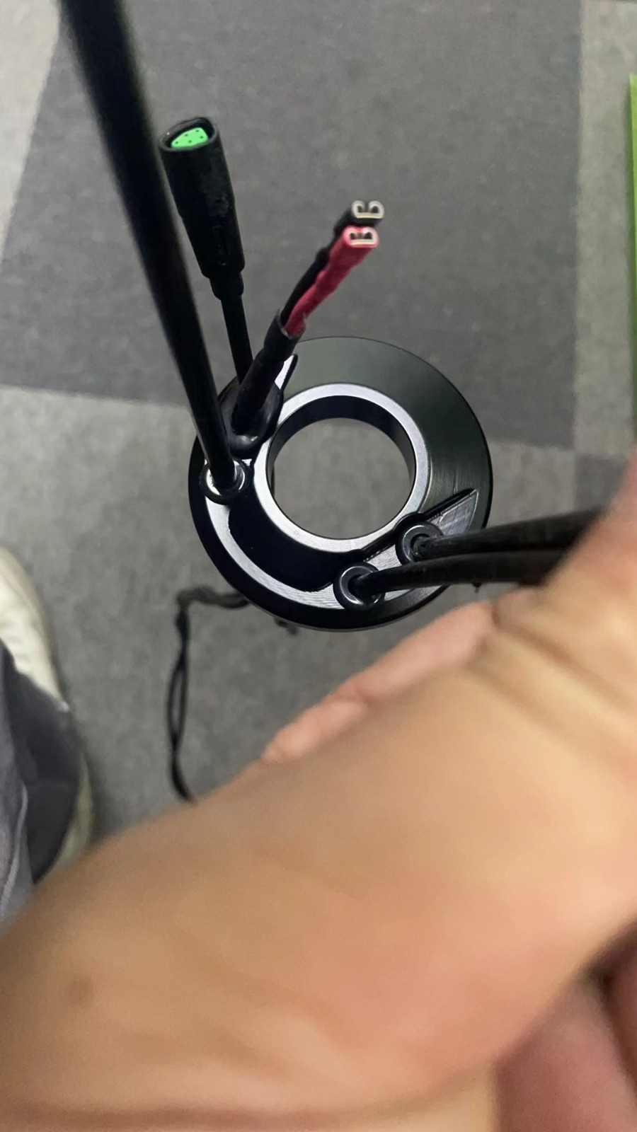

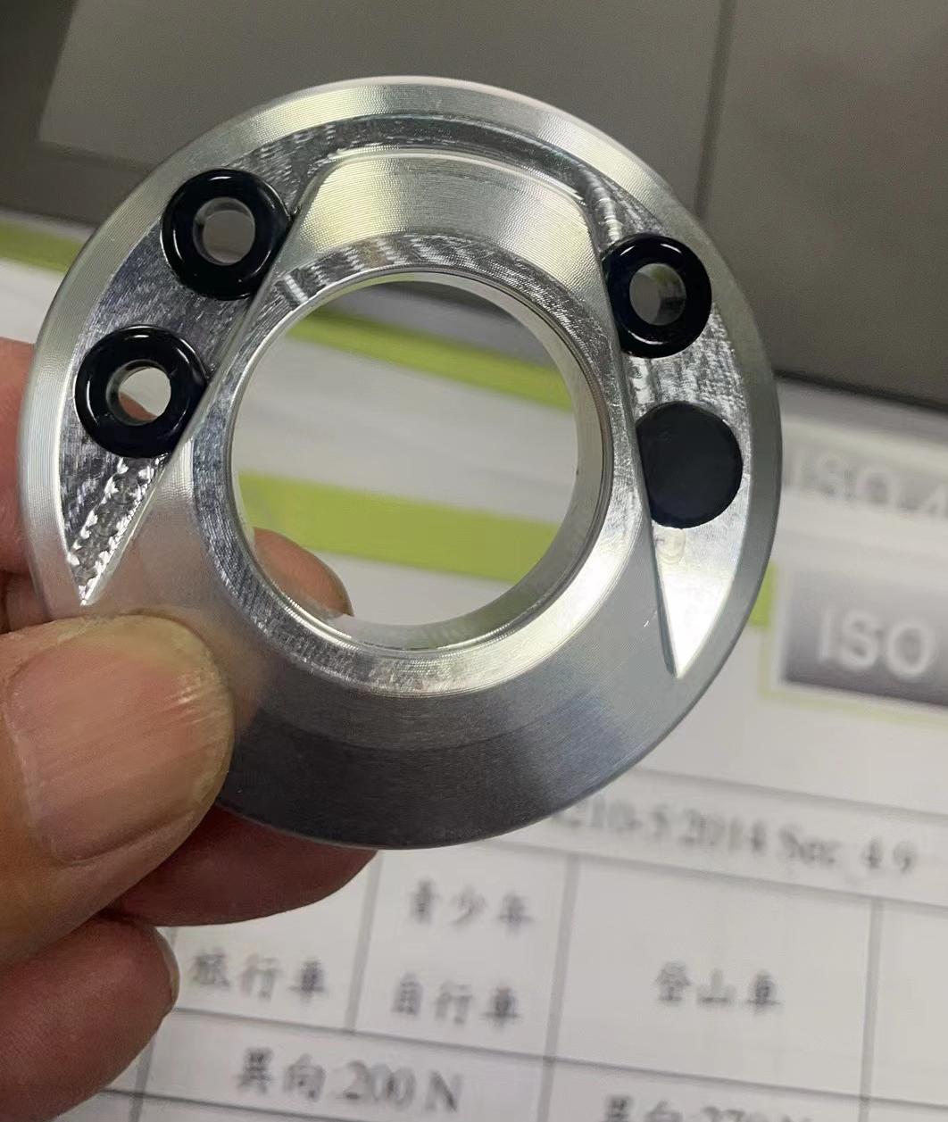

Newest headset cap protoype from Zhaosheng.
Looks good to me.
Mine View attachment 125377

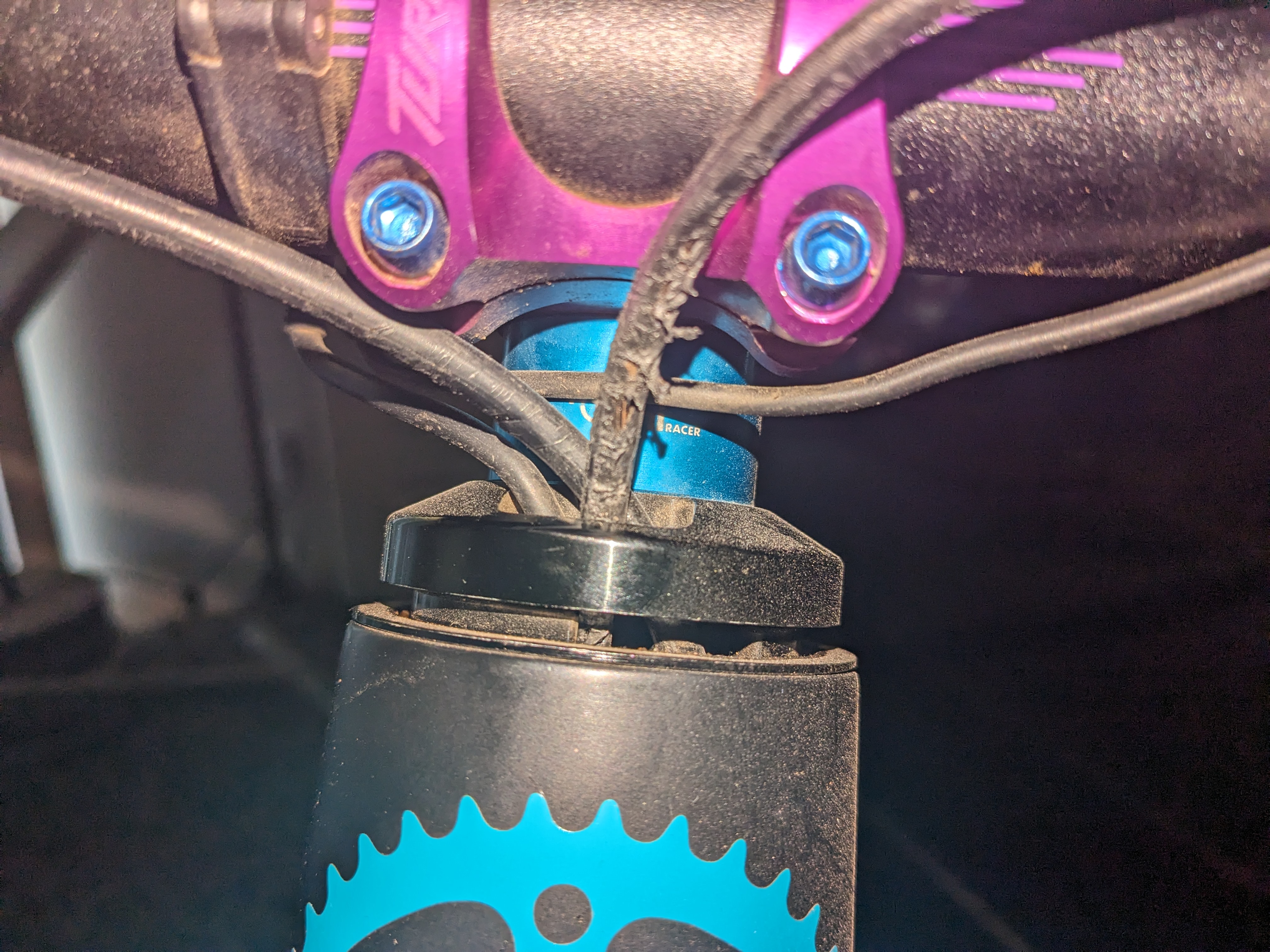

Linda said will be ready later this week!🤞 (No price for upgrade yet). Stock has shredded my dropper cable as expected. And water ingress for headset creaking. 🫣

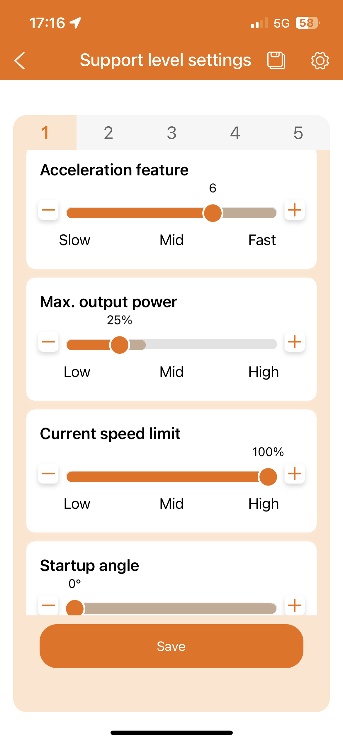

thaeber
Jan 26, 2021
843
741
Bruchsal, Germany

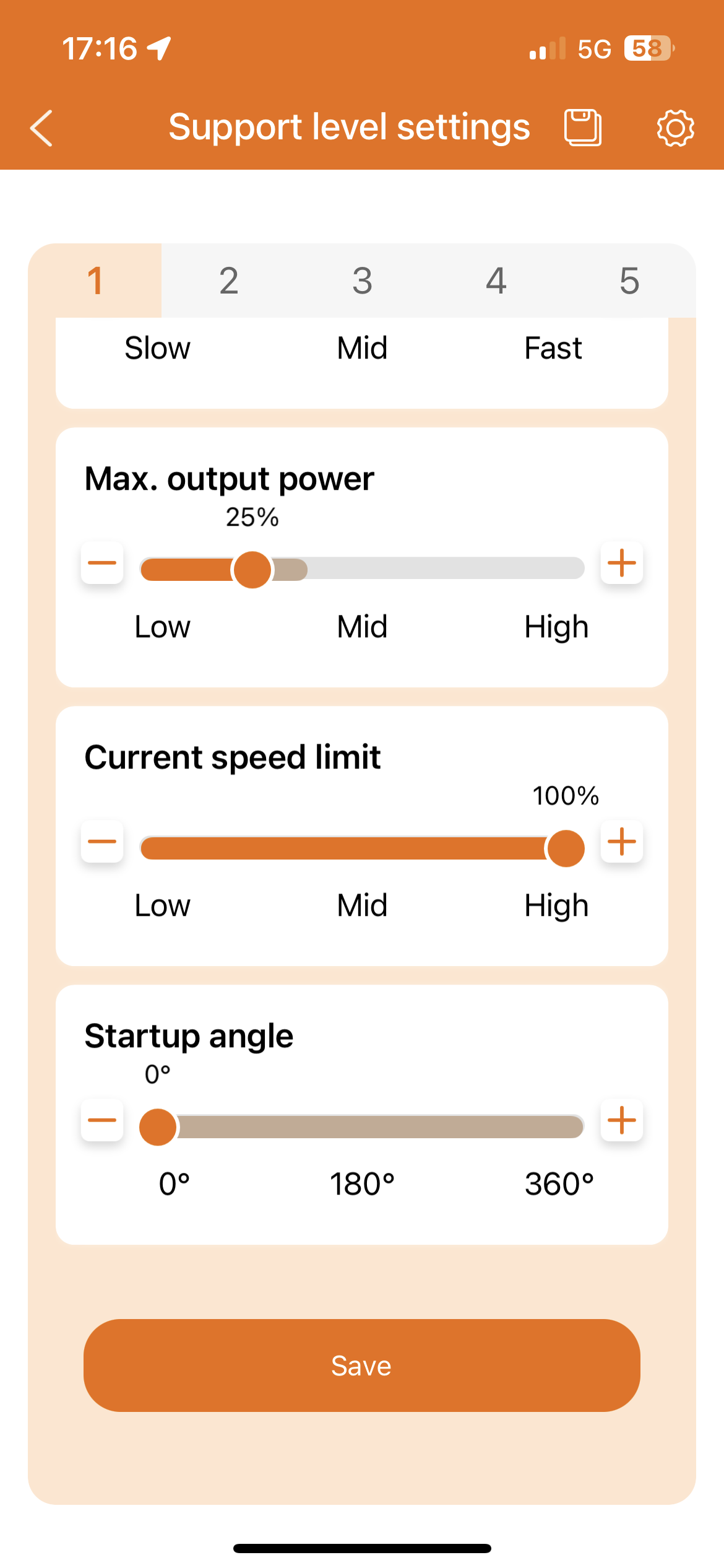

I have the V3 display and connected it with the Bafang Go+ app. You can adjust acceleration feature and startup angle (valid for all 5 PAS) the speed limit for each PAS, and the max. output power for each PAS in a very limited range. I played a little with it, acceleration feature i could not recognize a significant effect, strartup angle I only set to 0 because I want immediate acceleration. The other settings- hmmmm, I personally dont want a lower speed limit here in EU, and the minimal range You can adjust max power is basically useless for me. Summary: For the time beeing I don’t urgently need it.

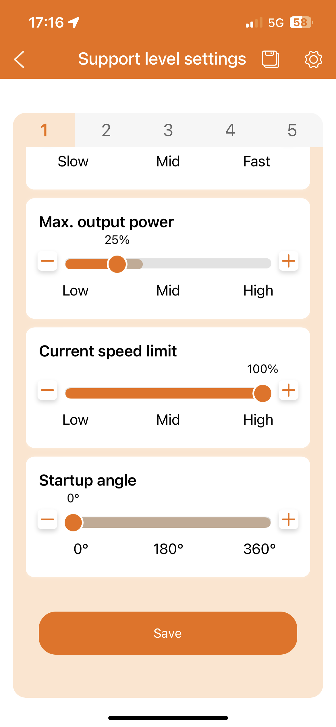

spokemon
Apr 4, 2023
166
85
View attachment 125470 View attachment 125471
I got my DP C245 v3 from Linda.
@thaeber These are almost exactly the same settings I used.
My initial stock settings felt ok. But I wanted the motor to assist earlier, there was a delay before the motor assisted.
Changing the angle startup to 0 solved this problem.

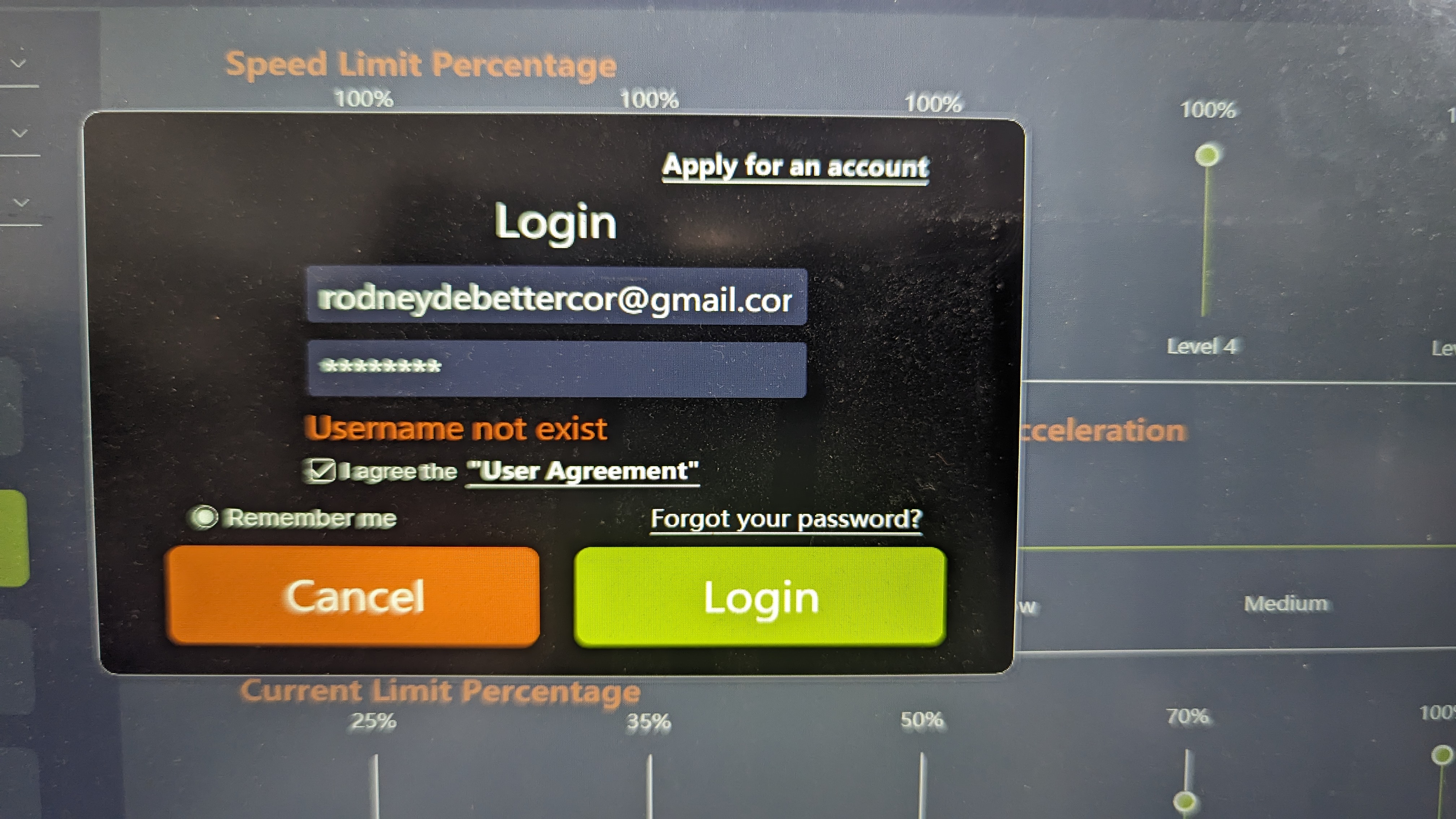

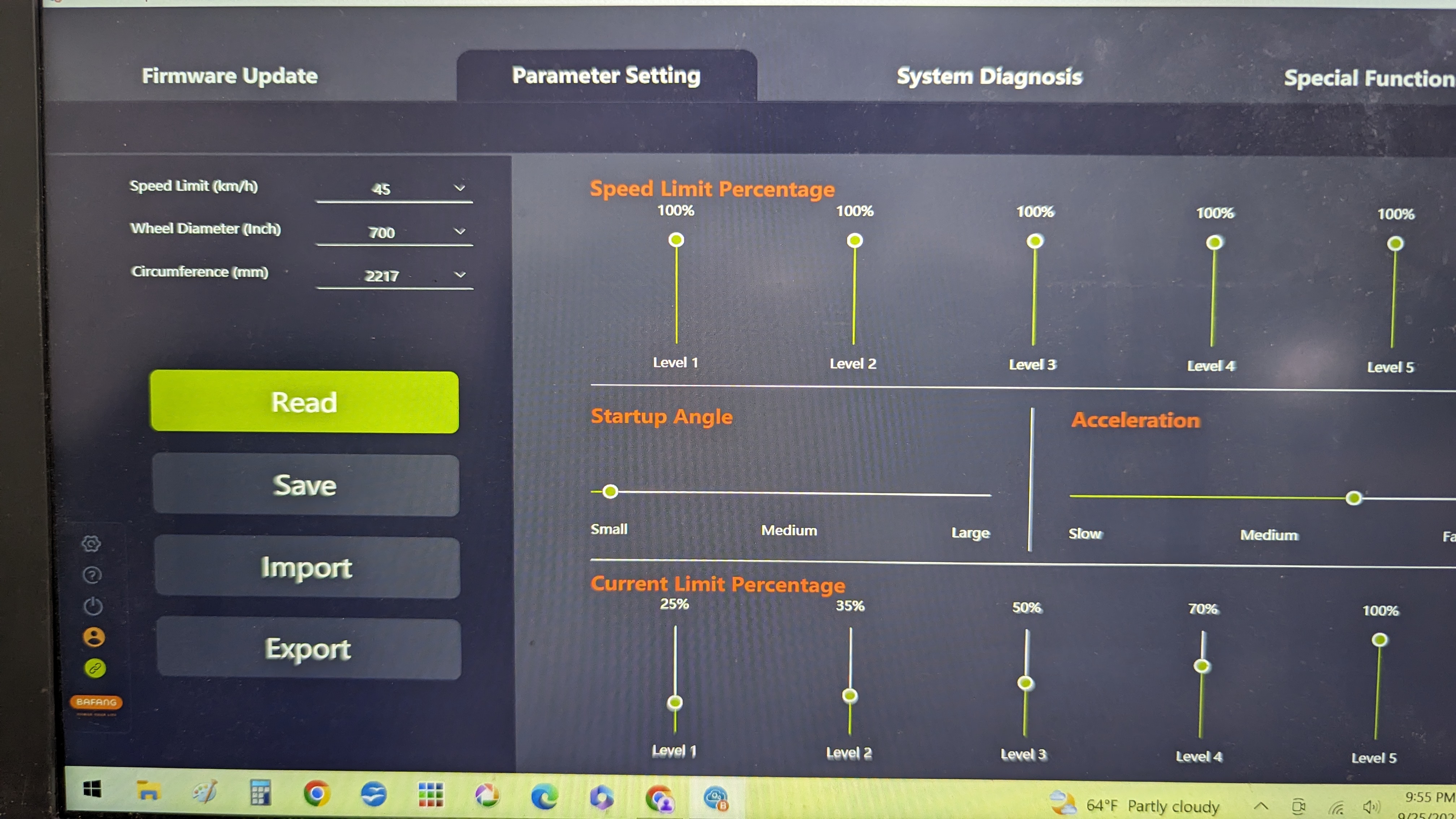

petkevich
Jun 6, 2023
22
14
San Diego
I think the BEEST tool only lets one recalibrate a new controller. Also, check battery voltage. The BESST -pro for the LBS they do speed adjustments and also clear error codes...still limited.
These are my motor settings from the besst tool. When I try to change, changing the slider settings and hitting save I get I need an account credential. Does anyone have one I can use?
LAnton
May 12, 2022
422
354

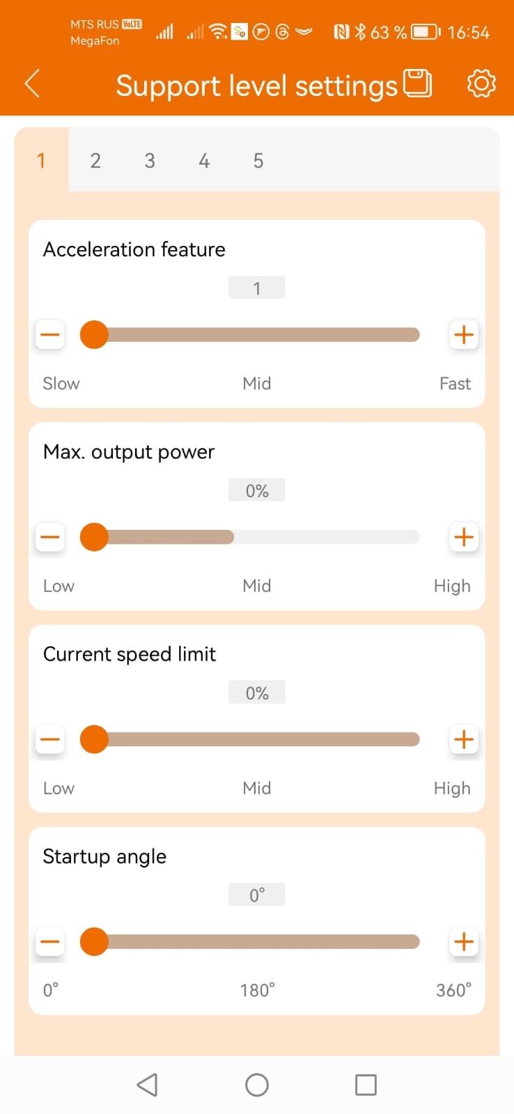

Russia
Thank you. Now I have found these settings too :). It is very convenient to set up and test the motor on the phone.

TCFlowClyde
Feb 26, 2022
937
546
Mesa, AZ
View attachment 125497 View attachment 125498
It's been almost a year ago, but I went to Bafang-e.com website and then to BEEST tool drop-down menu to request a secure password. Bafang emailed it a day later if I remember correctly.
My understanding is that the GO+ Bluetooth (V3) on the DPC 245 display is the only device that allows power level tuning for the consumer. I wasn't able to adjust anything via BEEST tool. But maybe they changed it since I last logged on due to firmware updates? Sorry that's all I know on BEEST.
