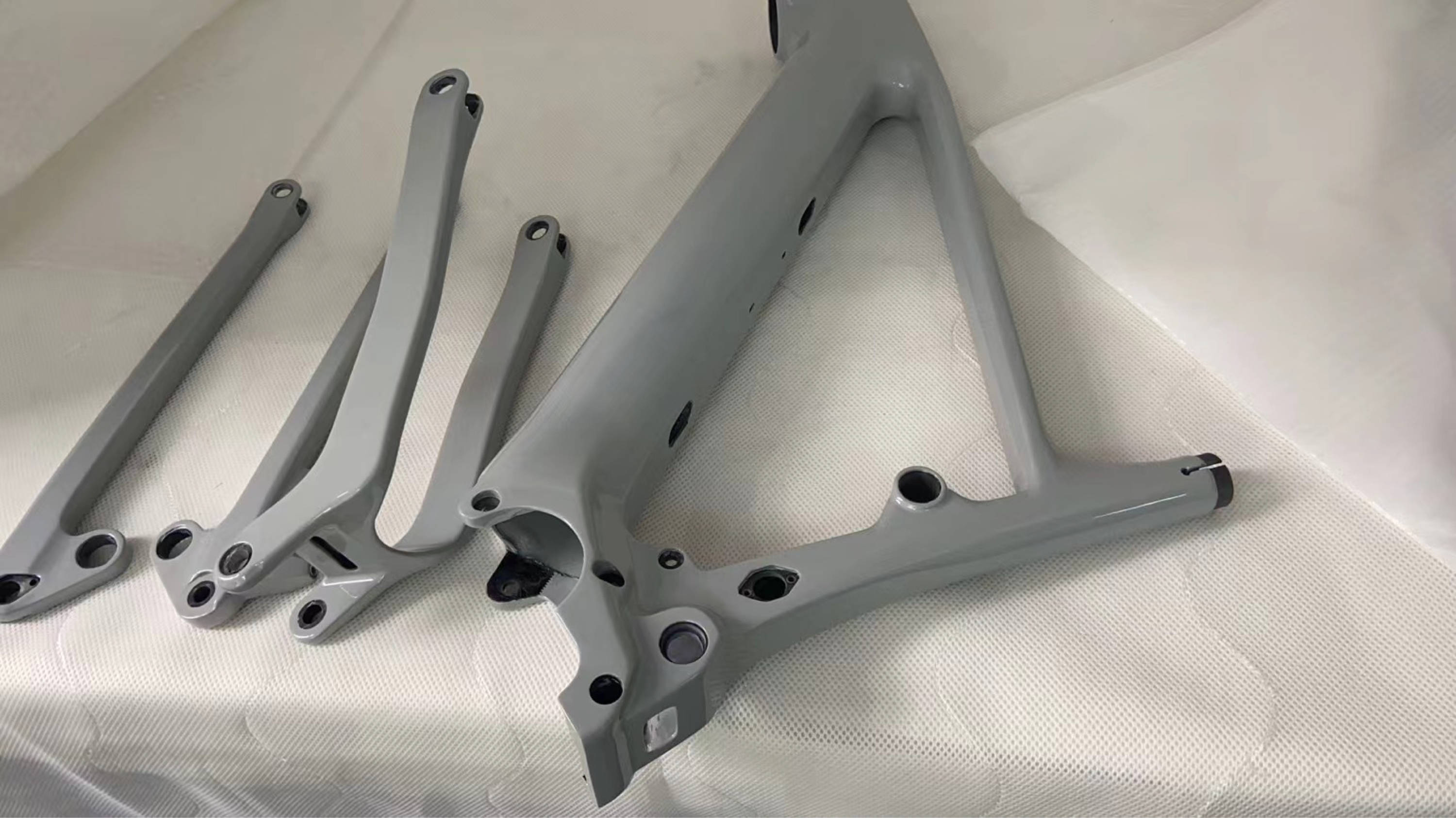

They sent me a picture of my frame... painted (Porsche "Chalk") and waiting to be sent next week. Should get a few more pictures of it once assembled in the next few days
TCFlowClyde
Feb 26, 2022
1,222
786
Mesa, AZ
Looks great!! Actually cool color choice. 💍Someone else showed their's with complicated patterns...looked good too! Very professionally done.👍
Now, I'm thinking about having them paint mine during my extra, extra delay. I do use rattle cans to fade then add clear wrap...but wrap and/or helicopter tape not that cheap. $30 for factory paint is unbeatable... usually it's not. That was my main issue... painting was gonna be extra long, but mine will be way late anyway...still waiting on them to dial in the 720Wh.😑
