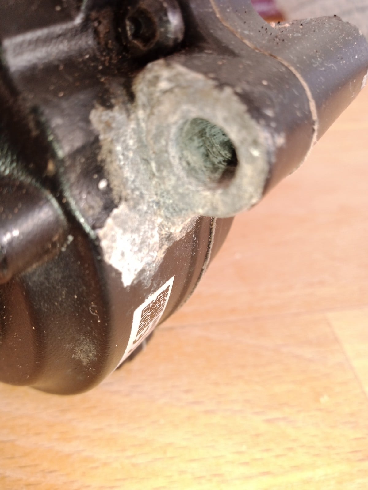

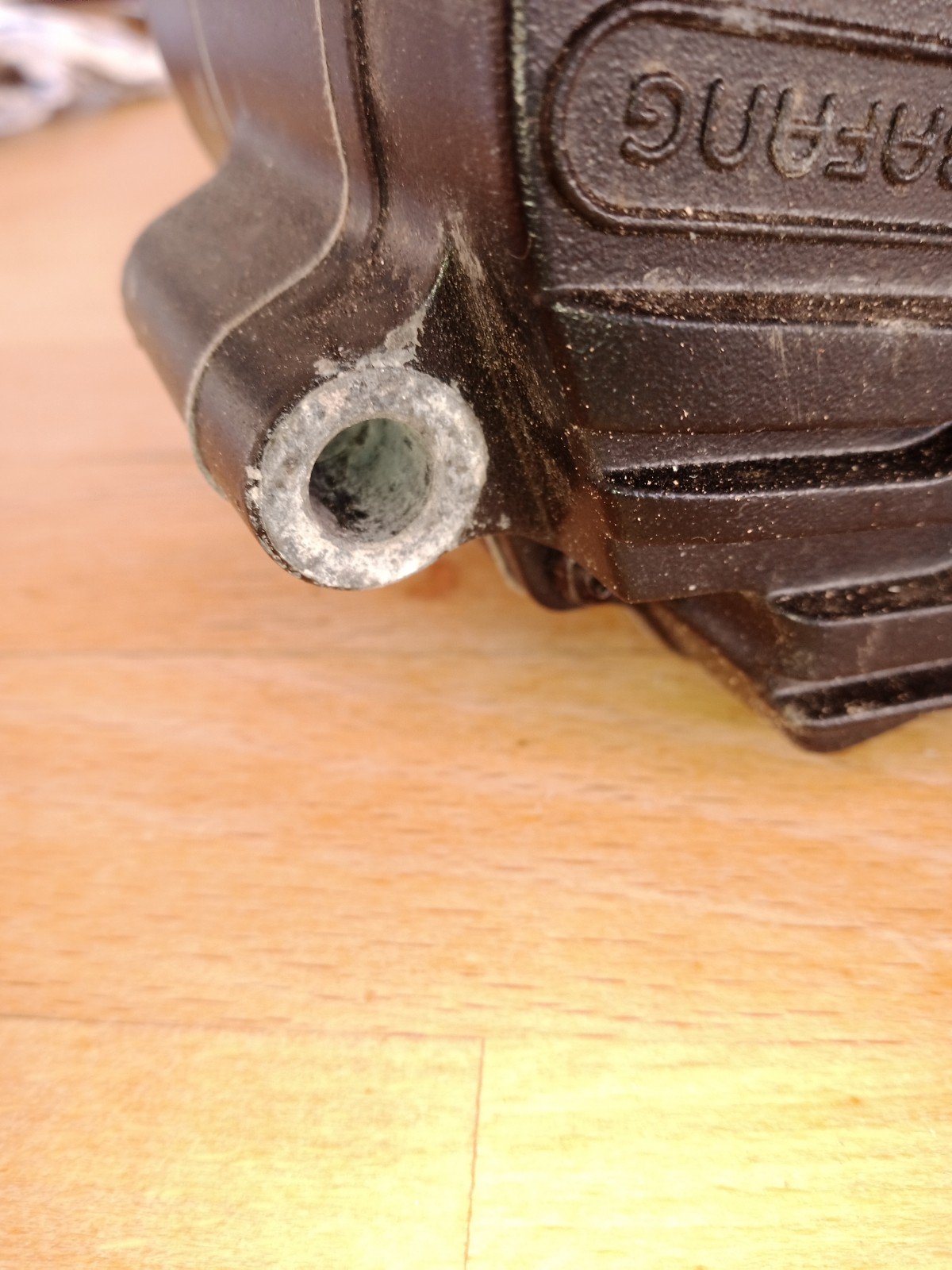

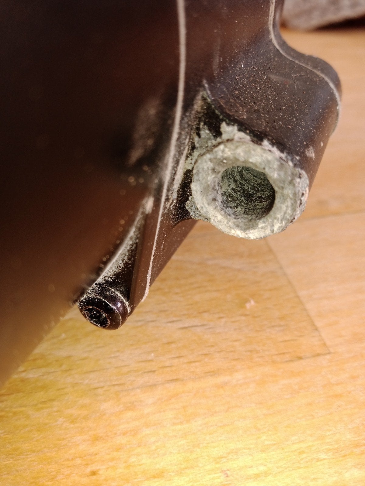

Wouldnt be worry much about corrosion. It wont eat up material any soon.
Use the lube on bolts and around the bolts and ride. ;))
