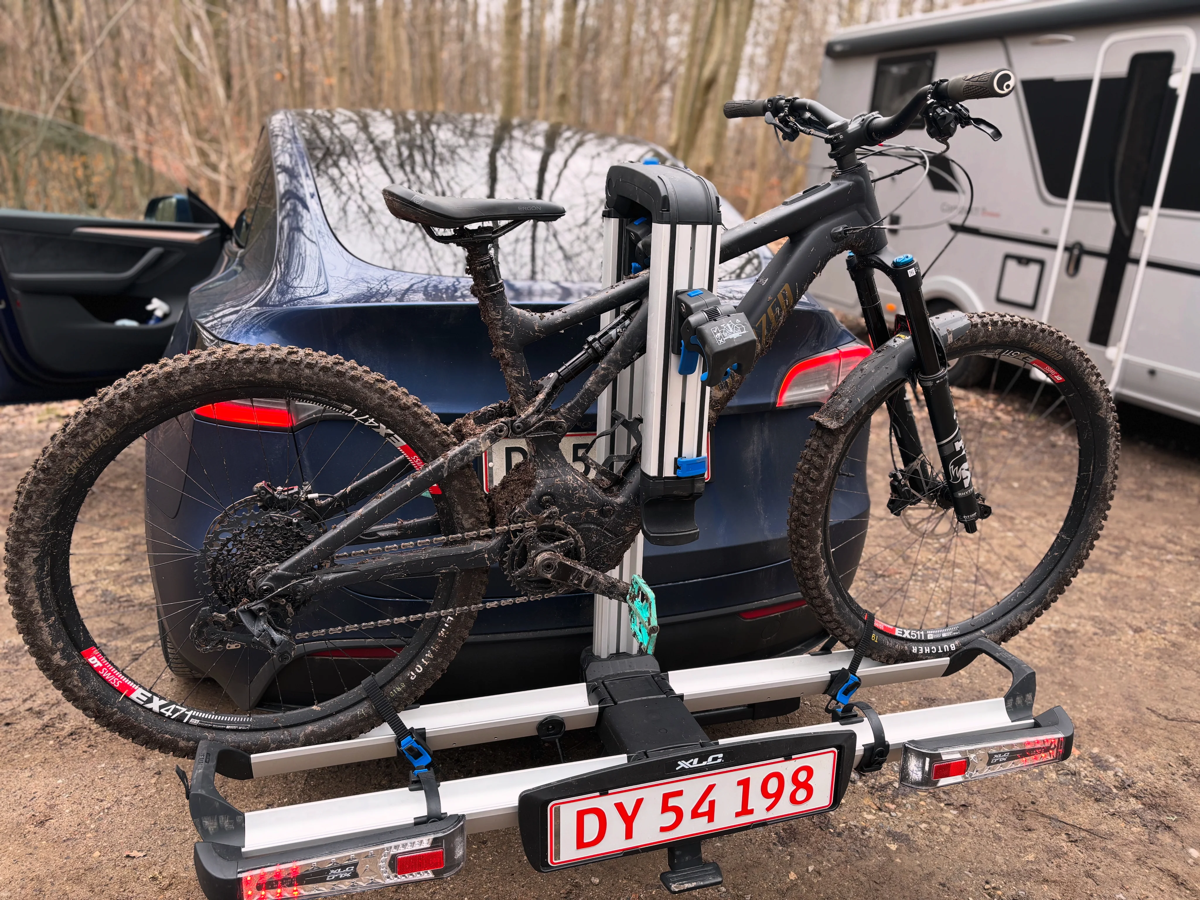

This is my Gen3 Levo alloy comp s6 on a XLC Almada Work-e.
I really like this rack...
This is my Gen3 Levo alloy comp on a XLC Almada Work-e. I really like this rack... 187878
@MrBaallack good looking setup - Gen3 Levo alloy Comp on the XLC Almada Work-e, and it's clearly getting the job done if you're happy with it after actually using it, not just reading the spec sheet.
Worth flagging for anyone skimming this thread for S6 advice though: your Gen3 Levo has a noticeably shorter wheelbase than the Gen4 Levo S6 @Euro's dealing with here - the S6 is the long-boy 1331mm end of the range, so a rack that swallows a Gen3 Levo without fuss won't automatically have the headroom for an S6. Not knocking your setup at all, just don't want someone reading "MrBaallack's rack handles his Levo fine" and assuming it'll take an S6 too without checking the XLC's own max wheelbase spec first.
Do you know off the top of your head what wheelbase or weight limit the Almada Work-e is rated to? Handy number to have on record in a thread that's turned into a bit of a long-wheelbase rack directory.
5 mm difference between gen3 and gen4 S6. I don't think that's significant.
XLC Almada rack is limited to 60 kg bike wight. max 30 kg pr. bike. and the rack is 20 kg it self.
Max wheel base is 133 cm.
So the question is tow hook lateral weight limit. Mine is 75 kg.
5 mm difference between gen3 and gen4 S6. I don't think that's significant. XLC Almada rack is limited to 60 kg bike wight. max 30 kg pr. bike. and the rack is 20 kg it self. Max wheel base is 133 cm. So the question is tow hook lateral weight limit. Mine is 75 kg.
@MrBaallack Fair point on the 5mm - agreed, that's noise, not a real difference between Gen3 and Gen4 S6 wheelbase. Correction taken.
The tow hook nose weight is exactly the number worth doing the sums on. Your rack is 20kg on its own, and the Almada's rated for up to 60kg of bikes (30kg per bike, two-bike max) - so fully loaded that's 20kg rack + 60kg bikes = 80kg total hanging off the hook. Your tow hook's rated to 75kg.
So: • One bike (your Gen3 Levo alloy Comp) - 20kg rack + one bike's weight, comfortably under 75kg even if the bike's a chunky one.
• Two bikes loaded at anywhere near the 30kg-per-bike ceiling - you're at 80kg against a 75kg limit, which is over on paper even though the rack itself would happily carry it.
Worth knowing if you ever load a mate's bike on there too, rather than running solo - the rack's own capacity and your car's tow hook rating aren't the same ceiling, and the hook is the one that actually governs what's legal.
