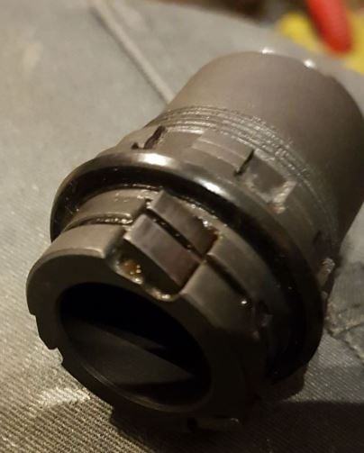

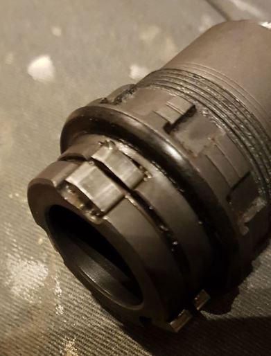

Had a great ride at Cannock on Sunday only to find last night that the wheel bearing had seized / become very stiff in the rear hub. On stripping down the rear hub I also found that one of the pawls within the freehub has sheared and so is only latching on 2 pawls, images below show good and bad. Bike is just over a year old, I hope things are going to start failing now!!!!
Ordered a new wheel bearing and freehub kit from Specialized, I think I might start saving and look at investing in some new Hope wheels.
Bad bit
Good bit

Hope hubs use 4off pawls so the loading on each one will be a little less than the 3off on this one - or currently down to 2off ?

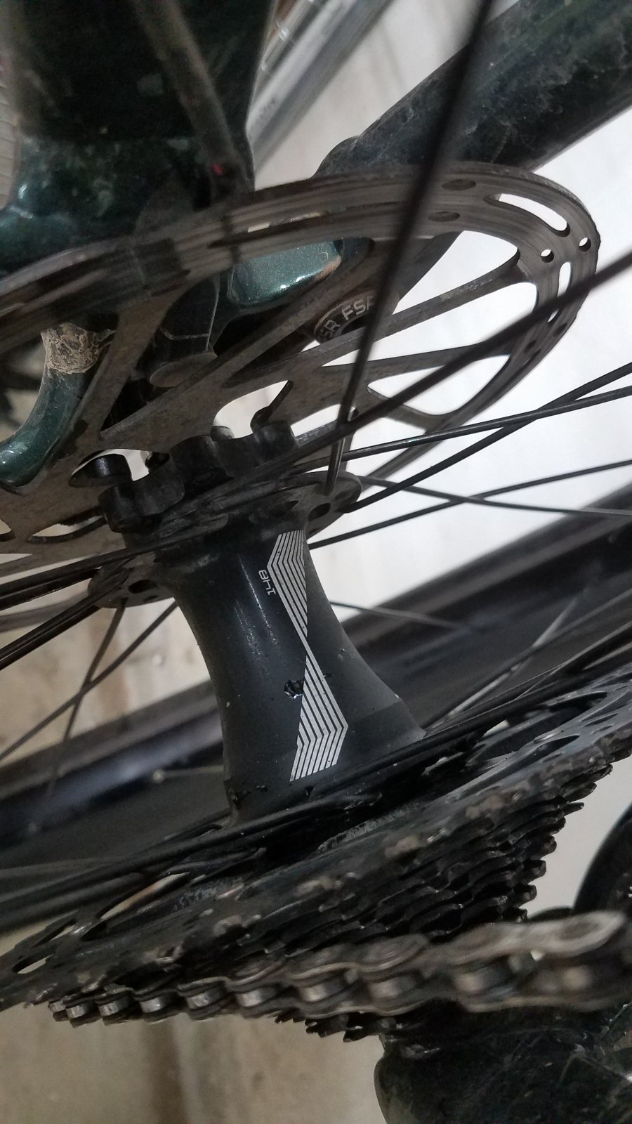

Broke a pawl on my 2017 Levo Comp. Anyone know where to get parts or what freewheel assembly I need? Lbs wants $50 plus install to put a new one in, and all I really need is a pawl that 'should' be sold separately for a couple bucks....
The only markings on the hub are a bunch of lines and 148mm

Okay, I received the DT Swiss pawl kit, and while the pawls are not 'exactly' the same, they are very similar and do fit in the hub well. I wasn't able to use the new spring as it was too short, but the original spring is still good. I replaced all 3 pawls with the new ones, greased it all up really well with the included grease and went for a ride, it's smooth and seems to work fine...time will tell, but since the hub would have been garbage anyway, for $10 we'll see how long it lasts....but I see no reason for it to be any worse than the original pawls, so I think it will be just fine!!
