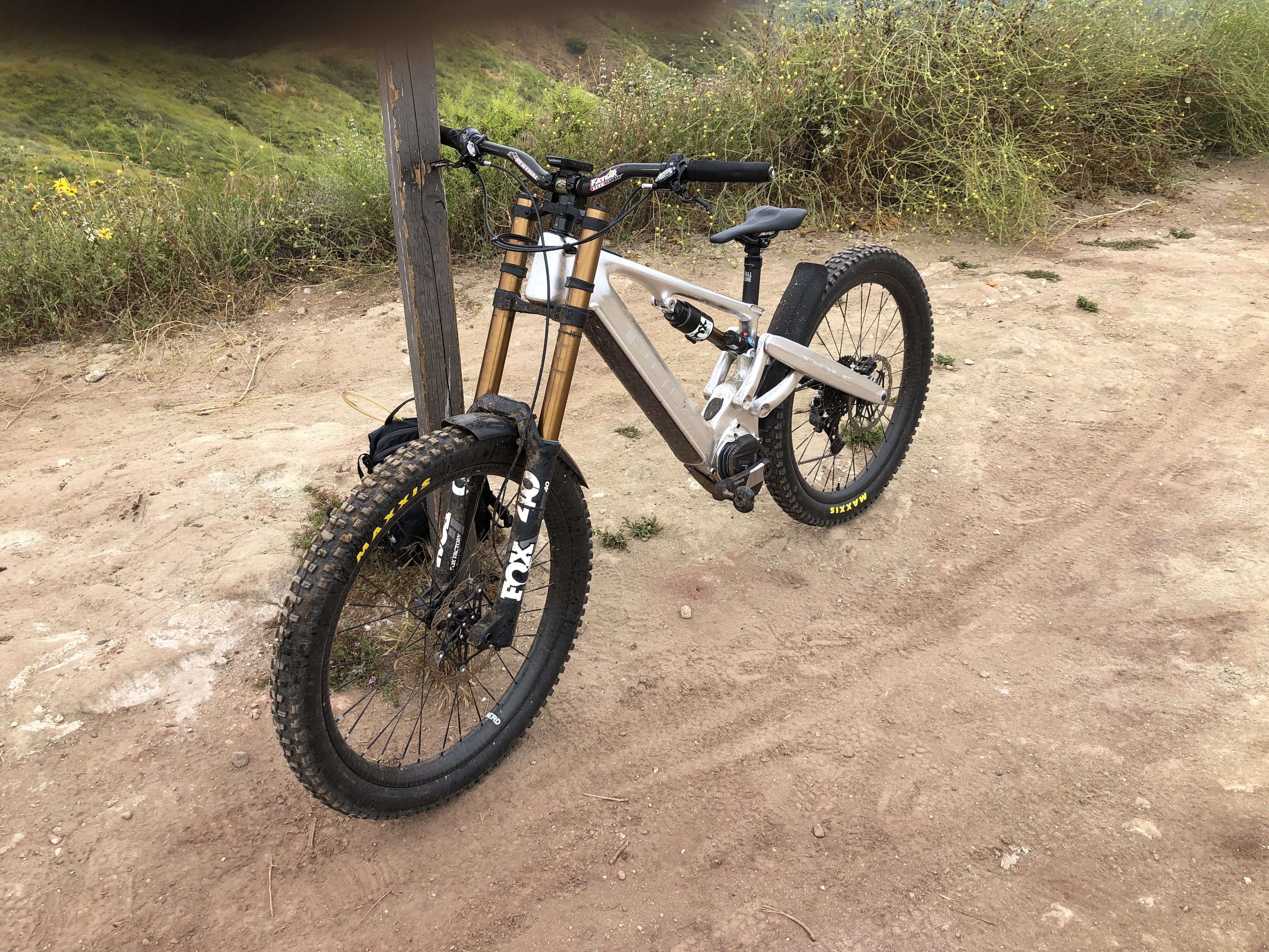

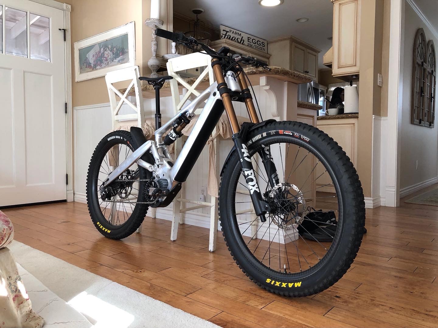

Monday pulled the trigger on a Pivot shuttle AM Ride with 2 29's. I rode my buddies 29 er Sat a bit and it felt fine with the dropper down and positioned in attack posture
I'm 5' 11" and ride the same bike as you. This is my first full 29" bike. Previously I was on a mulleted Santa Cruz Heckler. The Shuttle AM jumps, whips, and carves FAR better than the Heckler. The AM is easily the best handling bike I've ever owned, so although I might be a little curious about the mullet, I'm going to leave it exactly the way it is.
Although the bike is spec'ed with a 170mm dropper, I put a 200mm on it. The seat tube is plenty accommodating, and the saddle drops far enough that I can routinely just push the bike out in front without catching it on my low-hanging manliness. 🍒🍆
My recommendation is to ride the bike a bit with the 29er out back, and make sure you have ample clearance when the saddle is slammed.

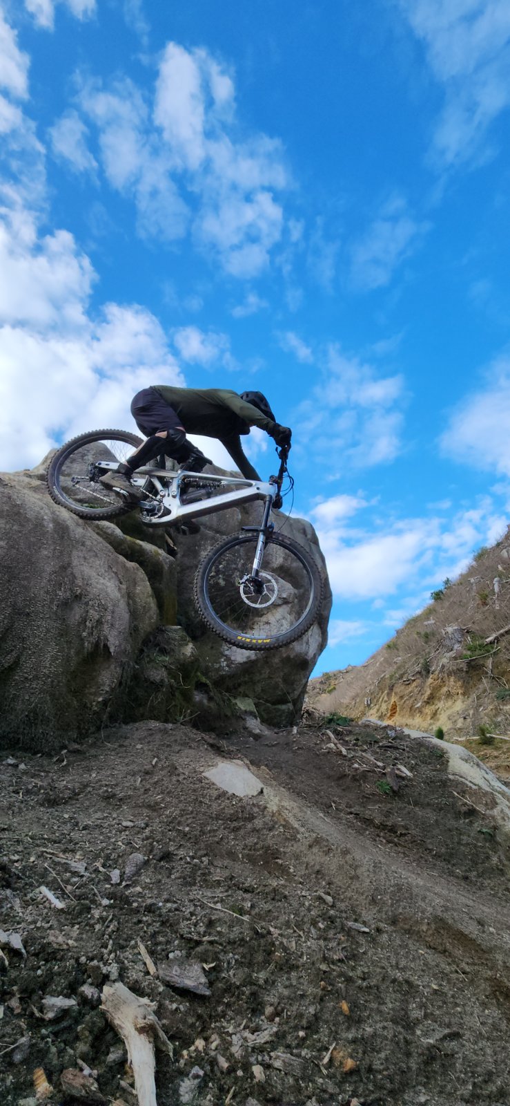

5'11 and mulley all the way.
29 wheel gets in the way on slow steep decents when you have to get your arse back. It can also get in the way manuevering in the air jumping.
Short people should look at mullet for sure and average height people if they chase the steep slow tech and like jumping.
For people not riding the steep tech then not so much.

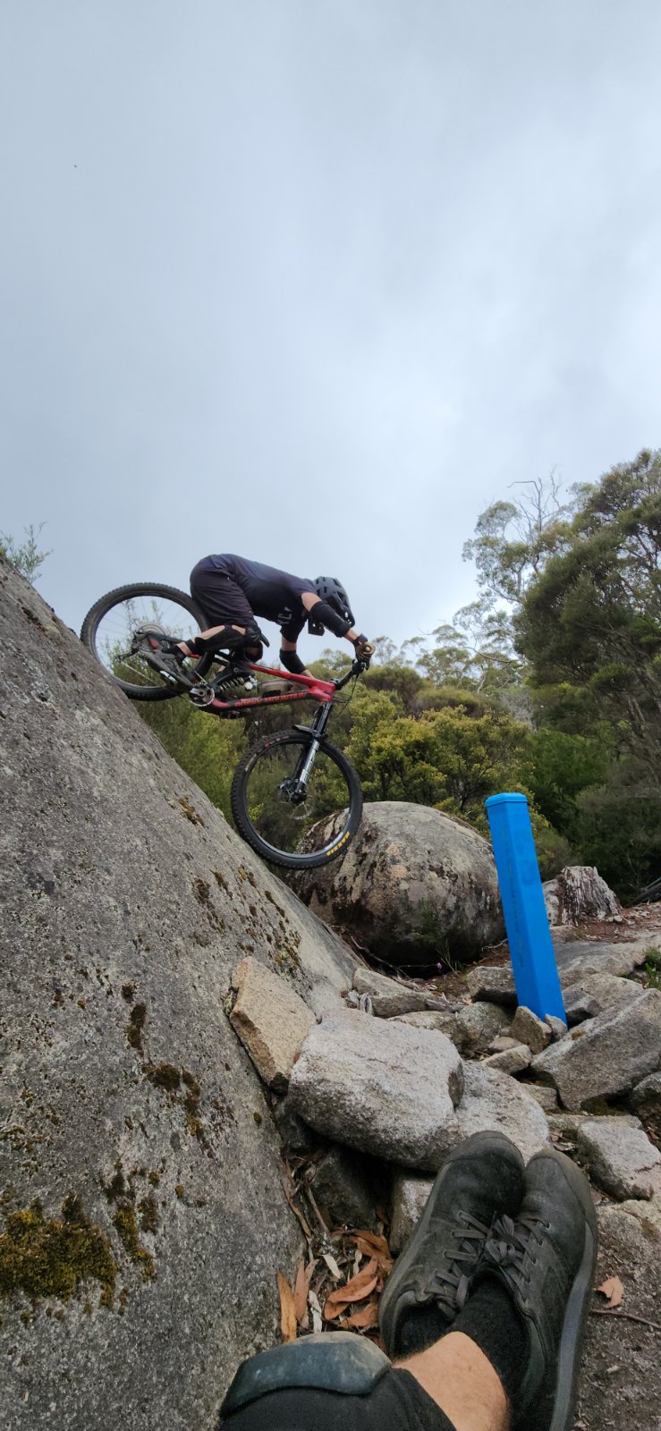

C'mon Plummet, those pics are all repositioned 90 degrees. I've been there. That blue post is sticking out of a rock wall, not coming out of the ground. :ROFLMAO:
But seriously, what is that second bike...the gray looking one?
