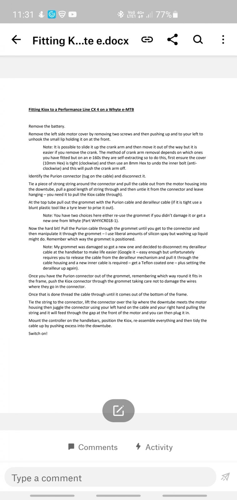

I've fitted a Kiox to an e-160s. Connecting to the motor is the easy bit, the hardest is getting the old and new connectors through the downtube grommet. I've typed up a guide, I'll send it to you or put it on here.

@casian let me know if you can read this okay, if not message me your email address and I'll send it to you.

Many thanks Wilko. Yes I can read it. This will be really helpful. I see what you mean about the grommets. The bike turned up about an hour ago. Said to the wife ' I must wipe it all over with anti bacterial wipes!!

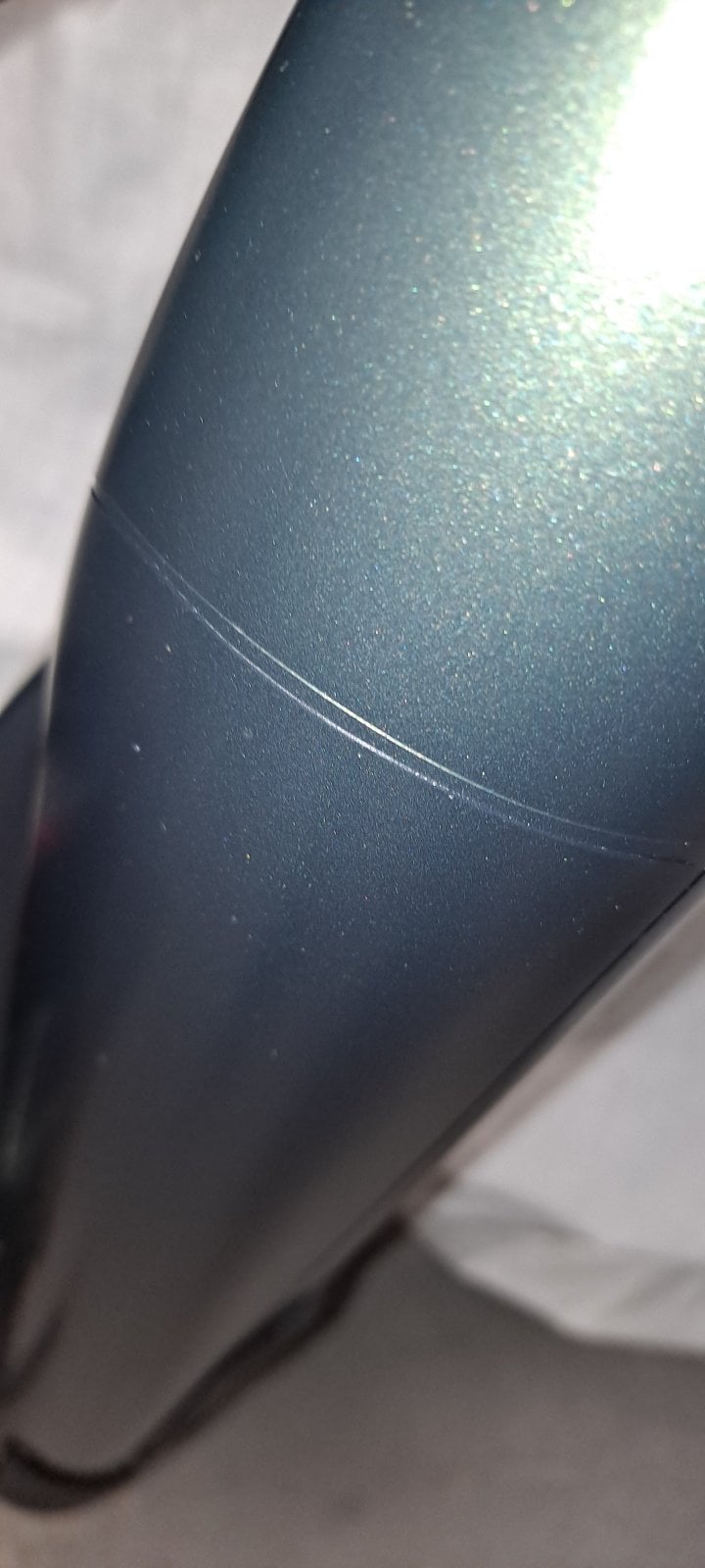

One thing I noticed was that the frame appears to have some type of invisishield on it, was yours the same?

If you can feel ridges and it's in parts then it looks like it has had Invisframe (or similar) installed which is not standard and either your lbs has given it to you as part of the package or give paid extra for it (about £80 to buy as a kit and £120 ish fully installed).

Yes definitely a clear film and very well done.

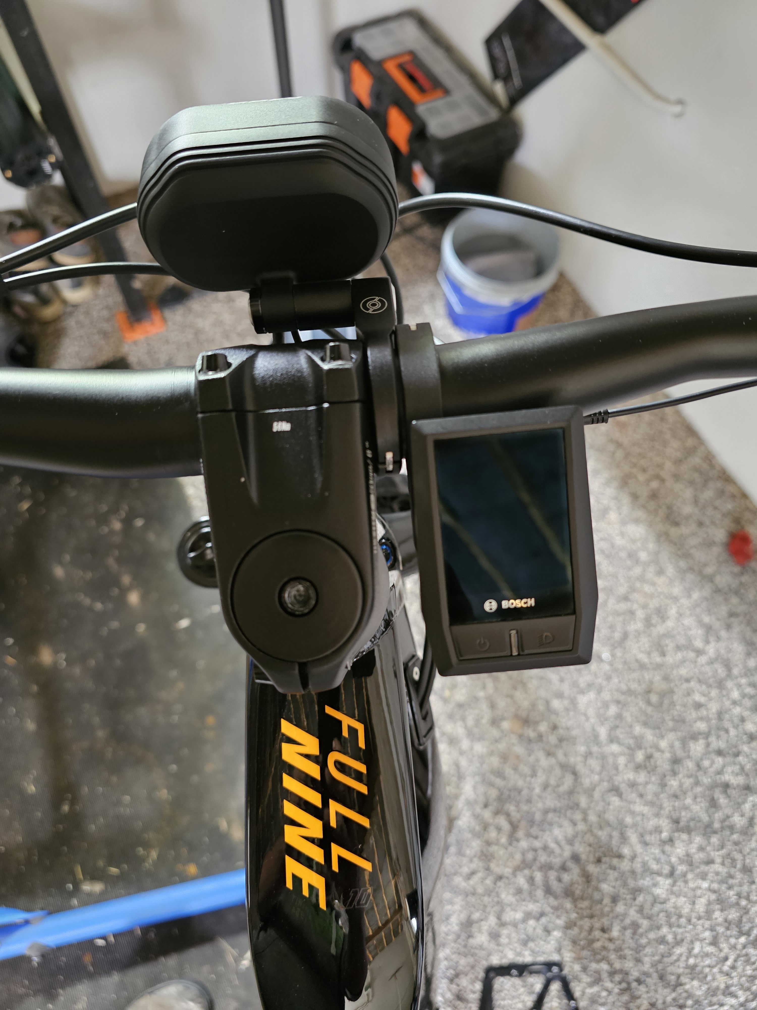

Does anyone have photos of their Kiox fitted? Interested to see how it looks and where people have put them.

View attachment 113907 removed my stem mount and fitted a ktm mount
Do you prefer it there to the stem? I thought I'd prefer it there, but now I'm not so sure.
There seem to be some top tube options, but the one I've just seen looks like a badly 3d printed part.
