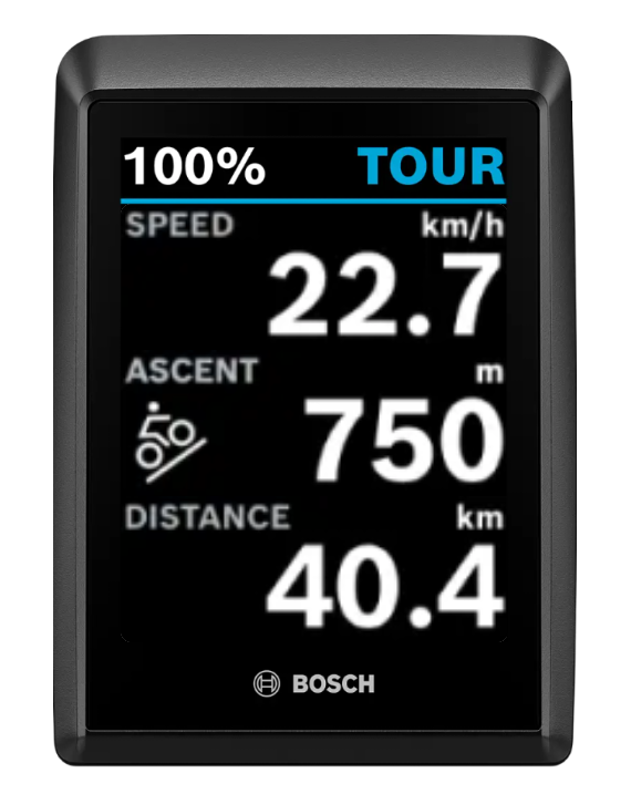

Pretty cool huh. Took me a couple of rides to work out what I wanted , settled on this as my main screen.
The altitude started working with this update too , which made my Garmin pretty much obsolete , so it's for sale

😁 View attachment 122858
Nice, I havent had a full play around with mine yet but what I'd like..
Clock, on top line as don't need batt % with LED remote, Speed, distance and cadence would be nice.
