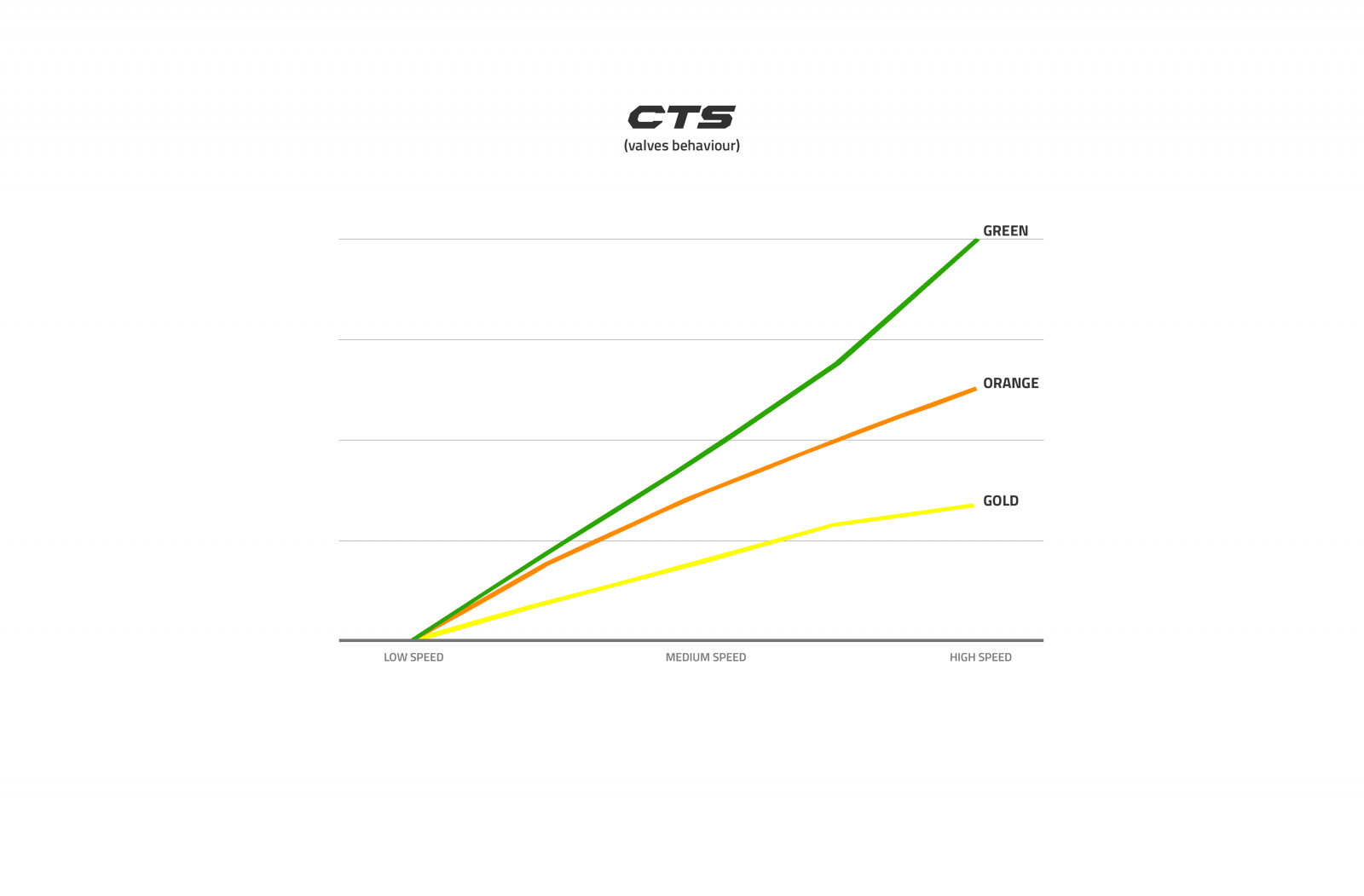

I've never heard of them! Dig the purple coil though. I cannot make sense of this chart of theirs, but I like the idea of the semi-custom tunability.
A Y-axis label would be nice. I would assume it's a damping graph but I'd want the curve to look the opposite if it's damping force. i.e. more damping for low speed (pedaling, brake-dive, g-outs, popping off berms) and less damping for high-speed impacts like square-edge hits, roots, rocks, etc. where I want the travel of the shock to suck up the impact and dissipate force.

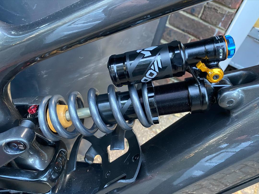

Having had the shock sat in my garage for a few months, I finally got round to fitting it. First ride out...wow, transformed the bike. The X2 isn't a bad shock, but the MOD is in a different league! The bike feels so planted and the travel feels bottomless. Its super plush and even on a heavy case it just absorbed it without complaint with no harsh bottoming. I'm currently running it with the middle CTS and a 550 spring, I'll swap it out for the firmer compression when I next go to the bike park.
