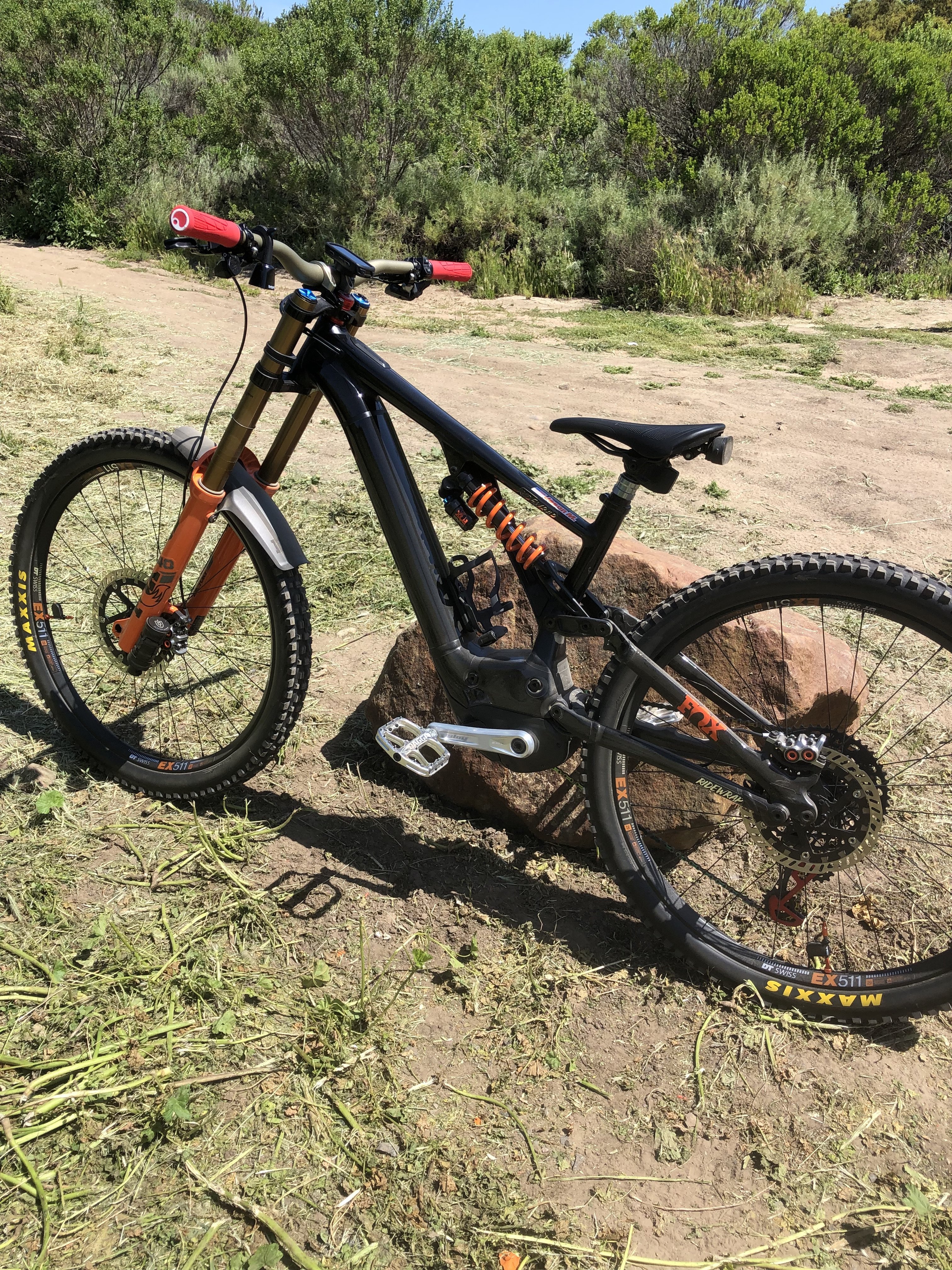

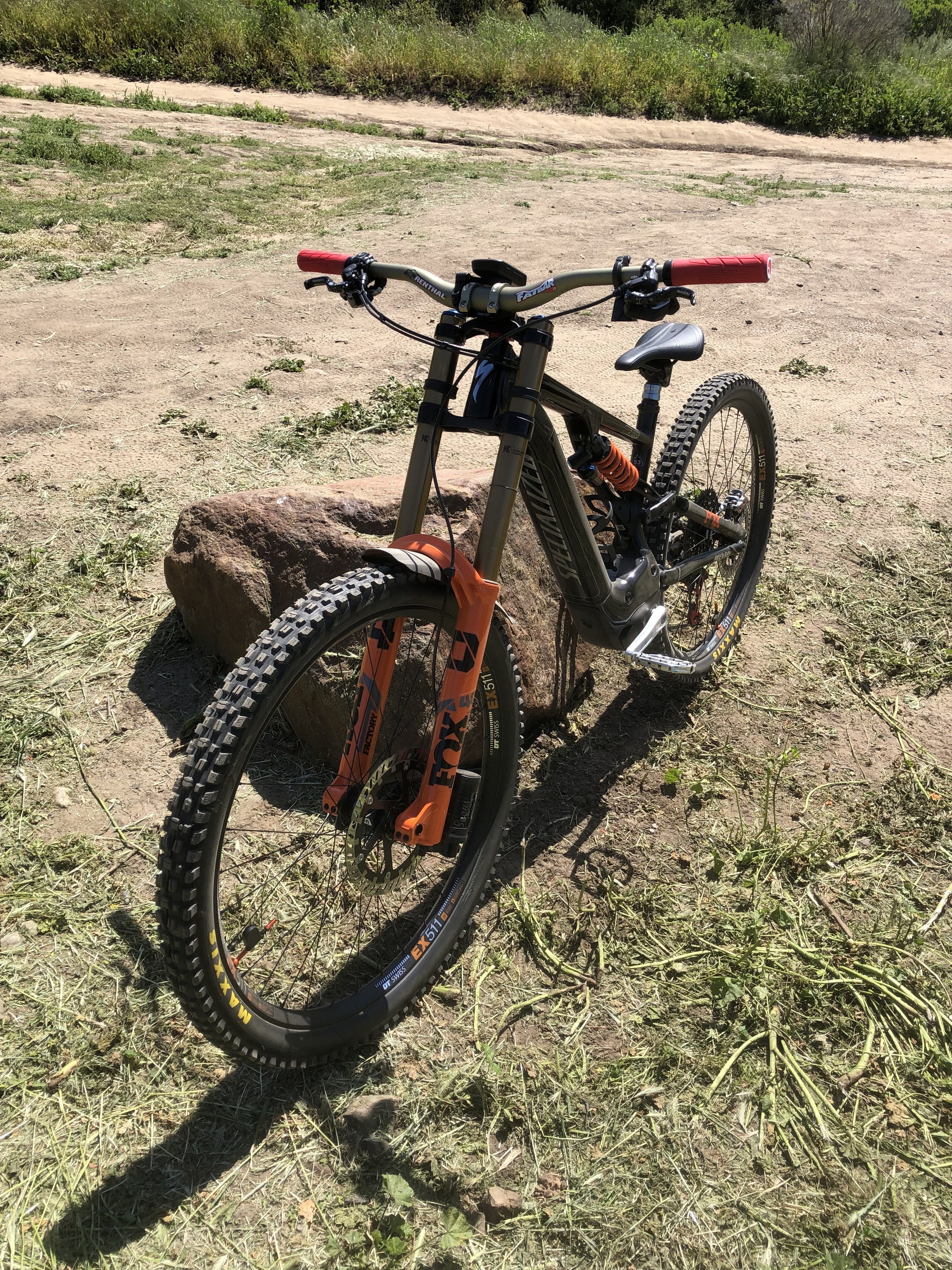

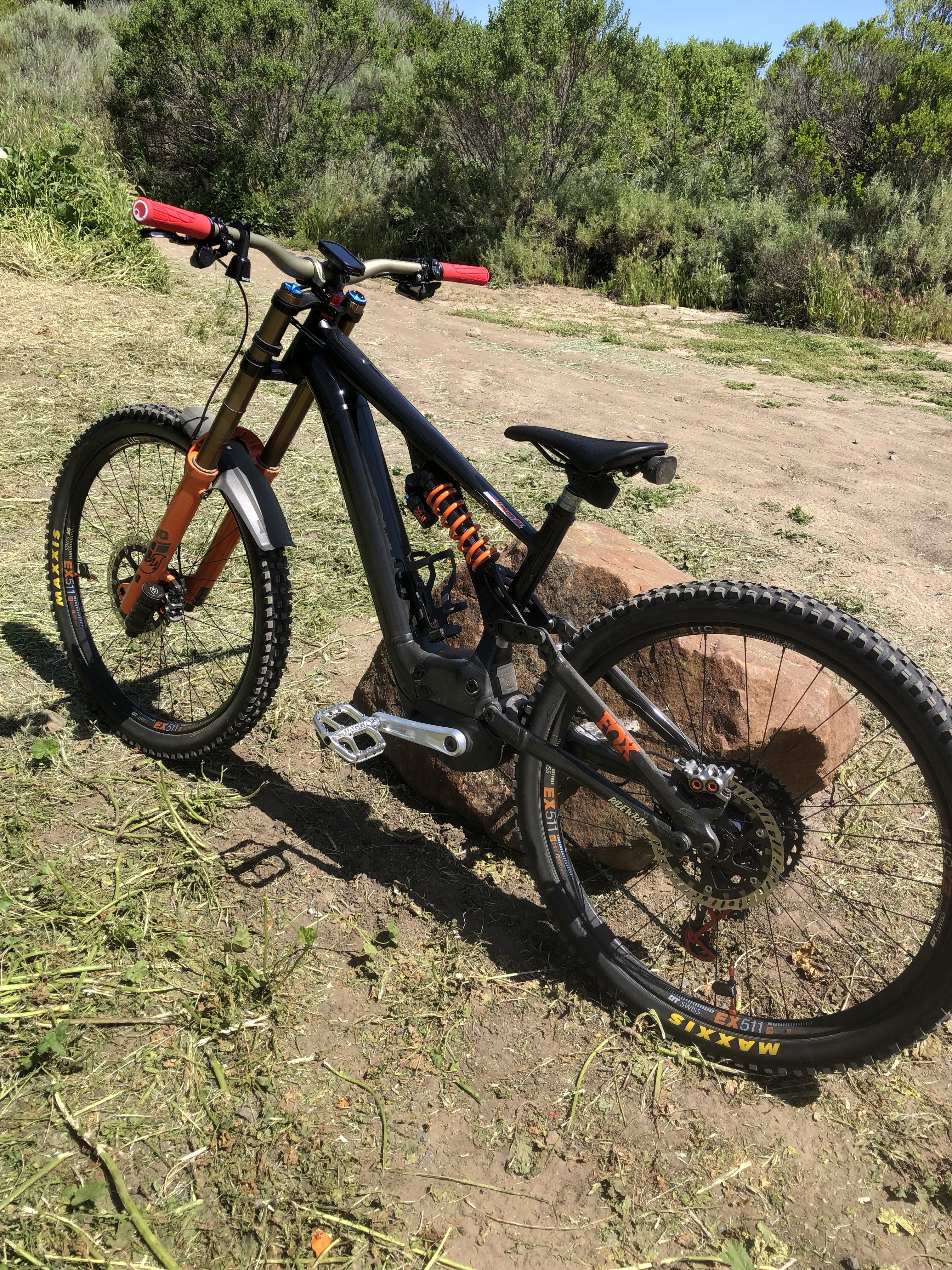

The thing about the kenevo is you can install a single or dual crown, full 27.5 or 29er and still have a long travel bike. Levo mullet ( if thats your thing or geo adjustment ) still limited to a 150/160 maybe adding cascade links to gain more travel . Dual crowns tracks better when riding chunder than any single crown forks. I currently have a Fox 40 and it breaks neck every time I ride my local trail because dual crown is bad to the bones :)
View attachment 111353 View attachment 111354 View attachment 111355
Totally agree. Why anyone would swap out the dual crown for a wobbly, flexy, creaky csu single crown fork is beyond me unless they want to do barspins.
The fox40 does allow a better steering lock compared to the boxxer though due to the wider spaced stanchions.
