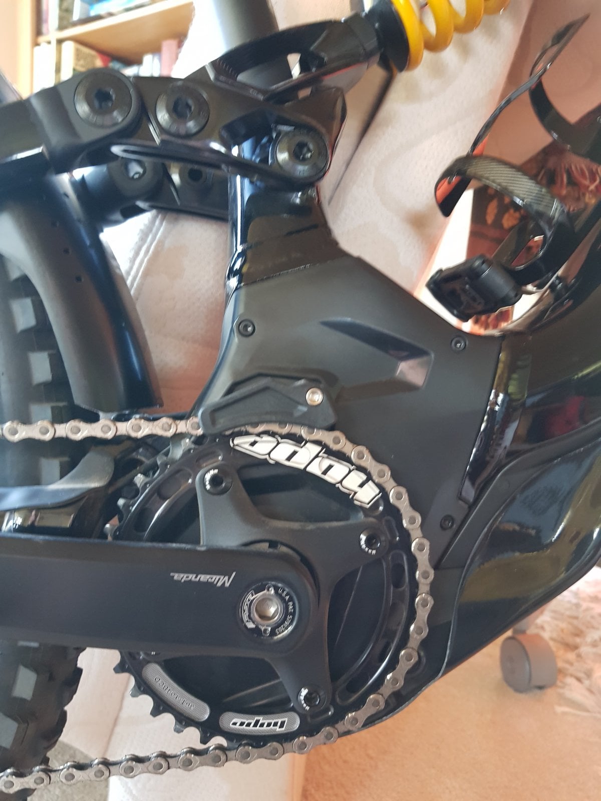

Installed this one and bike so much better.
Wolf Tooth 36T Chainring suddenly I am using a lot of the gear range and bike is gets up to reasonable speed at my comfortable cadence. It will never be a road bike though, but thats not the point. It is a lot more usable on paved flat trails on your way to the fun stuff. (y)

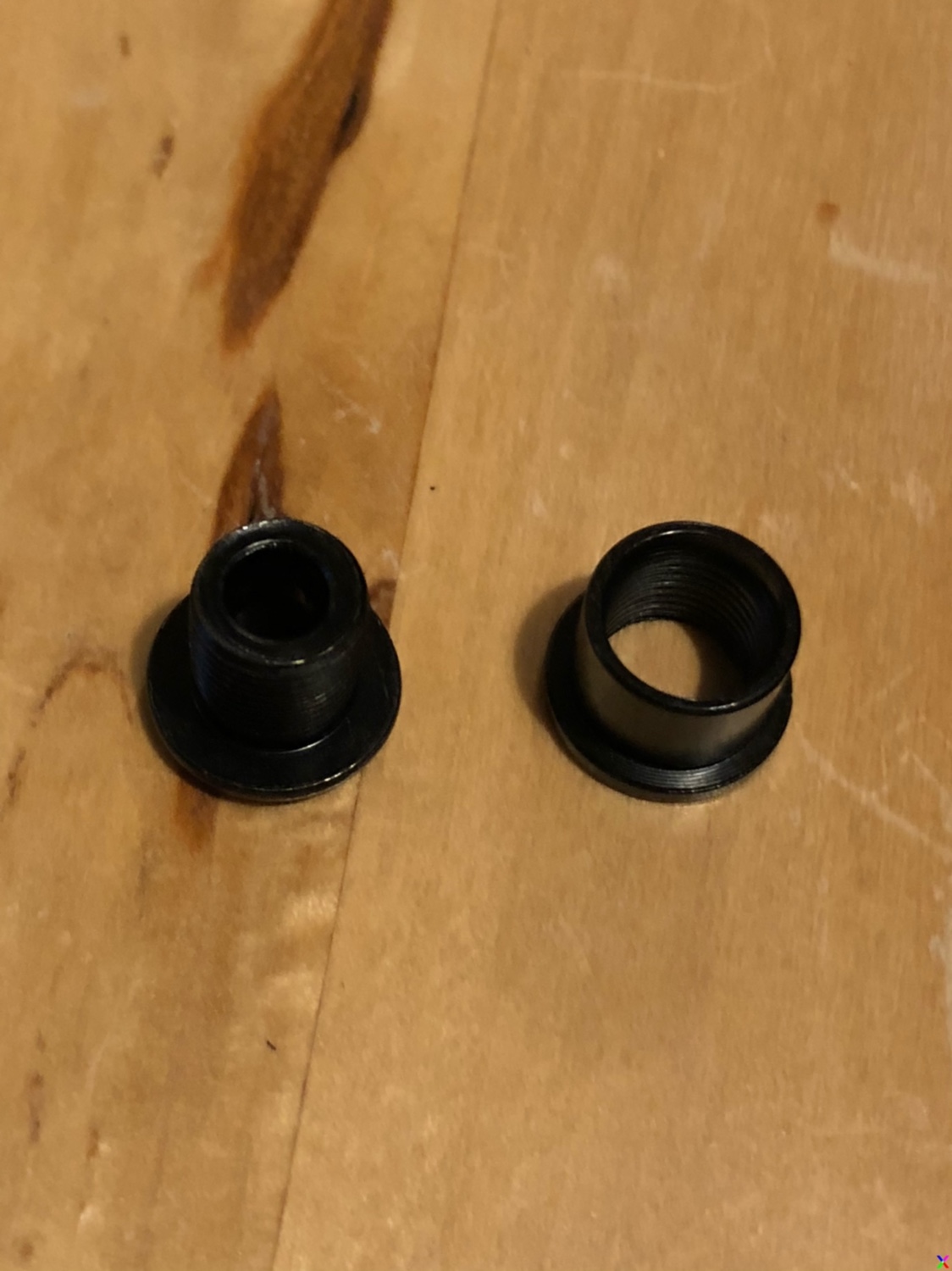

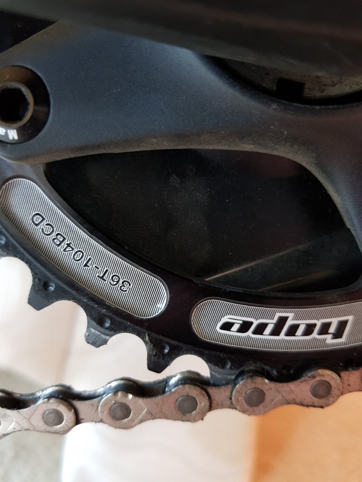

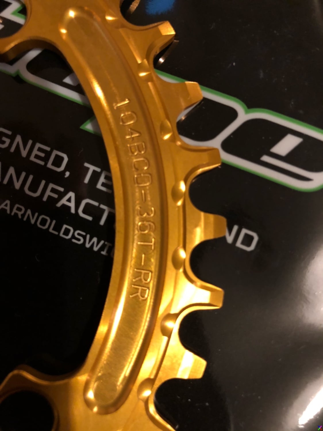

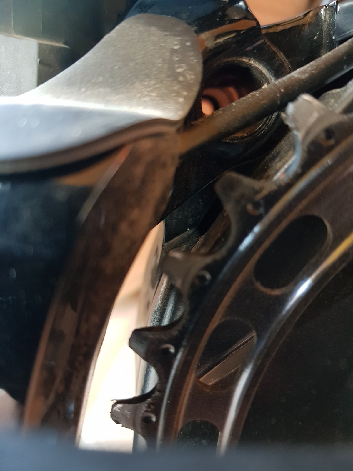

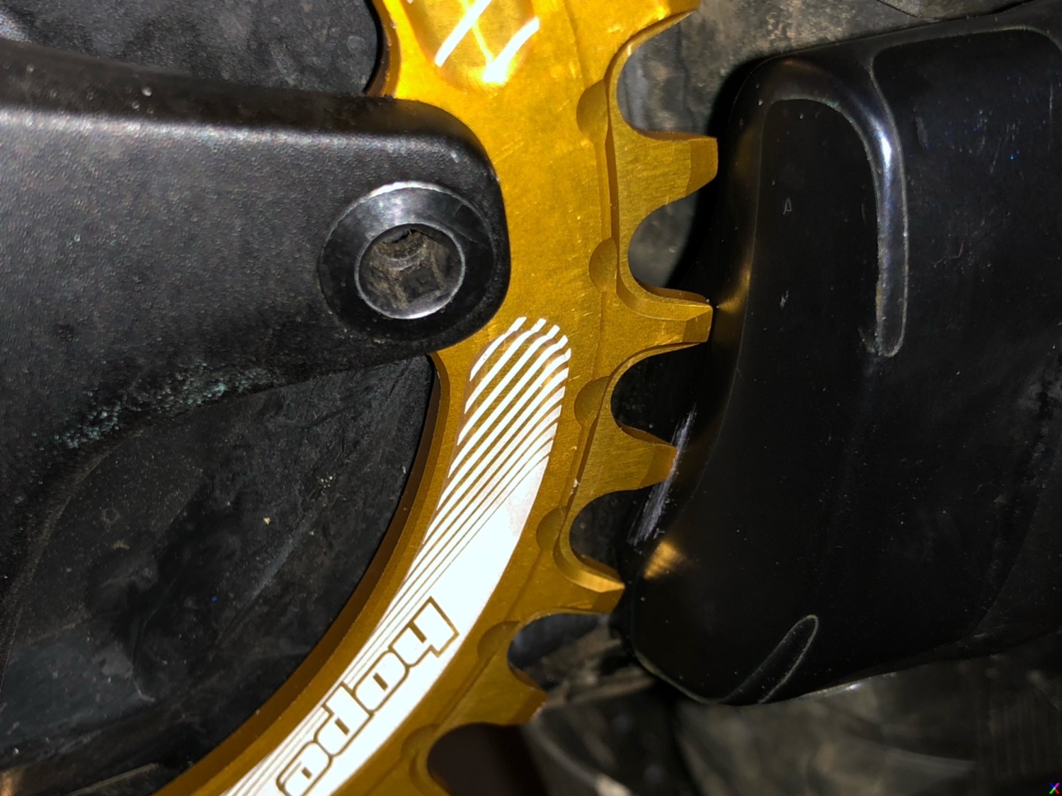

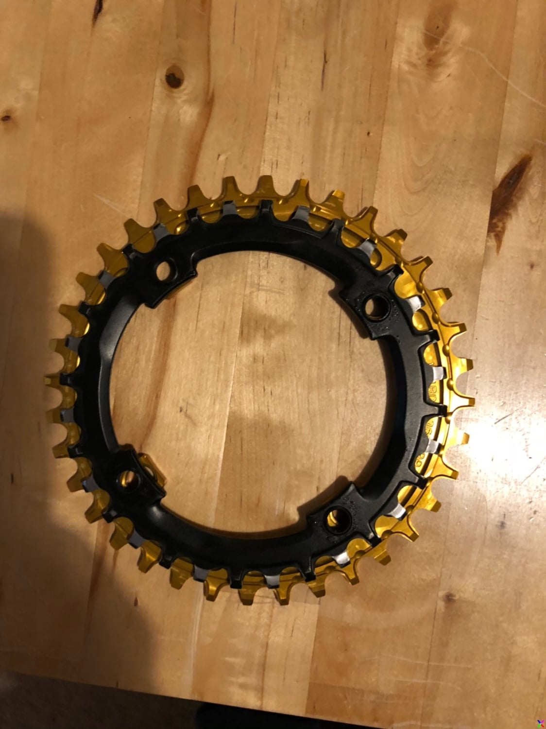

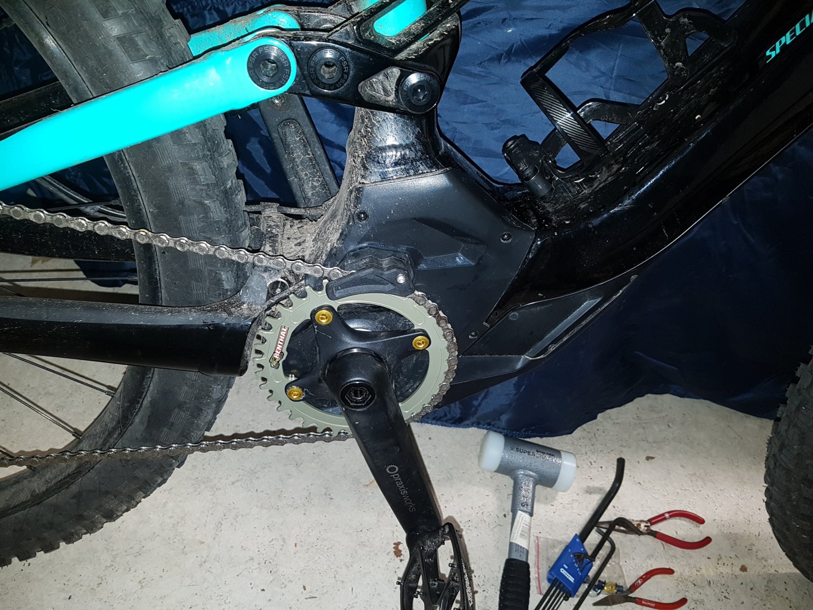

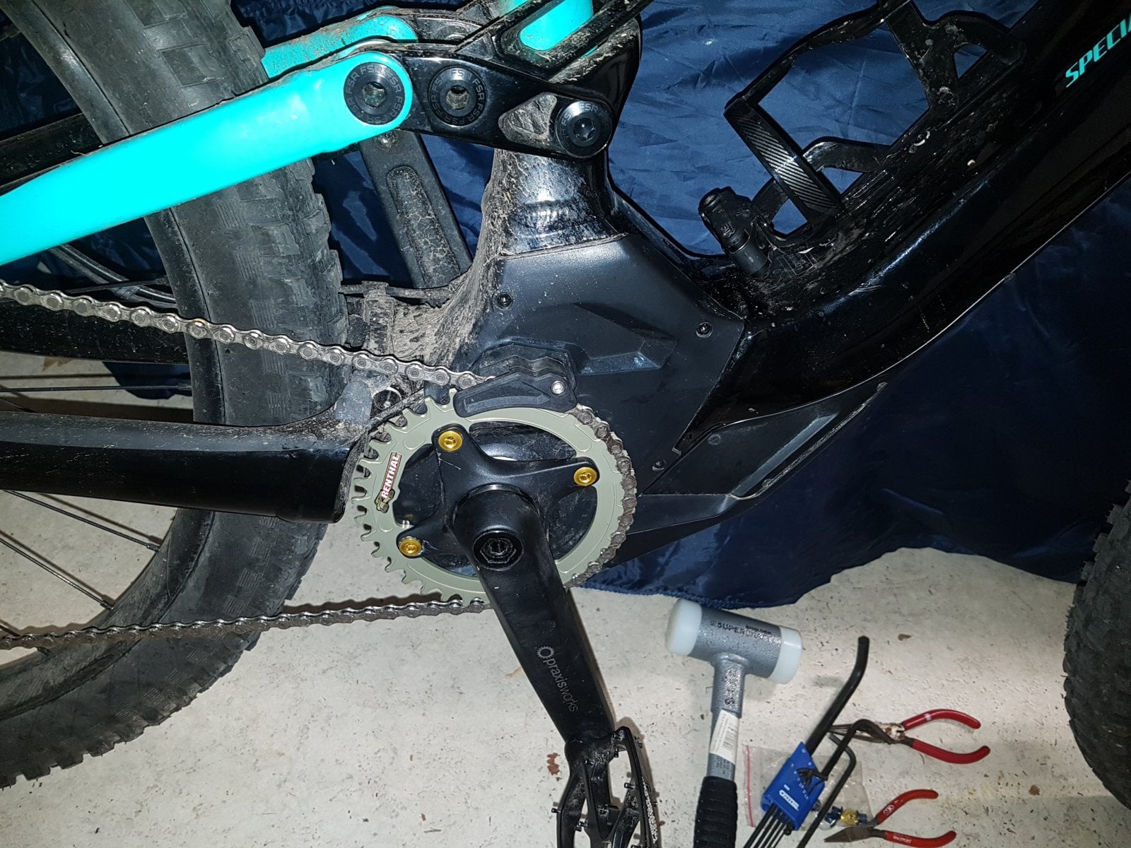

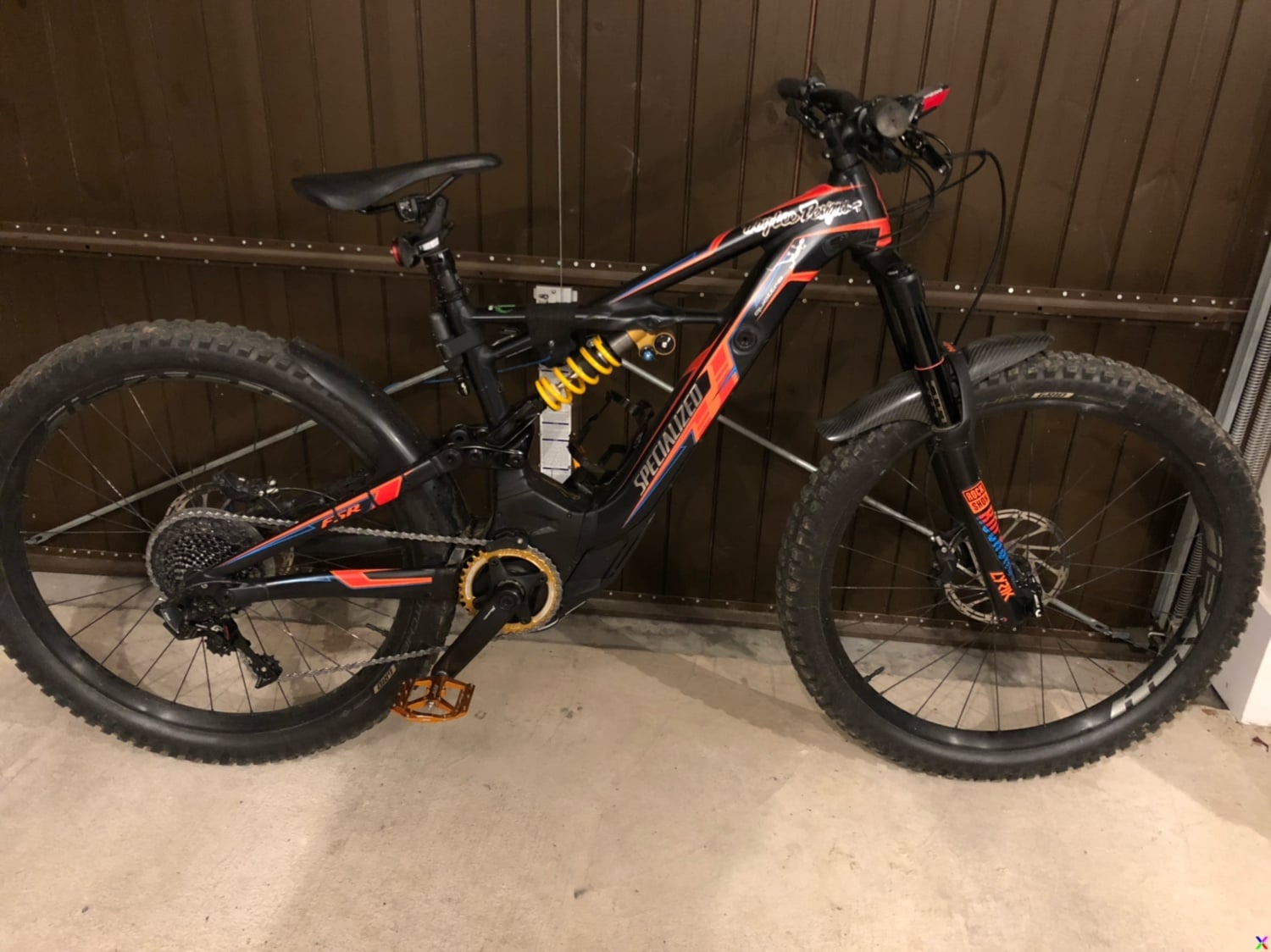

Hi. Installed a Hope 36T 104 Retainer Ring on an ‘ 18 medium Kenevo today. No clearance at all without sag on suspension. So close that it’s probably down to manufacturing variation/ tolerances between brands of chainring and differences in bike bearings. I carefully filed about 0.5mm off each tooth to get a bit of clearance with no sag. Fine with sag on bike. Presume my Mcgyver approach won’t effect the chain retention much.
I also had to file the chain ring retaining nut a bit to shorten to get it to hold the ring. The steel 32T ring is threaded but replacement was not.
Used tape to sick the nut on the back of the ring as others have described. Had the proper tool to lock into the back of the nut in the tight space which helped.

Holly cow thats close! The Wolf Tooth 36T has a comfortable fit on the 2018 Levo, the limiting factor being mainly the chain guide is now at almost its absolute maximum height where you can't go any larger.
