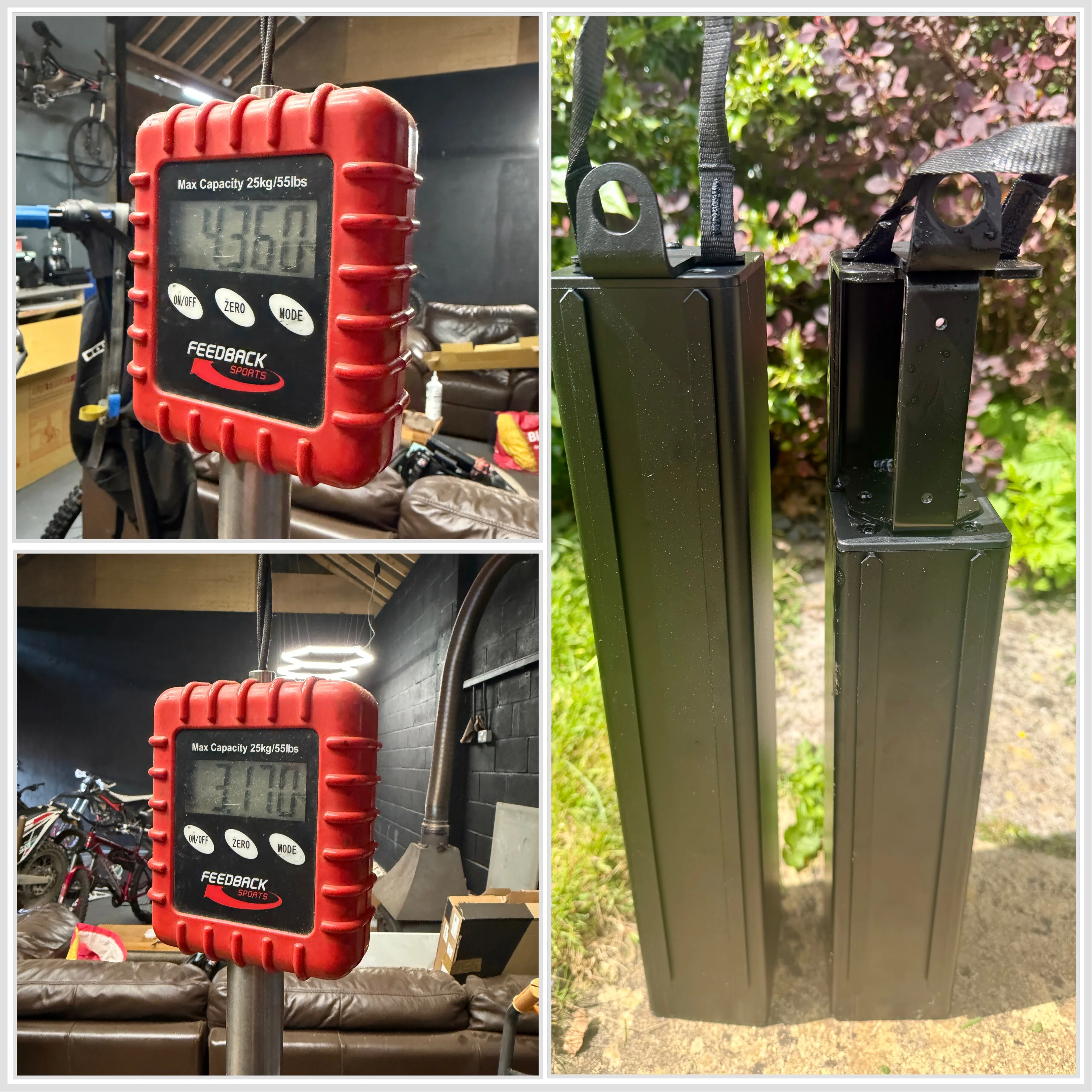

What's the weight difference from the 800W battery?
Sometime I ride only with my range extender battery - agreed, it feels like a completely different bike. But the extender throttles power and its external water bottle mount design is somewhat unseemly
EDIT: Google says it's a 1 kg, 2.2 lb difference; never mind :)
I keep hearing this over and over from those that have tested multiple configurations, that the long skinny (most being the 800wh and larger) batteries have a real dramatic and negative effect on bike handling.

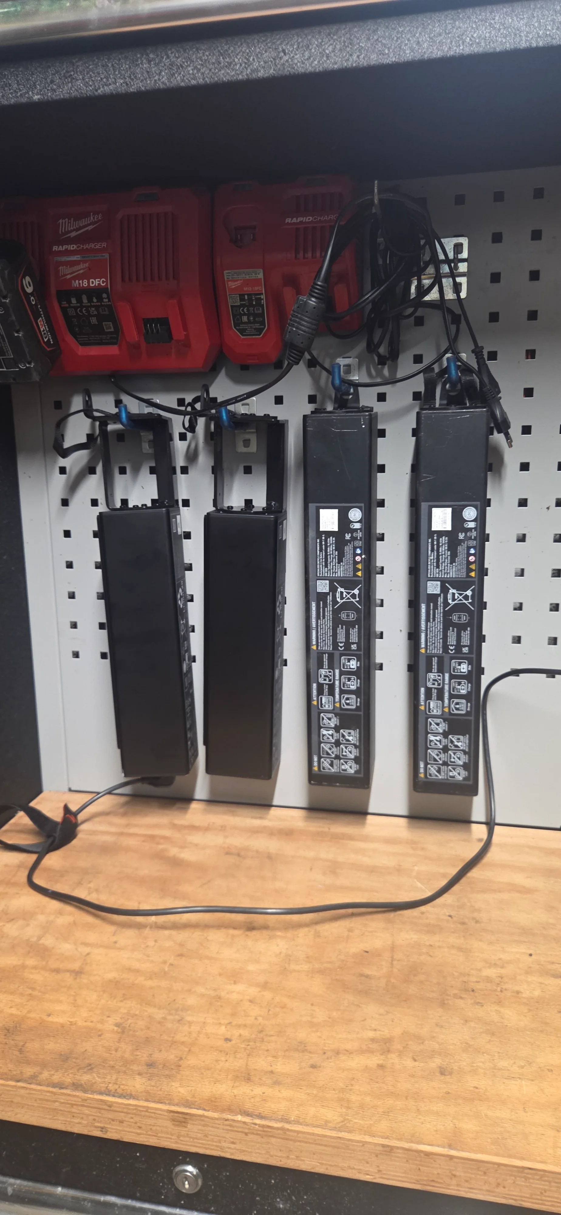

Ordered my propain with the 600wh. Figured a top up during lunch on long days would work just fine. Right now I feel like removable batteries around the 450-500wh size is where its at. Personally if i could get 2500-3500 vert out of a battery in lets say mid power I'm happy. Then just swap it out for a fresh one. That's what I currently do on my Older Marin alpine trail E. Two 504wh batteries last me all day.
Oh yeah, Lighter batteries are where its at.
Imagine if you chopped another kg out of the front? That's where im at when i put my 400wh battery.
I have 400wh and 600wh.......
The 400wh is config is just that much nicer again!
