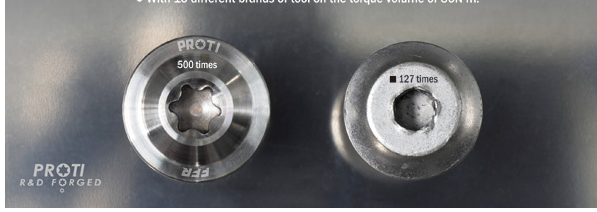

PROti has great options, LOVE their t25 interface and finish quality.
For me, it was less about gram saving and more about finish details. The M4 fasteners for downtube & guards save almost nothing in weight, but they look the part!
Motor bolts needed the heads turned down. and they DONT have the shoulder, so you could turn small washer for that.
The UPPER shock trunnion bolts I kept stock for the tricky reasons you mention.
Love to see how this goes on! Best of luck.
View attachment 100631 View attachment 100630 View attachment 100629
Fyi, I enquired about this with Proti who have a 300 piece minimum! Would you be in if we gathered 20+ folks for the upper shock bolt ?

Have these bults been fatigue and deformation tested so that they dont onform or break ?
Have seen many titanium upgrade bolts that breaks in diffrent ways .
