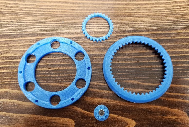

Here is a photo of the parts before assembly:
This prototype had 2 major flaws:
1) The 3 mm magnet was too small to trigger the sensor
2) It required glue in the assembly process as well as gluing it to the rotor. Ok for a prototype, but not good for real-world use. I wanted zero gluing in the final design.

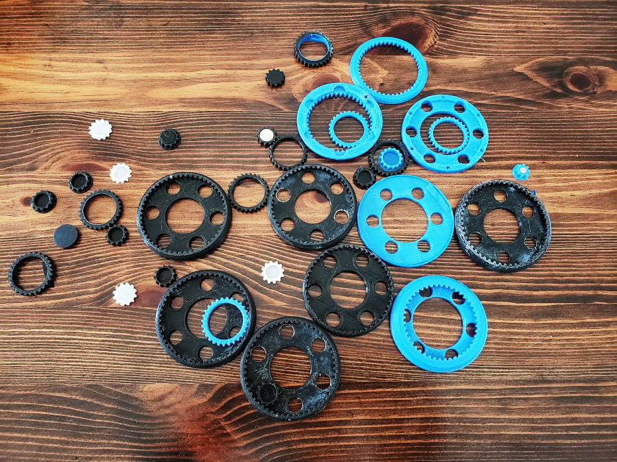

Part III
I realized I needed to go to a 10mm magnet (same diameter as the stock one) but this meant the entire gearset needed to be larger. The problem is there is so little clearance between the disc rotor and frame. You have about 7 mm of clearance in the inner area but once you move the where the sensor is you only have about 4 mm! This was the hardest part about the design. Take a look at the already tight clearance with the small magnet and imagine trying to make it 7 mm bigger:
Here is a small fraction of some of the prototypes (many of them I threw straight in the trash from pure frustration).
I finally had something working with a 10mm x 2mm thick magnet but then found out it wasn't reliably triggering the sensor so I had to move to a 10mm x 3mm thick magnet (which has been rock solid). But that was another 1mm of thickness I had to deal with.
Anyway, I found various ways to make the entire assembly thinner and then had to deal with how to attach the ring gear to the rotor. I went with a retaining ring that grabs onto the rotor with small clips. Once I got the tolerances right it snaps on really nice:

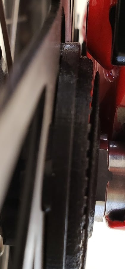

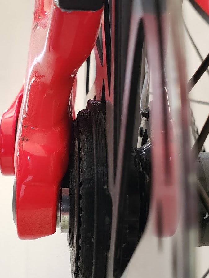

Part IV
I switched my brake rotor bolts to Titanium as the magnet was being attracted to the steel bolts and causing some noise. Throughout the design process I had noise issues where you could hear the gears making faint sounds. Finally I realized I could print the planetary gear in a soft TPU-like material which should quiet things down significantly. It ended up working great and now I cannot hear the gears at all when riding the bike. I think with the latest design the steel bolts would be fine.
The final prototype has a dust cover which also makes it more stealth. In my design the dust cover is slightly short because I still wanted to see the planetary gear so I knew it was working properly.
Final design w/ dust cover:
Final design with dust cover hidden. Note I realized the planetary gear would be kept in place by the magnetic attraction to the steel brake rotor, so that saved on some complexity compared to earlier designs:
A photo of the latest version on my bike:
A few photos showing the tight clearances. I'm right up to the limit in several areas:
Here's a short video showing the gear reduction. Notice the yellow piece of tape on the rotor and the small white gear in the gearbox aligned with it. After 1 rotation of the wheel you can see the planetary gear has only rotated about 2/3 of the way:
Here is a video of it in action:
