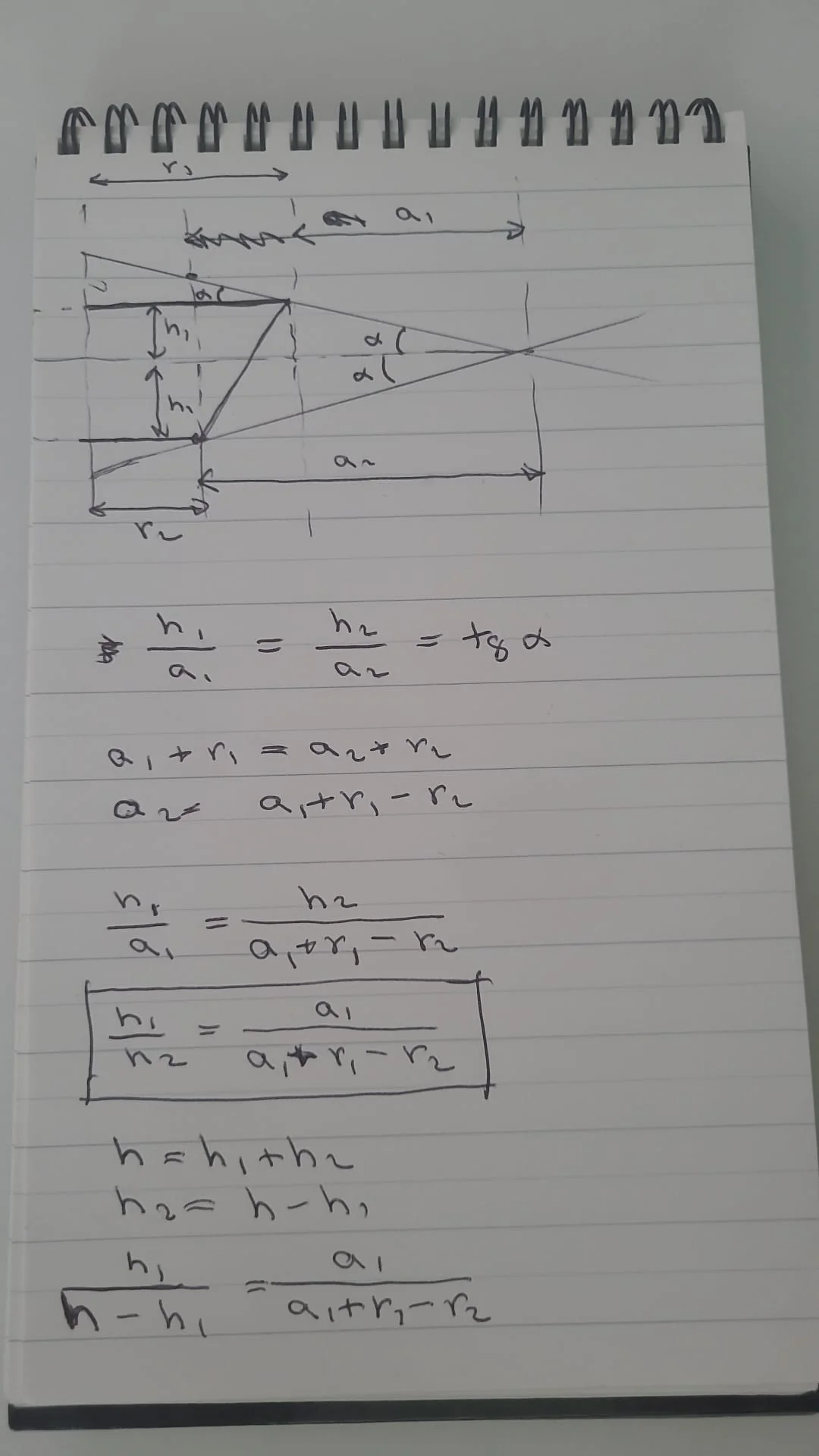

I may be about to say something completely wrong, but since the diameters of the different sprockets are not the same, the chain must be aligned closer to the larger-diameter sprocket than to the smaller one. The geometry of the problem is illustrated in the sketch below:
it must be clearly h1 < h2
The last formula gives you the exact figures based on the geometry of your e-mtb.
My intuition would say same - on larger sprocket not engaged chain is shorter than on smaller sprocket, so bent angle is larger on larger sprocket.
But my measurements with calipers and not super accurate "by eye" measurement show the opposite.

to be honest, although mathematically correct, I am not convinced either that this is the issue. My point is that the distance between the front derailleur is much larger than the difference between the radius of the two sprockets (r2-r1). Therefore, h1/h2 ~ 1.
