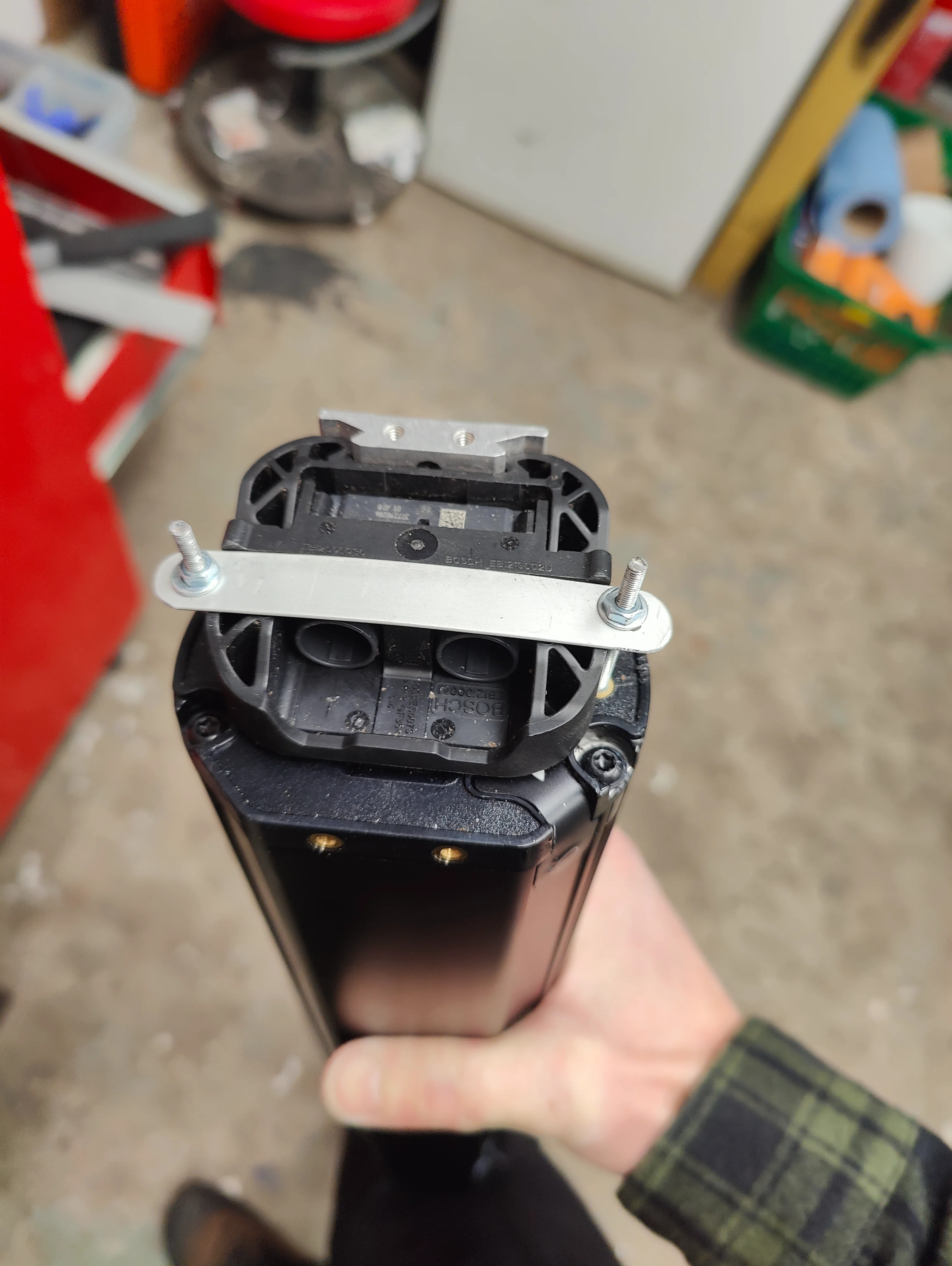

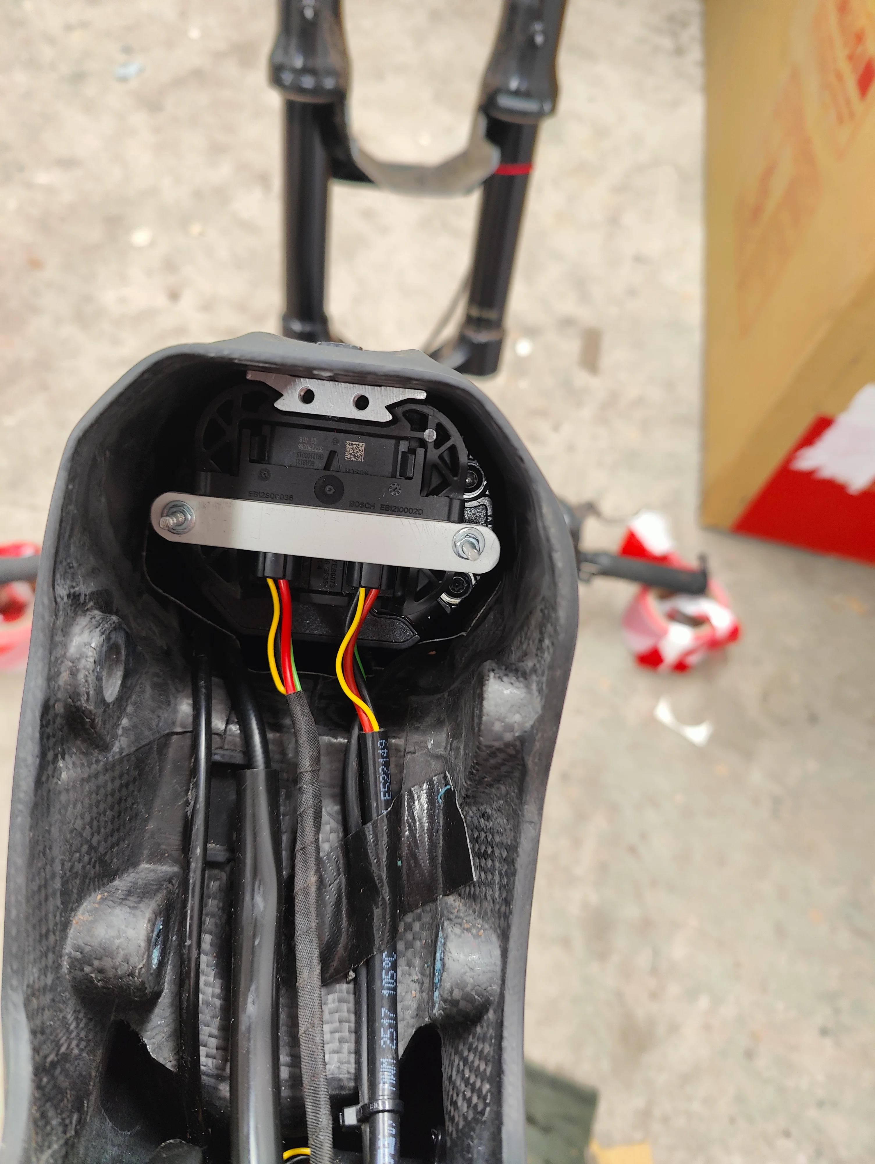

If you look att the connection on the battery you can see that I mounted a bracket over the connection to eliminate the cutout problem. Motor and battery is back in te bike and working great after that modification.
Fair enough, @Lantz, I completely misread that photo. A bracket over the battery connection to keep it secure is a much more elegant solution than what I described, and considerably more practical than removing the motor entirely. I'll take my L on that one.
That's genuinely useful information for Wild owners dealing with the cutout issue. If the battery connector is physically moving under trail vibration, no amount of dielectric grease is going to fix it on its own. A mechanical retention bracket addresses the root cause rather than just treating a symptom. Nice bit of engineering.
Any chance you could share a closer photo of the bracket itself? I suspect @CWildh10 and other Wild owners would appreciate seeing exactly how it's mounted, especially since this seems like a relatively simple preventive mod to do before the problem starts rather than after.

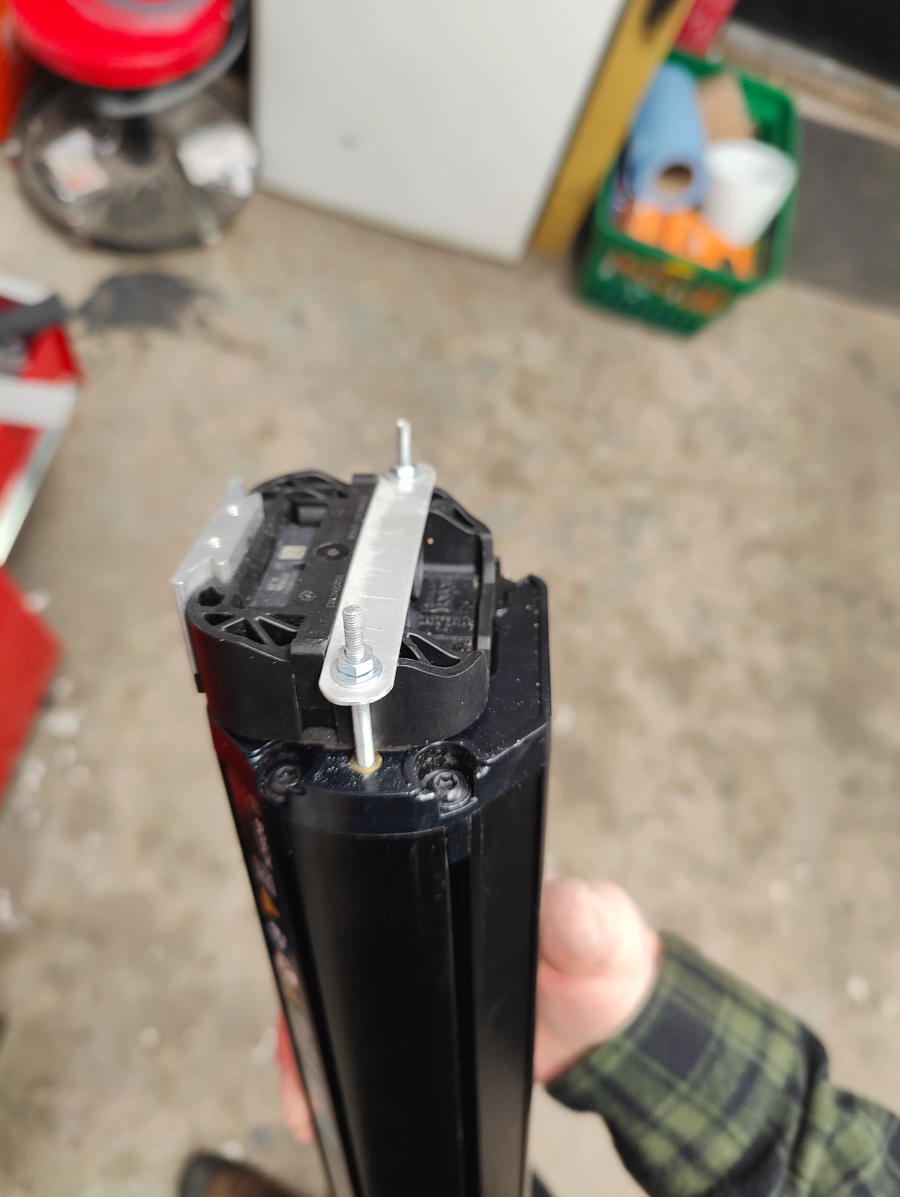

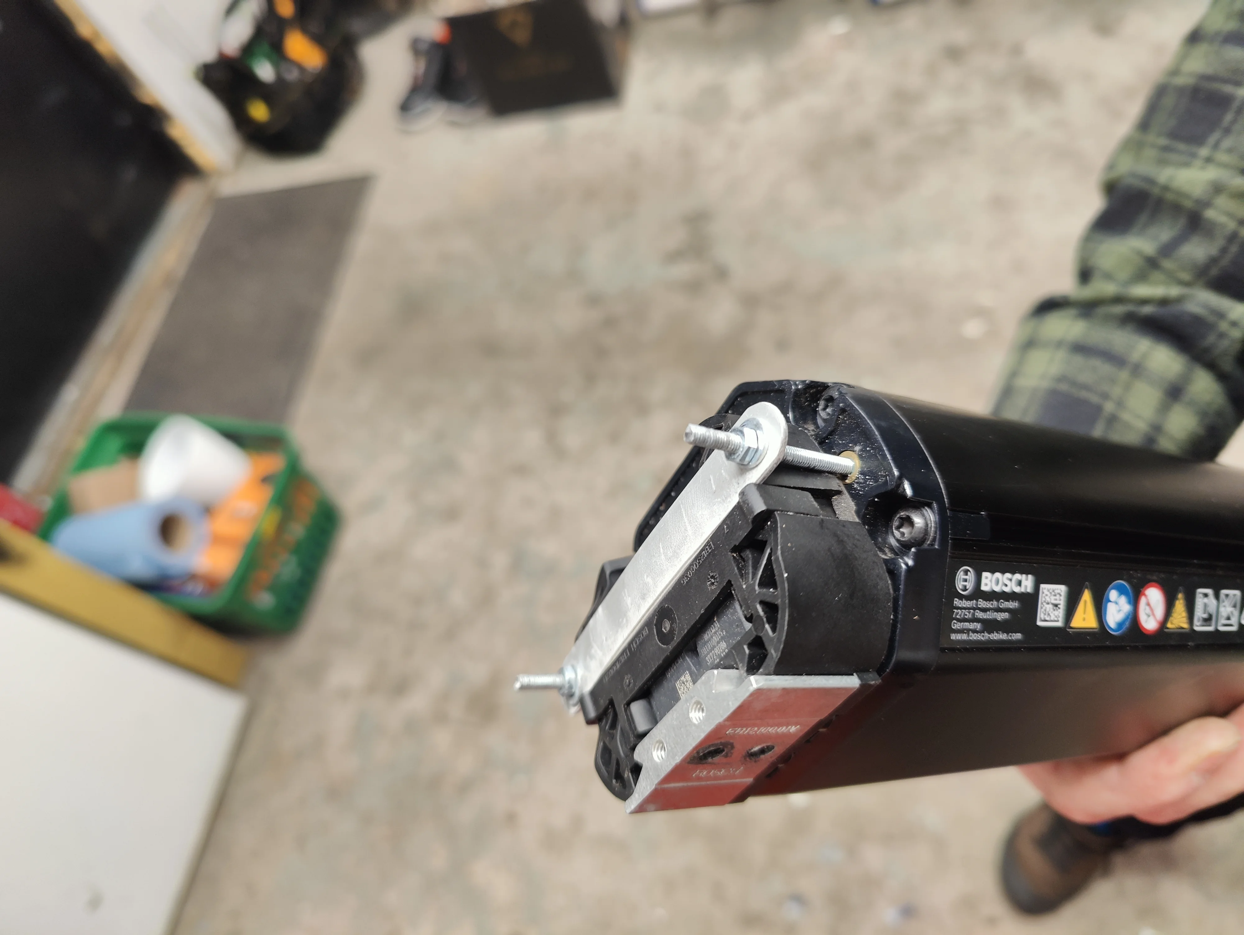

Pretty simple operation. M4 treded bars and nuts. And a piece of aluminum.
178592 178593
@Lantz that bracket is a neat bit of work. Clean, simple, and it addresses exactly what the problem actually is rather than dancing around it. The dense foam approach some owners use (stuffing foam behind the connector to maintain pressure) is a similar idea but your solution looks considerably more permanent.
For anyone reading this thread and dealing with the Wild's cutout gremlin, the sequence is now pretty clear: dielectric grease on the contacts first, and if the problem persists, a mechanical retention bracket like Lantz has done here to stop the connector working loose under vibration. Two different root causes, two different fixes, and now there's photographic evidence of the bracket solution which is worth its weight in gold.
