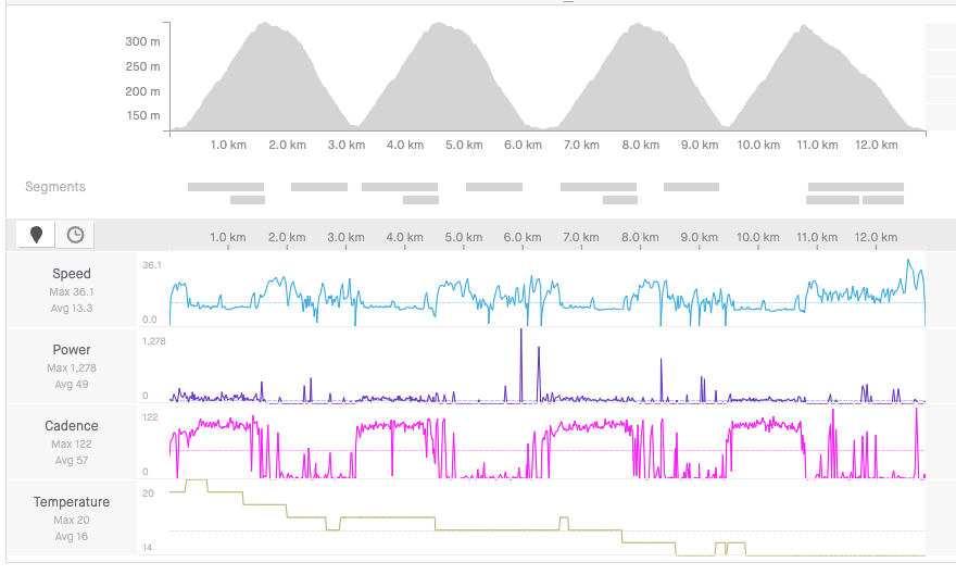

Keen for feedback, mine was not even close, like sub 100w. I did some like 7min shuttle runs up a fire road, threshold/v02max type work.

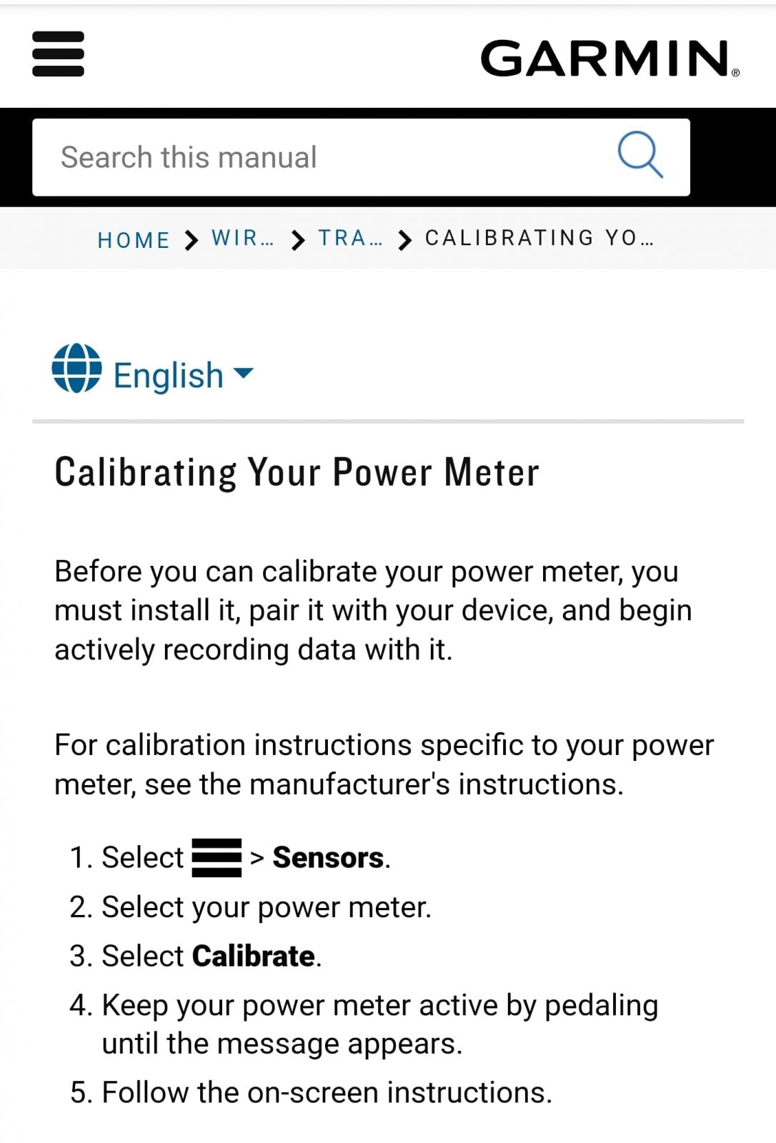

Has anybody figured out how calibrate the syncdrive power sensor to a Garmin 830?
This Garmin 830 I'm trying on, is connected to the Trance X power meter... easy enough, but the data is junk, and needs at least some sort of calibration.
I'm not having any luck finding a coherent explanation online.

To be honest, having never used a cycling computer before, or tracked my workouts on anything more complicated than a Fitbit, there is much to absorb with this little Garmin Edge.
I found this at the Garmin's support page, but it only states to follow the manufacturer procedure.

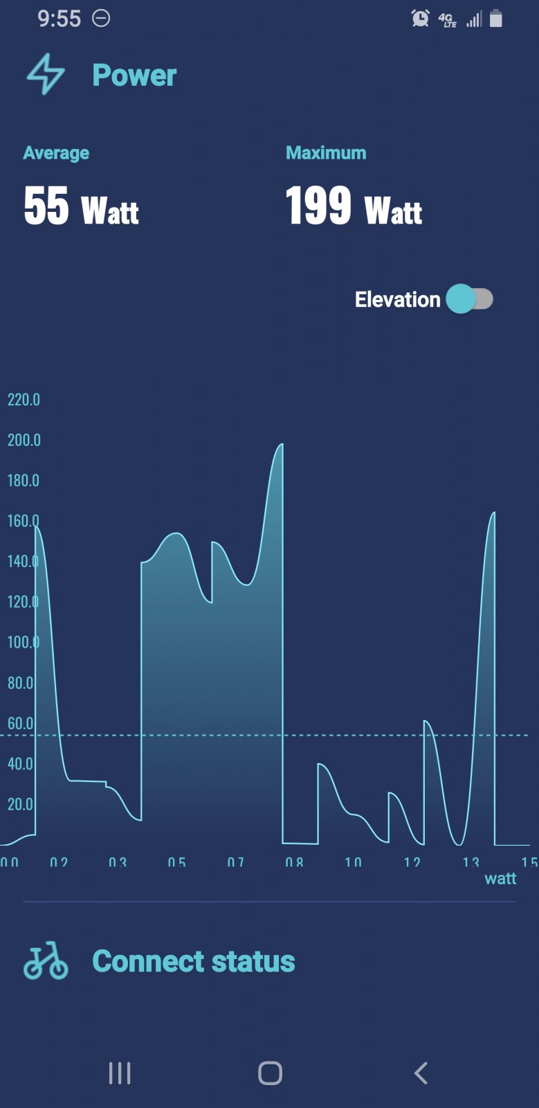

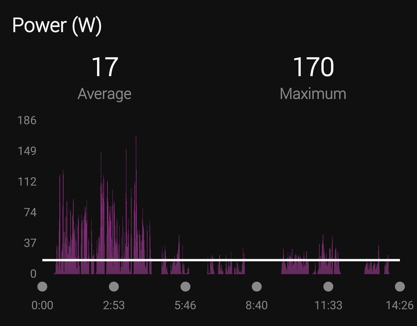

But today I was able to record a 2nd ride with Giant Ridecontrol and the Garmin Edge 830, at the same time to compare. I was only able to manage about 15 minutes of very easy peddling, but the recordings are sufficient to compare data.
The power data being sent to the Garmin doesn't match the power data being displayed in Ridecontrol, at least on my rig, for certain.
Obviously the Garmin is expecting rider power, maybe the Giant is sending motor power? Who knows... I can find no documentation on Giants end.
RideControl App with data from Giant ebike system.
Garmin with data from Giant ebike system. Same ride as recorded above.

I have not been able to ride much because of a screwed up lower back.
That is bogus data. The motor should peak at close to 500w and human rider input is typically between 120-250w. 17w is a phonograph motor. 55w is 1/13 hp. Let's take the 55 number: So at 55w, one could ride about 11 hours continuously on a 625wh battery. Maybe on a bike stand but not with the bike on the ground.
