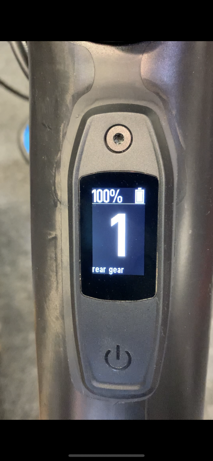

Uploaded the latest update and the “Bike Lock” works great. The AXS gear field however just looks like this. Is it supposed to work straight away or have I missed something.

Someone wrote, that it worked after he disconnected the axs system from the bike in the axs app. I didnt't try it yet.

I’ve uploaded the new software, that’s all I’ve done. The bike lock function worked straight away, haven’t done anything else
That’s why it isn’t working then…
1. Turn on bike
2. Enter setup menu of MasterMind display (keep +/- buttons on remote pressed)
3. Navigate to: Sensors / Pair ANT / Shifting
4. Confirm "Shifting" with F1 remote button
5. Press AXS rear derailleur button once to pair RD to MasterMind TCU
6. Make sure pairing to AXS is confirmed on MasterMind display
7. Open Mission Control and connect to bike
8. Go to TUNE and CUSTOMIZE DISPLAY
9. Create AXS display field to see AXS data on MasterMind display
Baron

Thanks very much, I will have a crack at that later on.
14,030
20,823
There is another thread on this and some people who've had a problem pairing have found that removing the derailleur and then holding it next to the TCU for pairing gets around the problem. In some environments possibly there's interference.
You can put it back to ride ..... ;)

I’ll give it ago, 👍

I tried to pair many times, and it also kept failing. I did finally get it to work though - I just kept repeatedly shifting back and forth at the paddle while it was searching. Didn't have to remove the derailleur.

lol. thats way too much hassle.....

Did mine also like described and it’s works simple as peace of cake 👌

Had to take off the AXS unit and put it next to the TCU for it to connect.
Strange….but if you follow thes descriptions below it’s so easy done….

Did all that but the TCU wouldn’t find the derailleur. The other way worked for me, very happy with the update.

Moving the mech next to the TCU didn't work for me, but shifting back and forth as recommended by @MM5K worked fine. Go figure.

Made an account to say thank you for the pairing suggestions! The device distance was the issue(carbon blocks signals as well), instead of removing the derailleur, I removed the Display and gently pulled the cables all the way out. That got me half way to the derailleur which was close enough to pair. Only needed the T10 bit for that :), don't forget to hold sync button down till it flashes.

Got mine to work, shows the gear I'm in and the battery charge...
the problem however is it shows 100% until it doesn't .... so went from 100% to Low battery warning (20%) nothing in-between .
