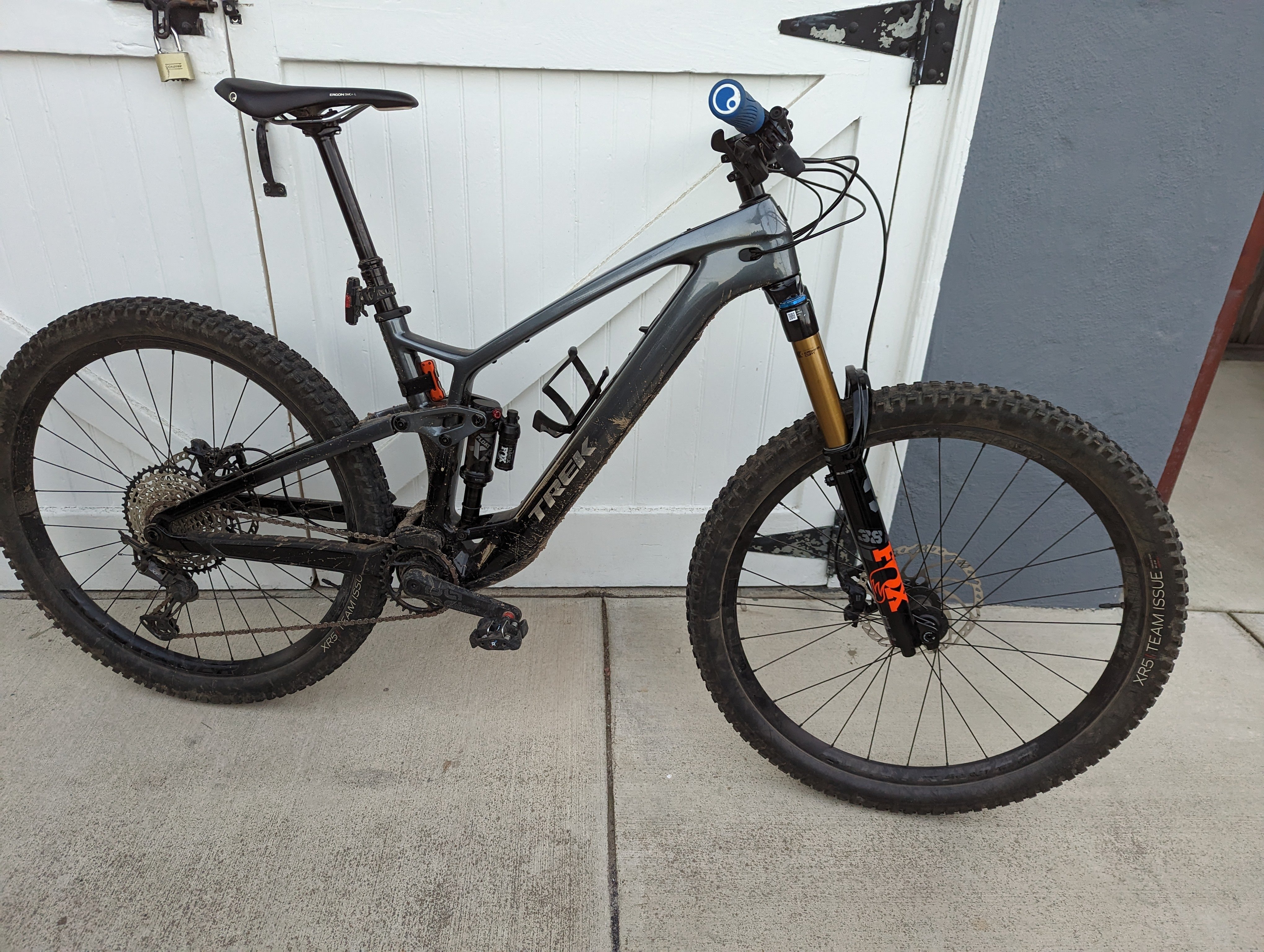

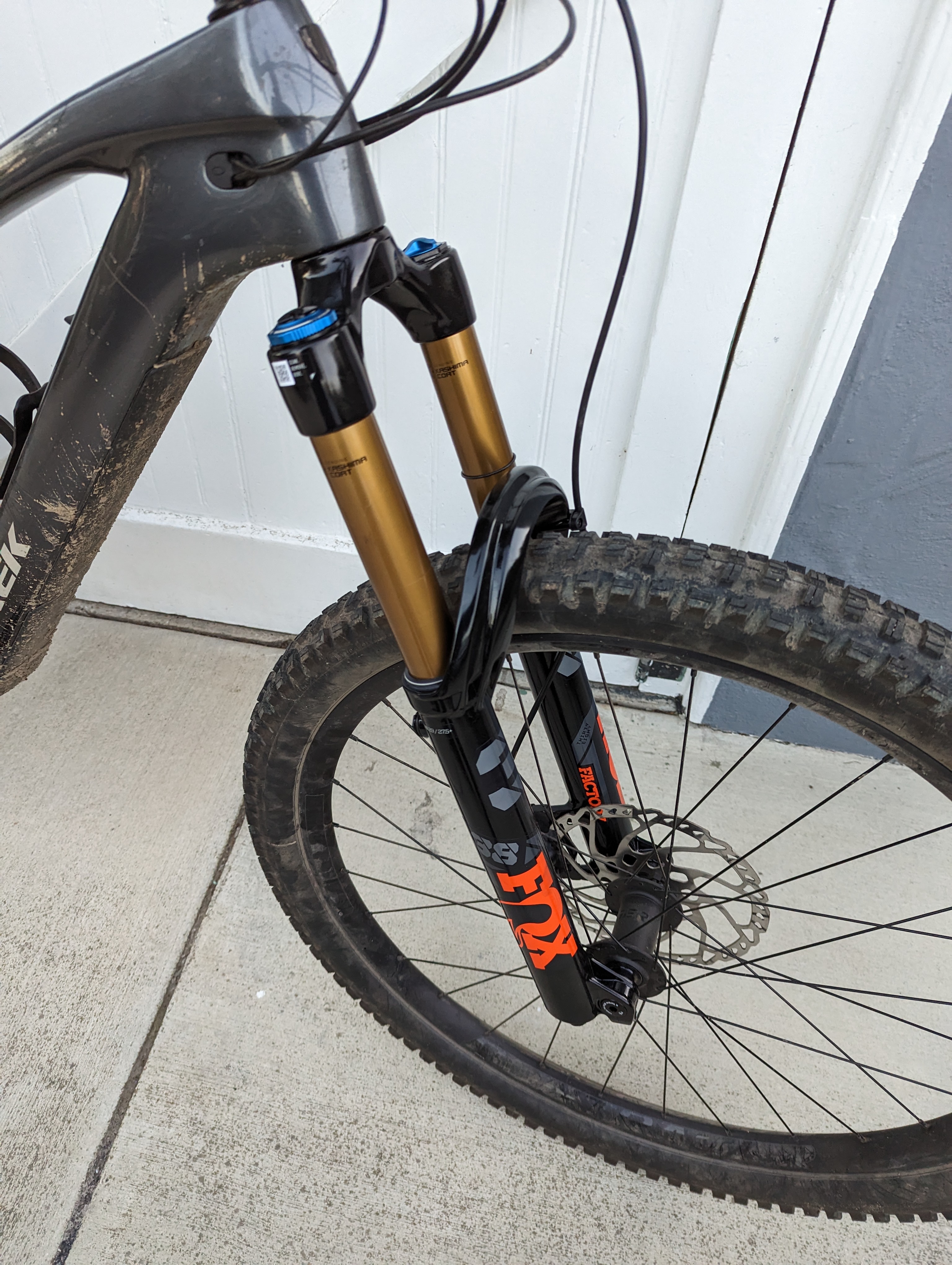

Just installed a Fox 38. Swapped the 170 air can for a 160. Initial sensations are really good.

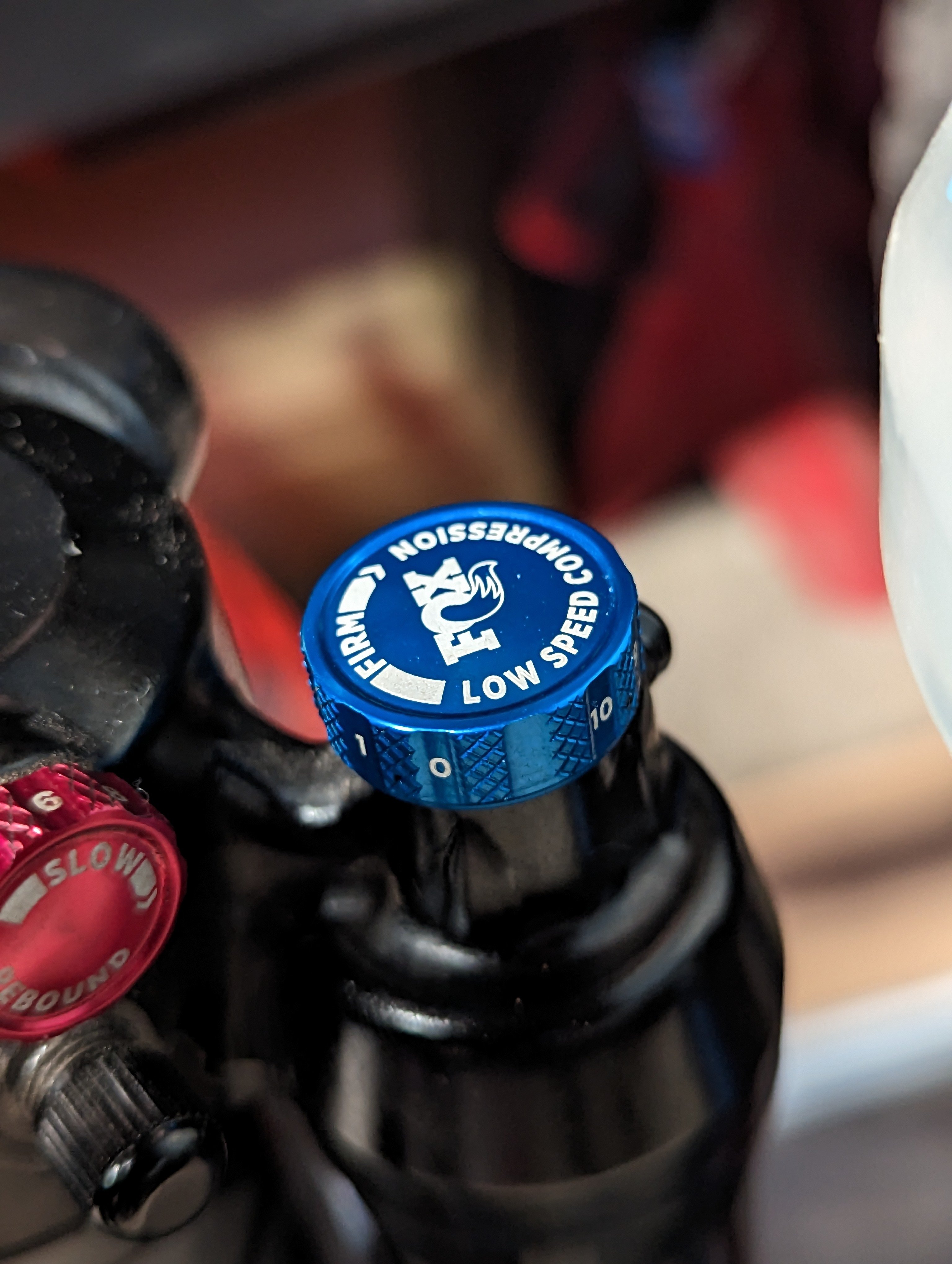

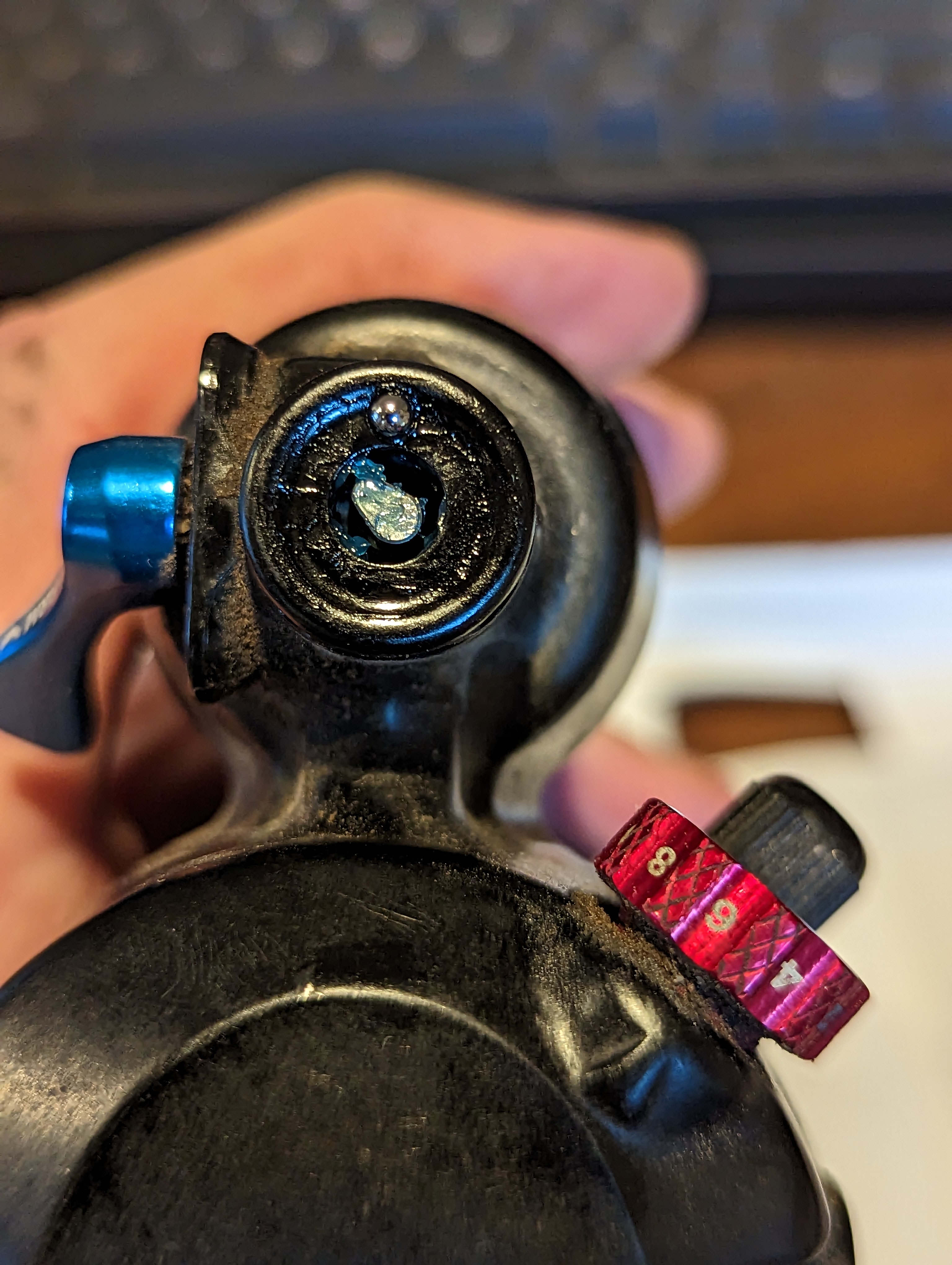

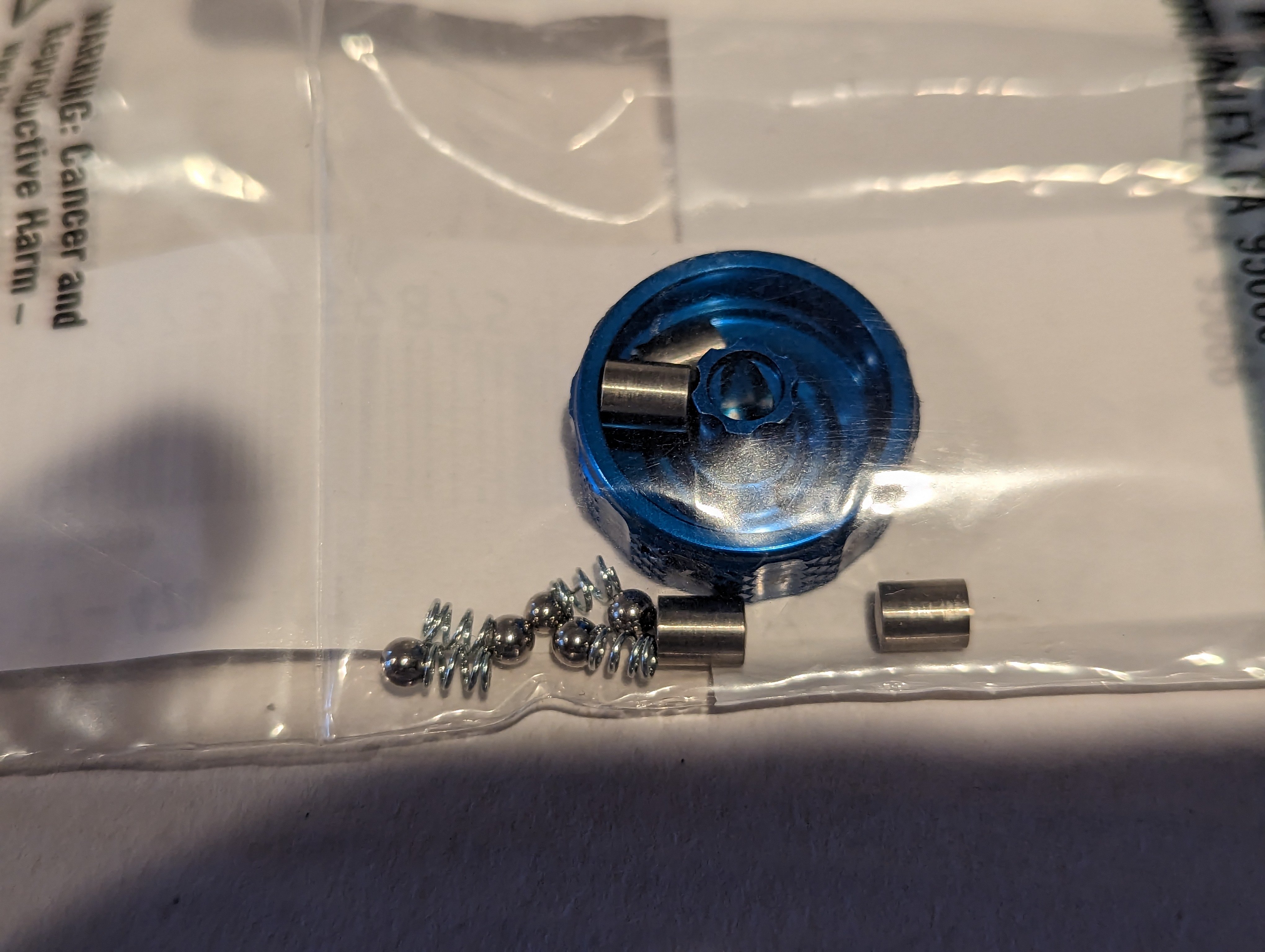

Received and installed the LSC knob kit to convert the Float X to a Float X 'Elite'. Couple of observations. The plastic cap can be rotated to four positions in 90 degree increments to change the LSC on the the Performance as is- it is set to full open from the factory. When you pop the cap off you will see the keyed shaft and ball detent. My advice is do the conversion on a tray of some sort as there are a number of very small parts that can get away from you. Grease is your friend holding the springs, detents and balls in place.
The trick is to not push the four detent assemblies into the bores in the shock very far. The balls prevent the cap from going in if you do. Once the blue cap is indexed to the key on the LSC shaft you can push it down against the detents and slowly start pushing the detents in under the lip of the cap. If you apply constant pressure in the LSC knob its pretty easy. Once the cap finds the groove its probably on there forever.
For $30 all in with shipping and tax this was a worthwhile experiment.

Also, 1 ball is smaller than the other 5. A caliper will be needed as it’s not obvious which is the smallest. The 1 small ball is the same as the ball already on the shock so it can be used or discarded.

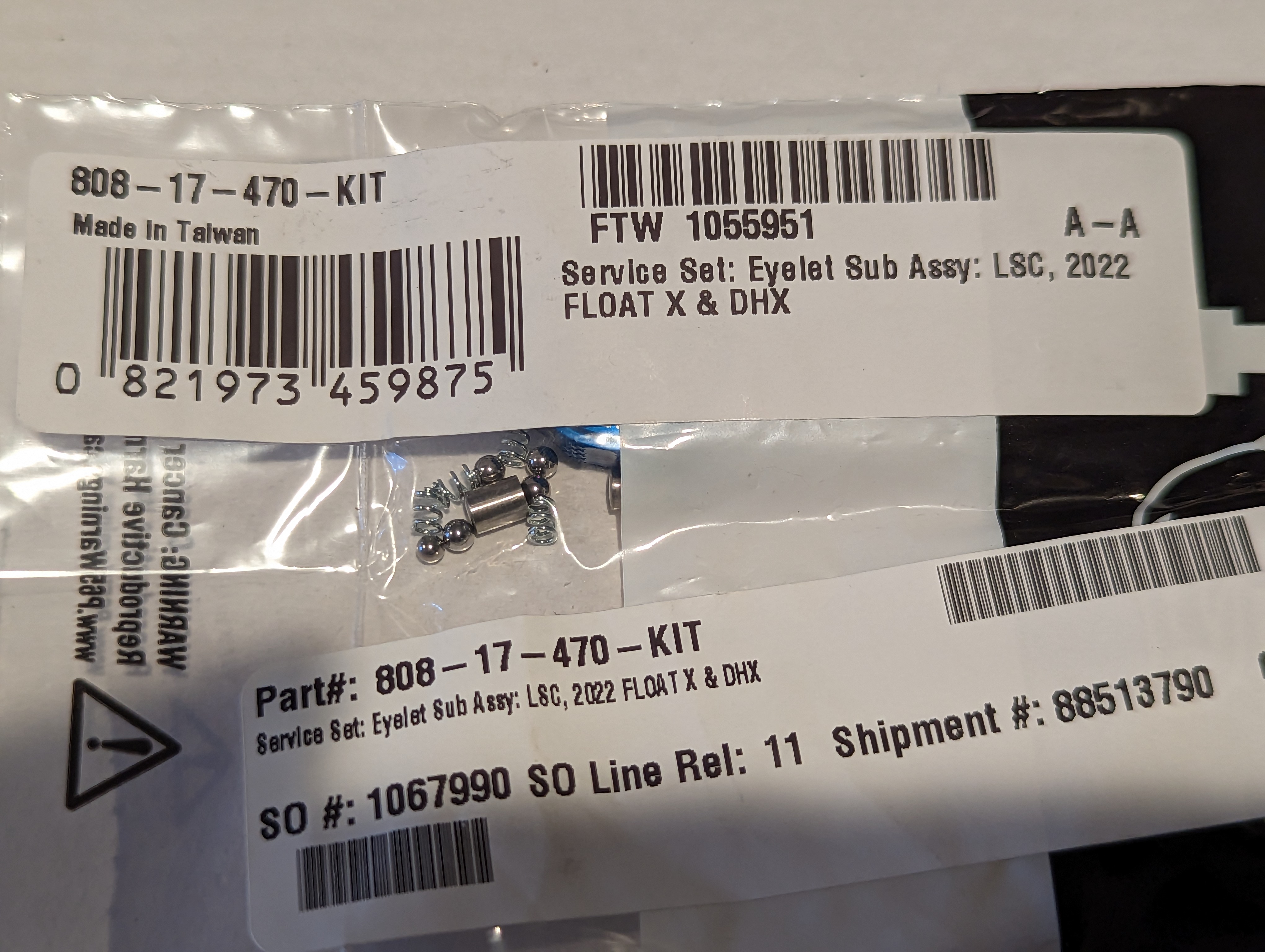

Also wanted to confirm the part number. In the diagram it ends in 470 and not 471. Just confirming that 470 is the part needed.
Cheers

Interesting- the kit was the -470 as shown on the bag. Not sure how I confused that. Fox has a part drawing
You will end up with a single small ball bearing that is not used. Its already on the shock (shown in first pic above). I pedaled with it full open and full closed last night I it appears that the pedal bob is reduced in the fully closed position. As I get further along I will start in with the middle settings. I am now thinking the stock setting was fully closed as the shock was really static when pedaling. Too much so for my taste.
I broke my rule of only changing one thing at time when I put the 38 fork on. My tiny brain can only process so much at one time.
