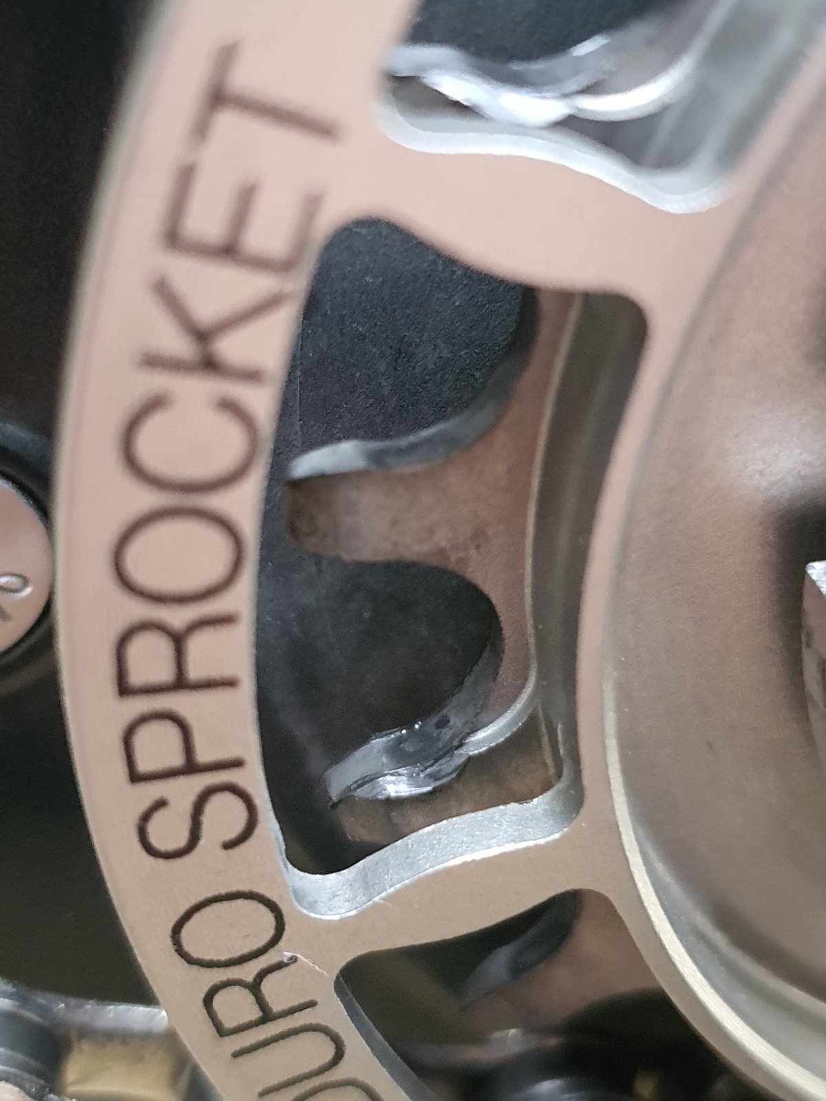

I'm in need of some help from the experts on here.
Today I changed the chain an the 3 smallest sprockets of my cassette. When i took the chain off i noticed the front sprocket had some things(i have no clue whats the name in english) on the outside of the wide theeth.
Can i file those away? Or do i need a new sprocket? Its 10 month old with 3500-4000km
The 20t sprocket is crazy expensive at 95€ and i do not want to replace it for that cost.
In the past ive had other 20-21t sprockets from kmc but had so much troubles with the chain jumping off at the front untill i went with a narrow wide sprocket.

I know otherwise the chain wont fit.
I want to know if this sprocket is done or not. Or if i can file those sharp edges away

I won’t hurt to file off the burrs ( sharp edges ) the sprocket is worn. See how it goes coz you’ve nothing to loose it doesn’t owe you anything.
