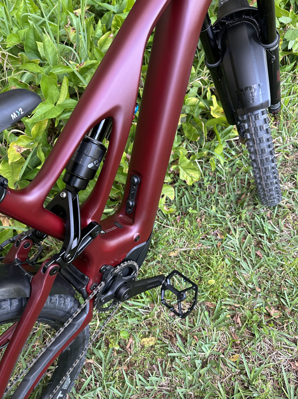

Did you ceramic coat the bike? I just finished applying bike ceramic on mine. It makes the flat look really good.
DirtFarmer
Dec 12, 2021
28
20
Lethbridge
Yours looks good. Fox front fender but what’s on the rear?
I did Ridewrap, clear flat.
Hockey tape and inner tube on the rear triangle.
Hockey tape patches wherever the wrap gets damaged. Basically fake tattoos to make it look tough. 😁

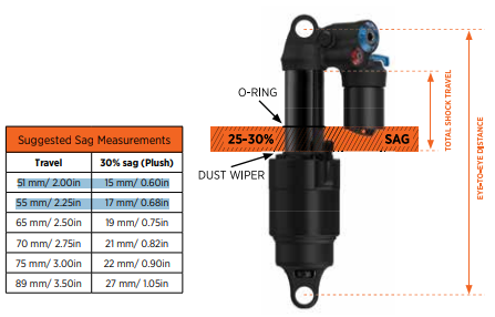

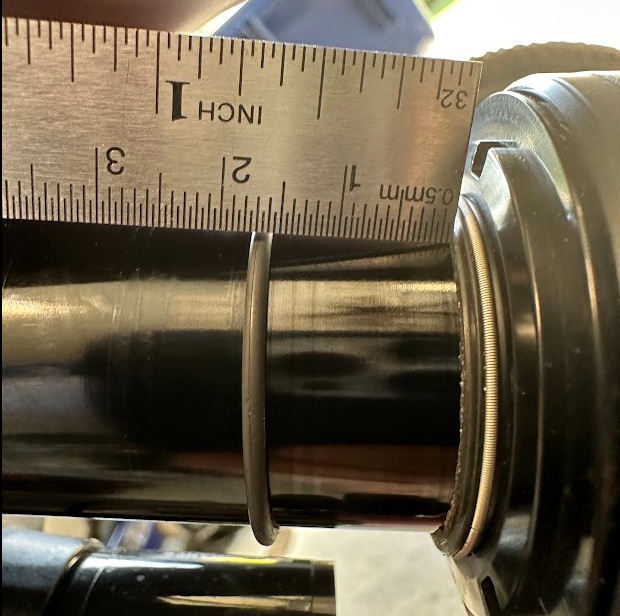

I have the Levo Fox Float X2 settings as follows. Still have to test.
Old air pressure 272psi for 15mm or 30% sag before the Cascade Link.
Added the Cascade Link and now the pressure changed from 272 psi to 290 psi. I am at 16mm sag.
I am 215lb loaded up and think if I weighed any more I may have a problem reaching 30% sag. The cascade link works but at the recommended 10% pressure increase the cost maybe for heaver riders not being able to reach 30% sag.
ebikerider
Oct 1, 2019
706
480
FYI
25% shock sag for 2022 55mm stroke shock is 13.75mm.
30% is 16.5mm.
IOUZIP
Jun 8, 2022
44
37
FYI
25% shock sag is 16.25mm.
30% is 19.5mm.
Edited:
Levo size S4 has 55mm stroke. 30% of that is 16.5mm
Cascade Link changes that calculation. Add 10mm for 65mm stroke. 19.5mm for 30%
290psi gets me 16mm SAG if I run less pressure (280psi) Shockwiz tells me to add air. I did the calibration twice.

I had the same problem. Swaped my x2 for a Float x and very happy. went from 310psi to 260psi in the floatx.
ebikerider
Oct 1, 2019
706
480
Levo has 52.5mm stroke. 30% of that is 15.75mm
Cascade Link changes that calculation. Add 10mm for 62.5mm stroke. 18.75mm for 30%
Tonight I went for a ride at my local trail which has a great section that includes high speed flow, pump, roots, climbs, and drops.
Air Pressure: 290psi
No Spacers
Low Speed Rebound: 3
Low Speed Compression: 7
Thread refers to 2022 bikes so I assumed you had that bike/shock.
I’ve edited my post.

Size is S4 - 2022 Levo Expert. I thought the Specialized rear shock Fox Float x2 stroke came with 52.5mm stroke. Now I see I was wrong. I have the 55mm stroke in my S4. With Cascade Link I changed shock pressure for 16.5mm sag (30%) which for me is 295psi.
I played around with the Specialized calculator and to get the shock PSI of 295 is for RIDER HEIGHT & WEIGHT
5 ft 10 in · 232 lbs. I am 215 LBS but the Cascade Link changes the PSI to what would be a 232 LBS rider.
I looked up the serial number on Fox's web site.
Description: 2023_22, FLOAT X2, P-S, A, 2pos-Adj, Specialized, Levo F1, 210, 55, CP101, RF001, Rezi BP101, Standard, Neutral Logo, N/M
