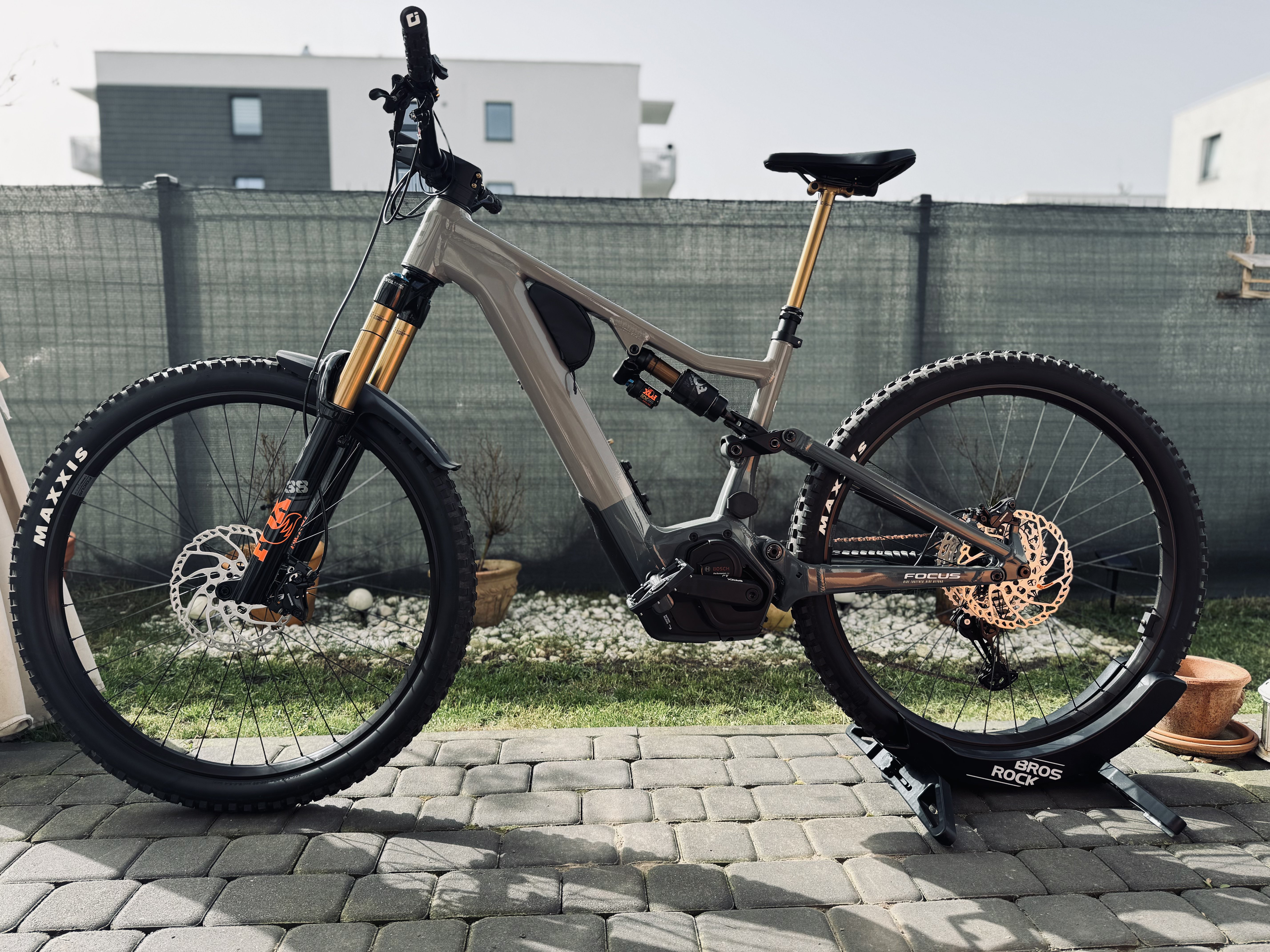

Great to hear. Looking to grab a 6.7. I have a Fox 36 i plan to put on. But was considering a 38 or zeb.
Any issues with fitting the fork due to the cables going through the stem?

Did you try out the RockShox Deluxe Select shock that comes standard? I'm thinking of upgrading this asap. Also what size is correct. The site im buying off has 210x50 but I thought it was 210x55. ?
Cheers
9,361
9,936
Cheers
You can change the stroke by changing a spacer inside the shock. I can't recall now whether or not the spacer needs to be bigger or smaller to increase the stroke. But a few minutes on Google should solve that. You can make the spacer smaller by removing volume from it, or just by buying a smaller one.
Added later: Or contact TF Tuned and ask them if it can be done and how easy it is. They might even sell you the spacer!
