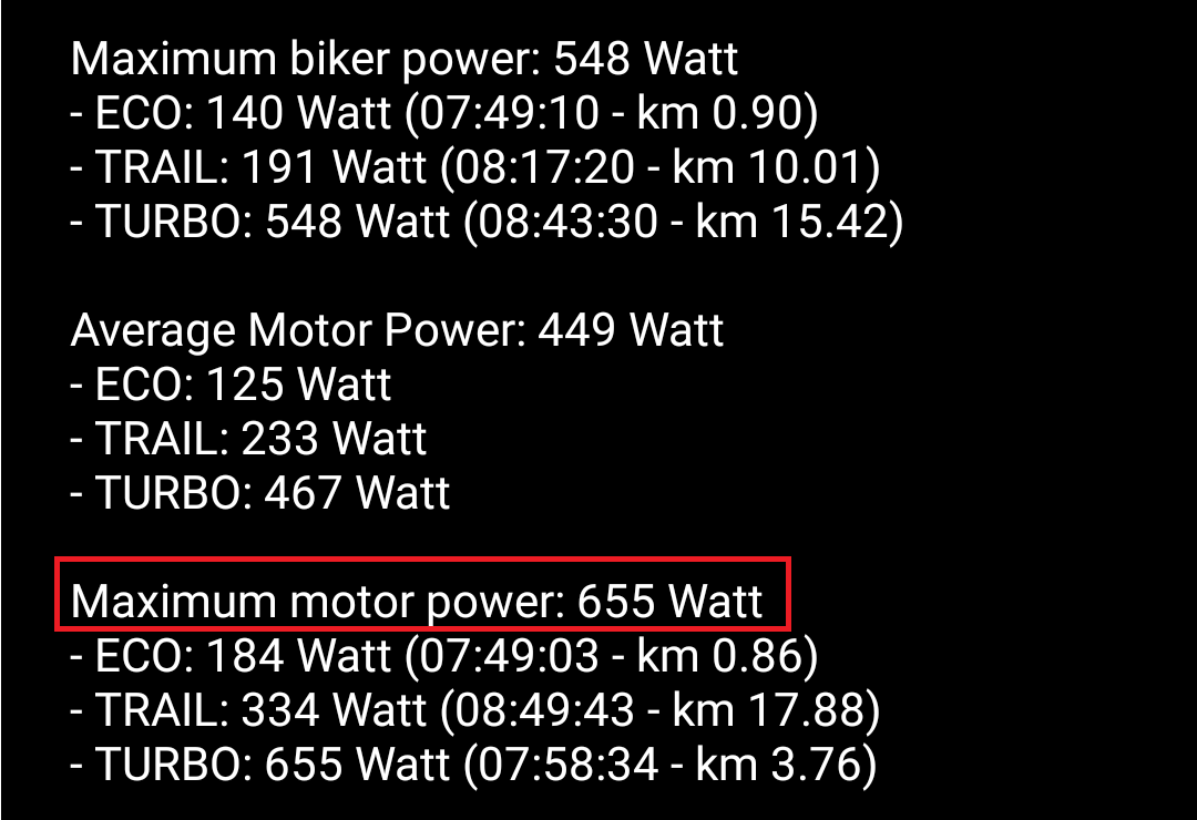

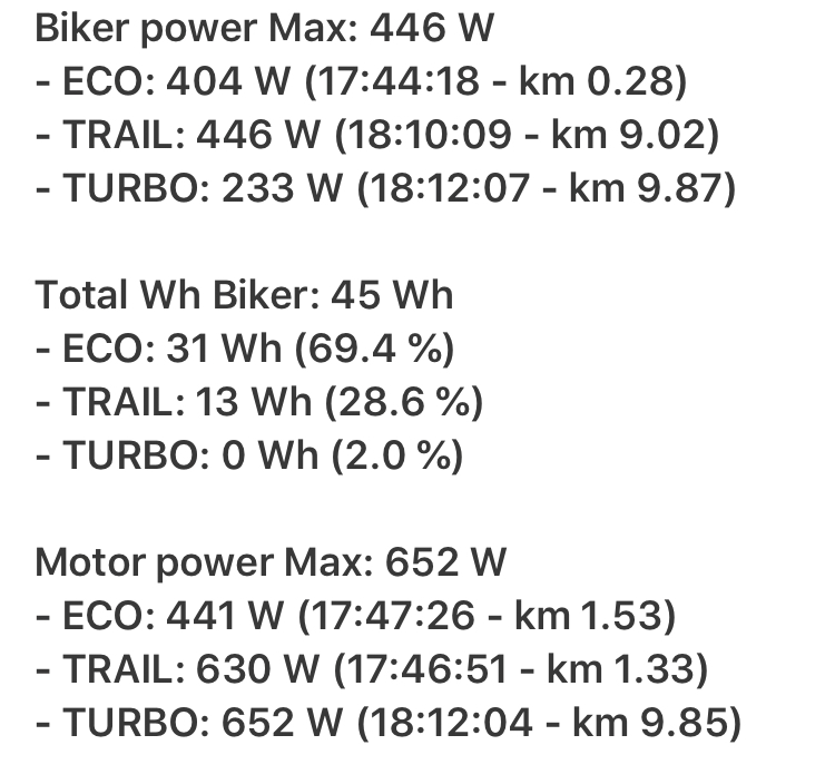

Here are a couple of outputs from recent rides :
Maximum motor power: 749 Watt
- ECO: 490 Watt (16:44:47 - km 19.99)
- TRAIL: 749 Watt (15:19:20 - km 0.15)
- TURBO: 711 Watt (16:08:15 - km 13.05)
Maximum motor power: 763 Watt
- ECO: 436 Watt (12:53:30 - km 0.02)
- TRAIL: 763 Watt (15:01:07 - km 28.87)
- TURBO: 761 Watt (15:02:05 - km 29.26)
- ECO ⚡+: 675 Watt (14:26:01 - km 0.05)
- TRAIL ⚡+: 739 Watt (14:32:04 - km 4.78)
- TURBO: 749 Watt (14:28:16 - km 1.79)
Some people [on the forum link above] suspect that the issue lies with the software reporting, and that there could not possibly be such a difference (of approximately 200 watts!) between many of the reported output statistics . . .
Others speculate that something fishy is going on and that the Brose motors have quality control issues . . . I really don't have a set view on the matter as I haven't looked into it deeply.

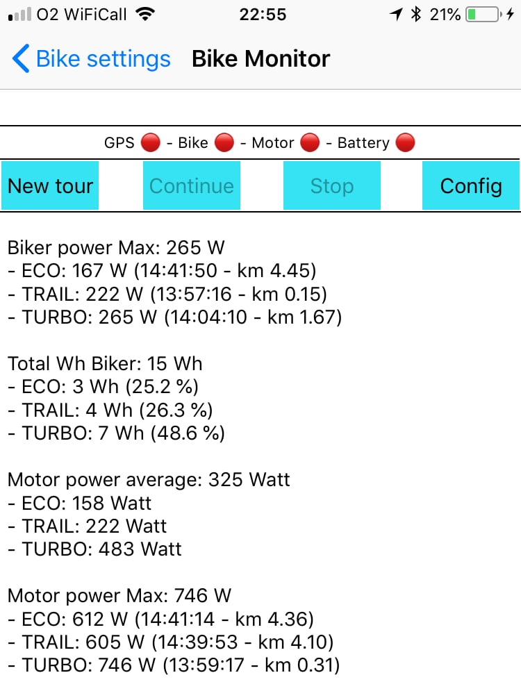

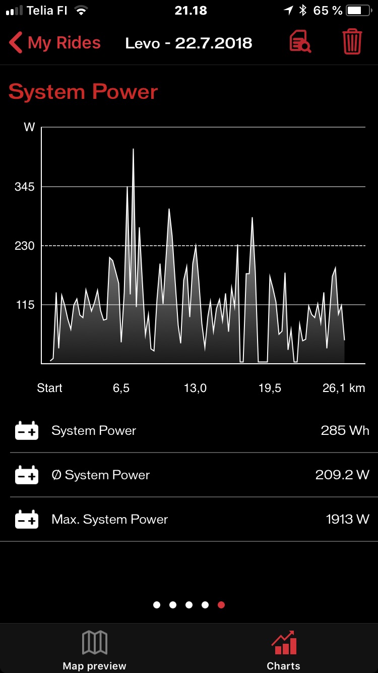

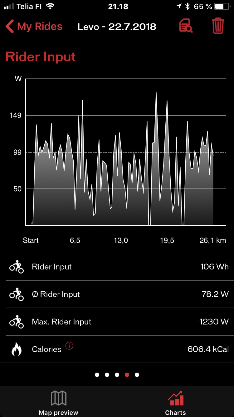

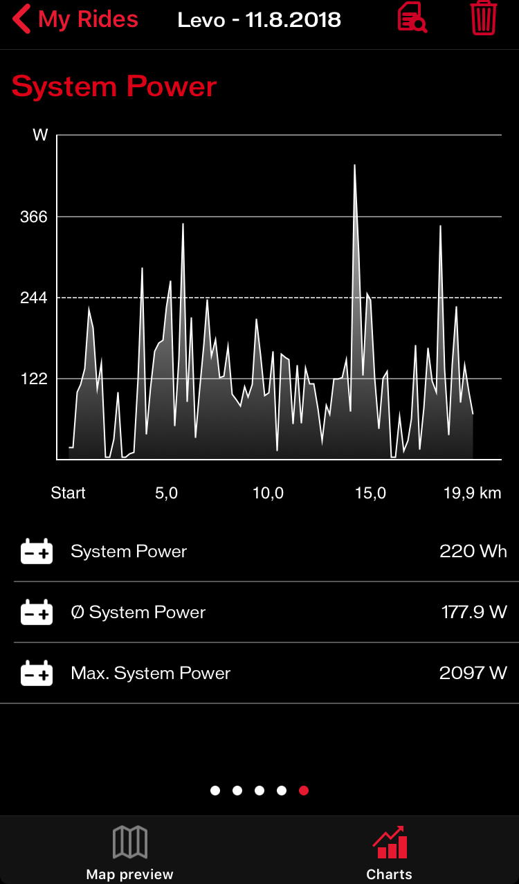

My Turbo Levo HT has 1.2 motor. This morning i did ride with my daughter, Burley honey bee was attached to Levo. Mission Control:

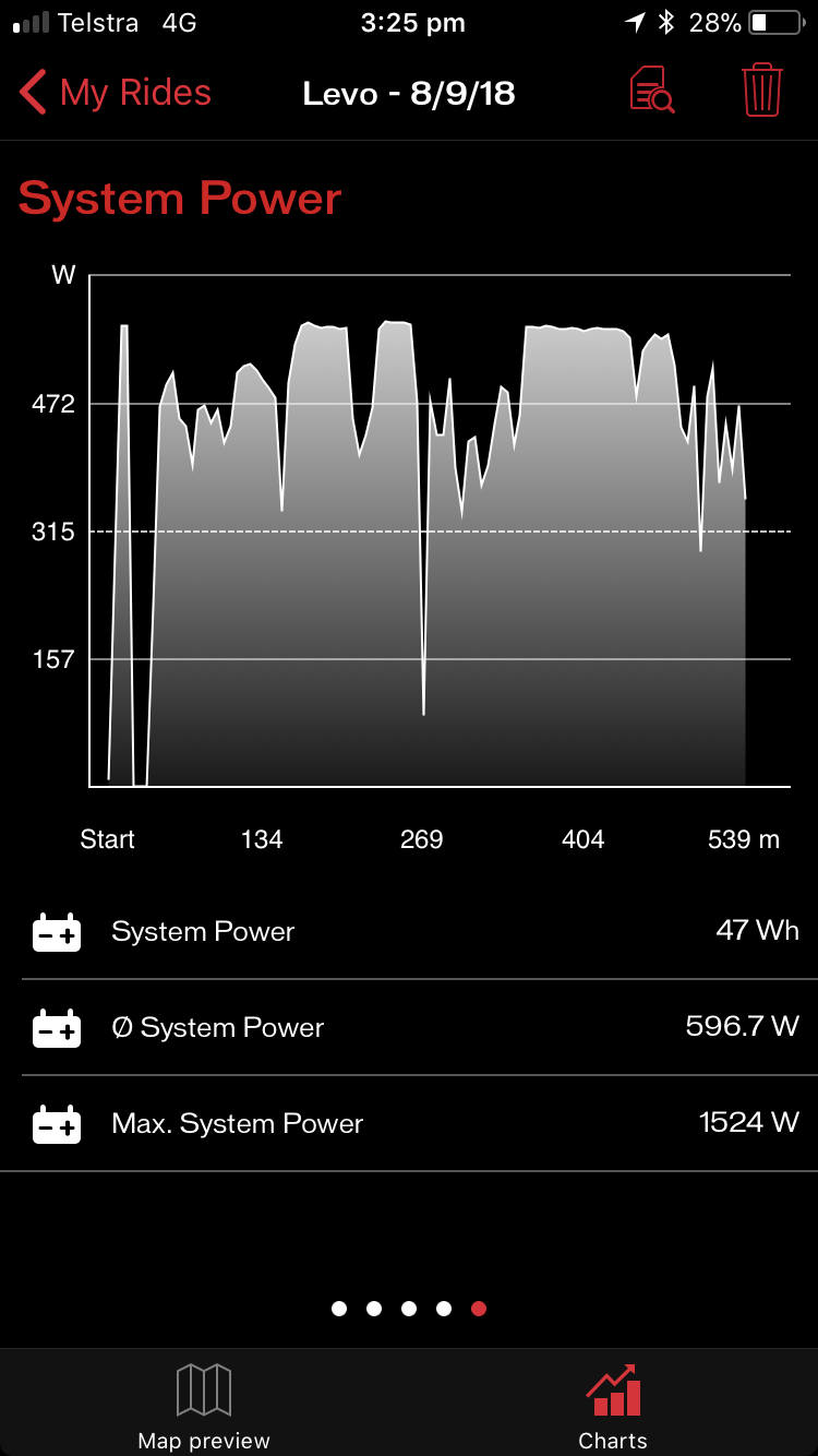

2019 Kenevo running latest firmware and using mission control

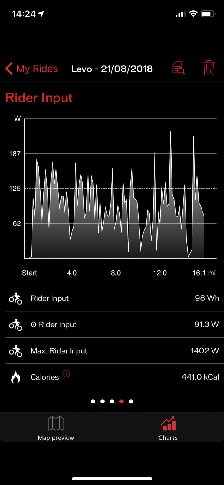

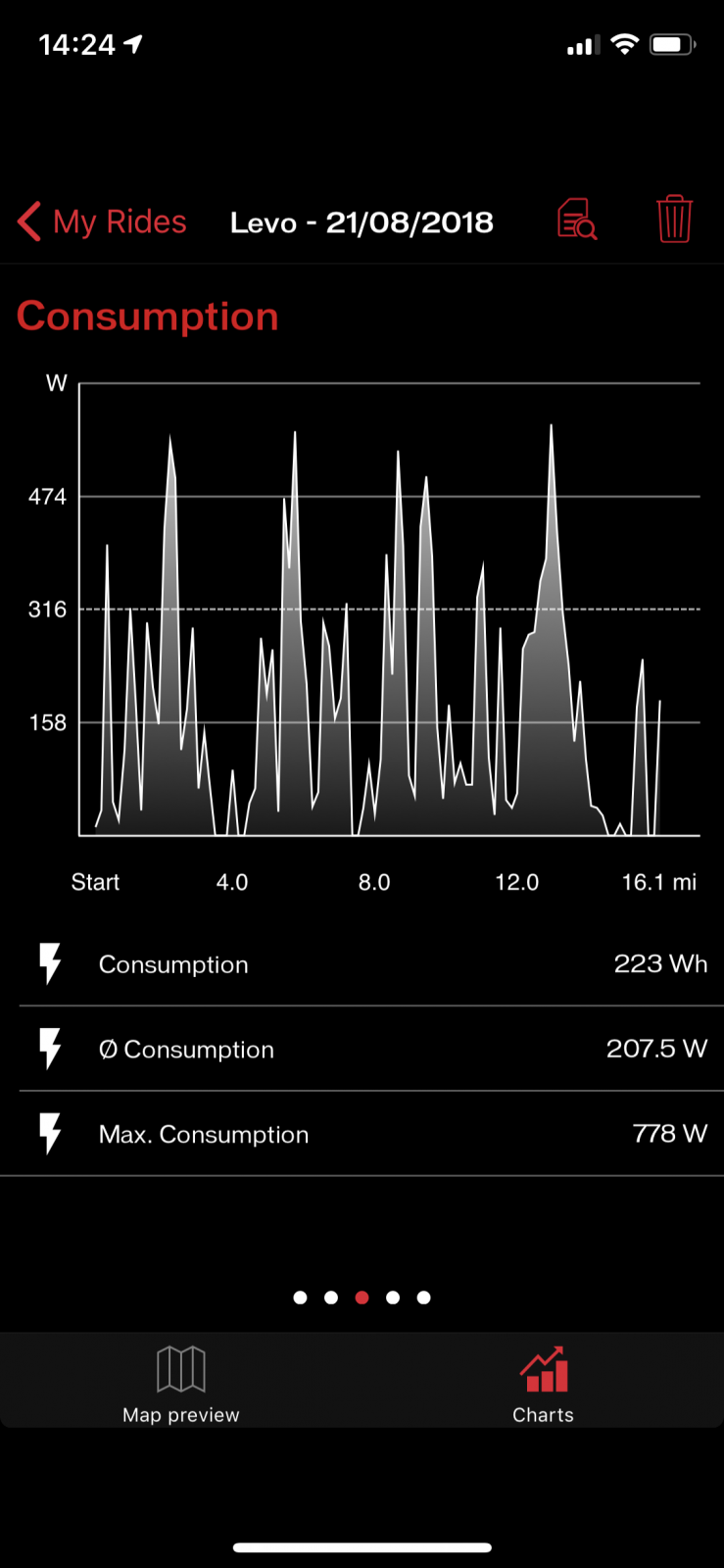

I am regularly seeing peaks over 800 and the max system power I can find on a ride is 1.65kw
Screenshots are from a quick 1 hr ride where I rode in Turbo to get as much riding in as quick as possible with Support at 100% and Max Motor Current at 100%

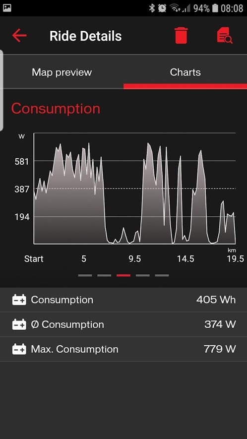

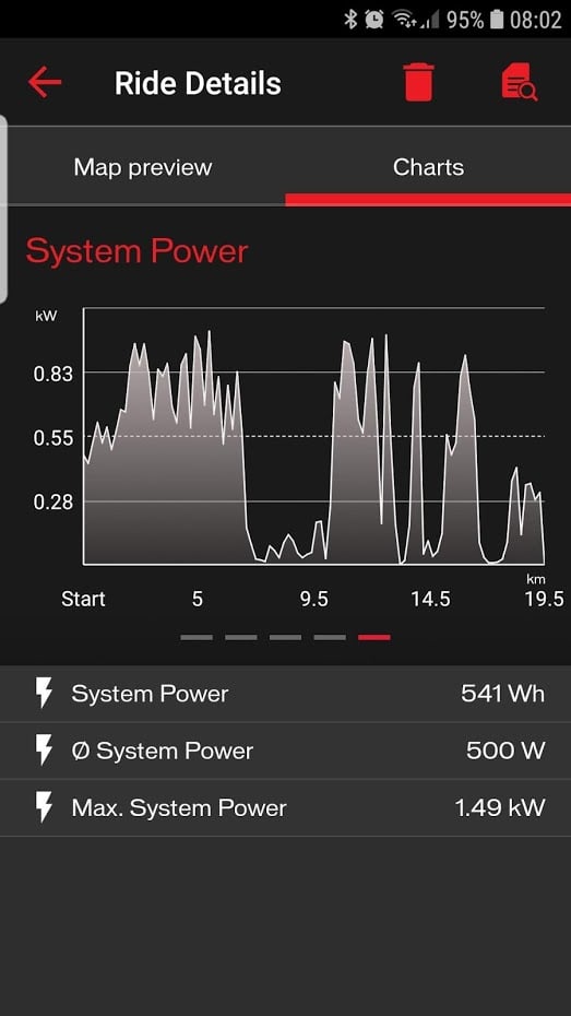

If the "Max Consumption" equals max engine power in Mission Control, then I just had 752 watts today and that was just an acceleration on flat trail. My bike is a brand new Turbo Levo carbon Comp only 1 week old. For some odd reason it came with newest firmware on the motor and 22.3 on the battery.

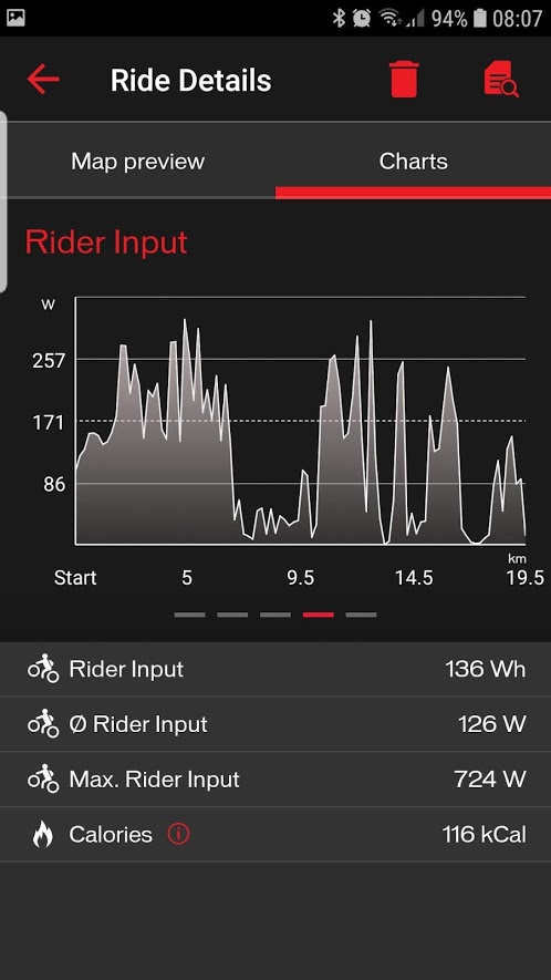

1.4KW!!! Maybe @Tori the other thread that you linked is correct, so many variables here!

Over 2KW. It depends your legs also.
And this is from 1.2 motor of turbo levo ht.

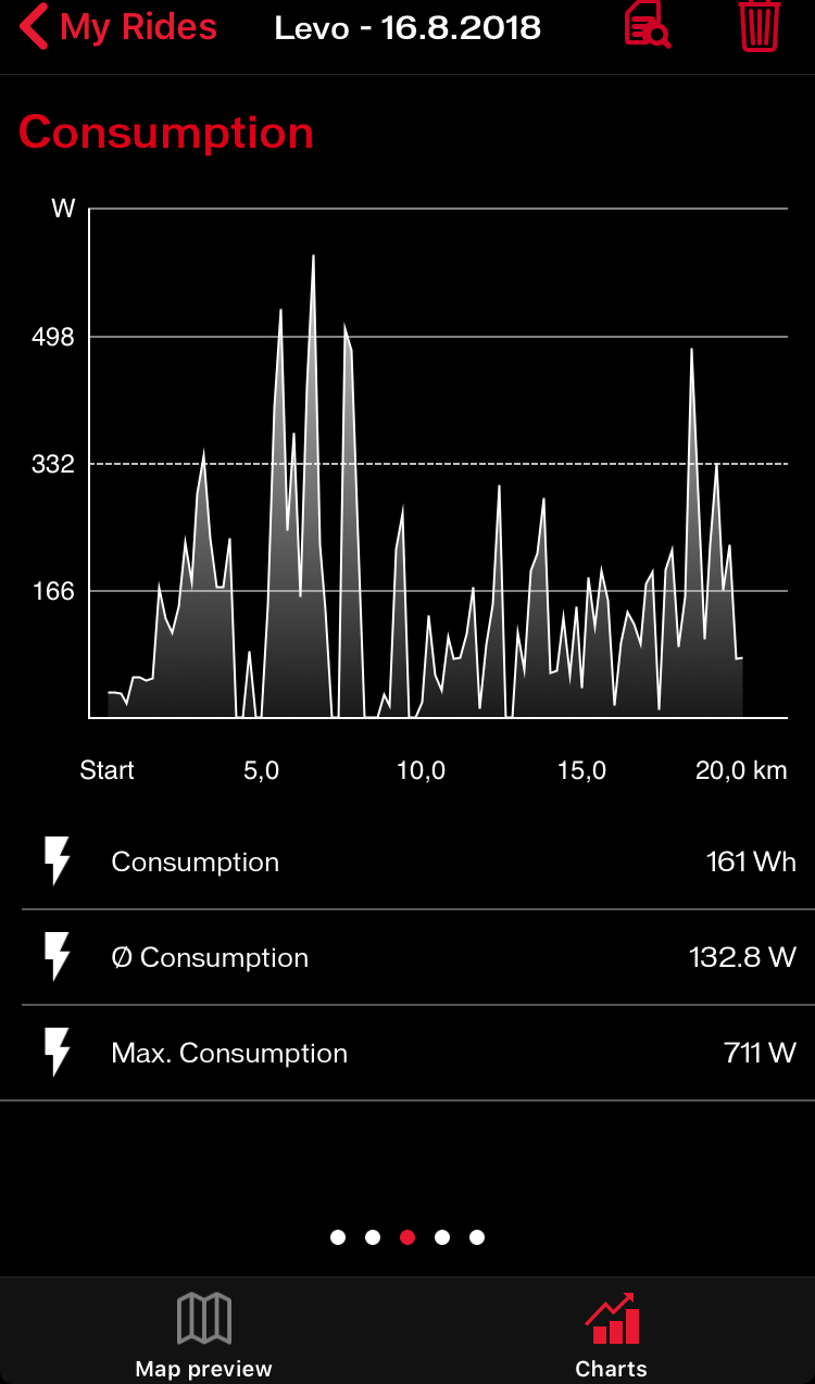

Really interesting stuff @Tori thanks - I’m back from holiday next week and will report back what mine checks out at...

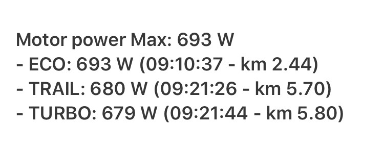

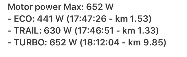

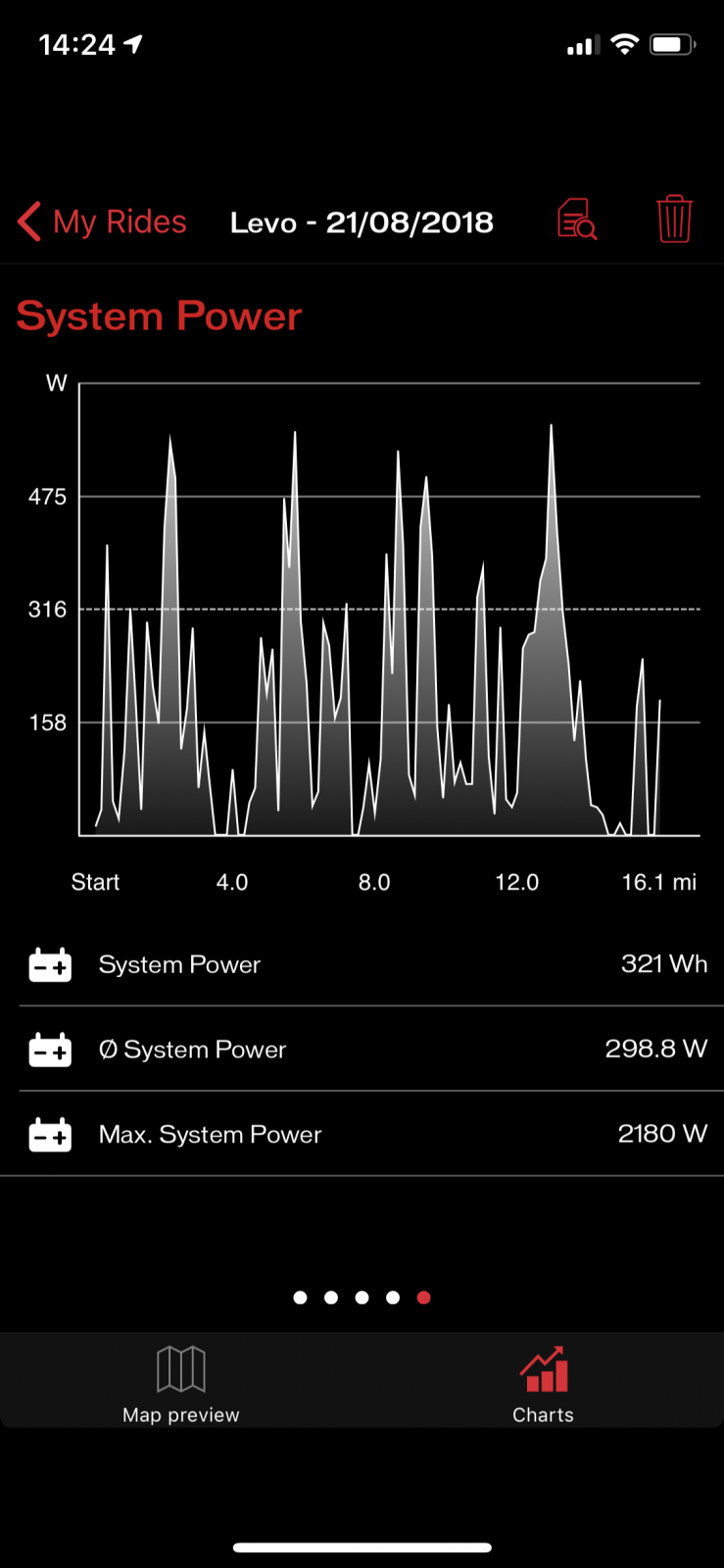

OK, here's my ride from this morning, TURBO all the way(100/100) - (first ride after a 2 week holiday :cool: )
1.3 motor x.23 / 5.0.4

about 15% more power and looking at robs figures above compared to yours thats more or less right I guess

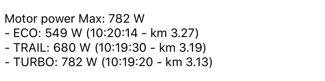

Since updating my FW to .23 I now am getting much higher motor power recorded:
