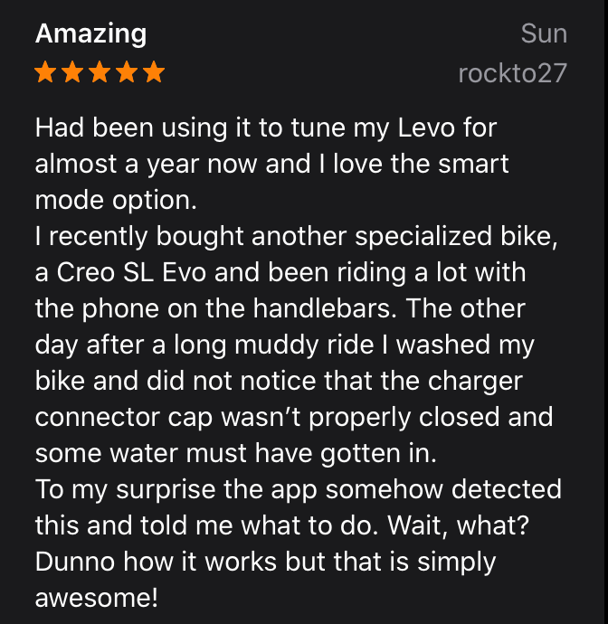

All - sorry that you've been seeing unexpected errors. Thanks for the info and name-check - I'll PM you separately to get serial numbers so that we can investigate ASAP.
Two upfront comments:
1) We've invested heavily over the last year in rider/retailer diagnostics that are there to help - see the app store review below for the kind of responses we've been aiming for. Agreed that these errors you're seeing aren't particularly helpful or expected - apologies - however if it's not stopping you riding, please just ignore them whilst we investigate.
2) The diagnostics messaging has been live for some months, however there are aspects that we haven't released yet and we're still testing behind the scenes - since these errors you've posted are still in engineering language rather than rider language it looks like something got released prematurely, but we'll chase this up ASAP.
Below image is when the rider diagnostics works as intended.
