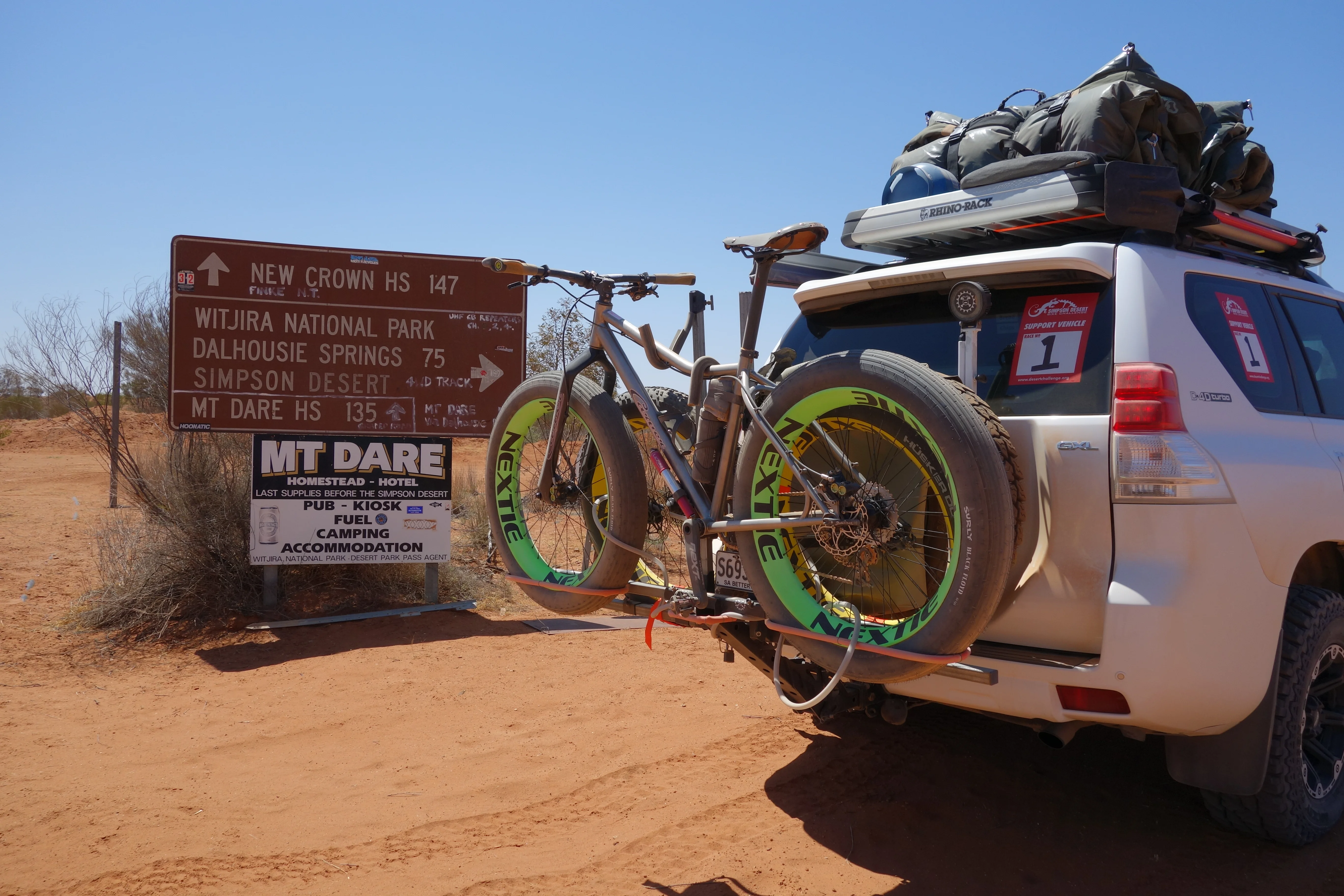

Top pic is my bike on an ISI rack for a Desert stage race in 2014, there is no direct wind on the bike apart from some dust swirl on the back of the car.

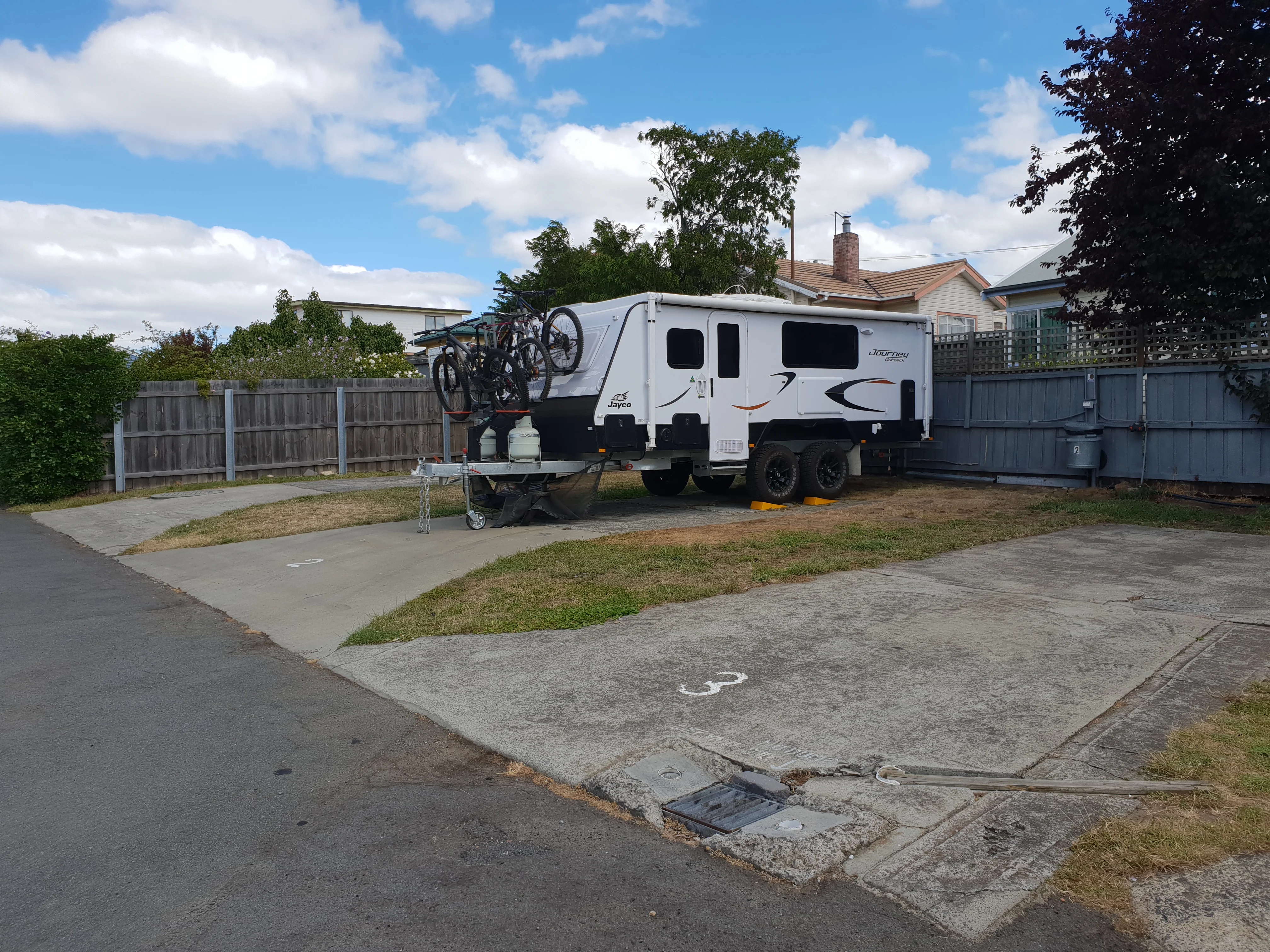

Bottom pic is the same rack mounted to my caravan in 2019 with 3 bikes on it. I regularly see travellers with bikes mounted the same way on the van with one of the covers above, covering the bikes. So it does work and there must be well made covers out there that will take direct wind at highway speed.

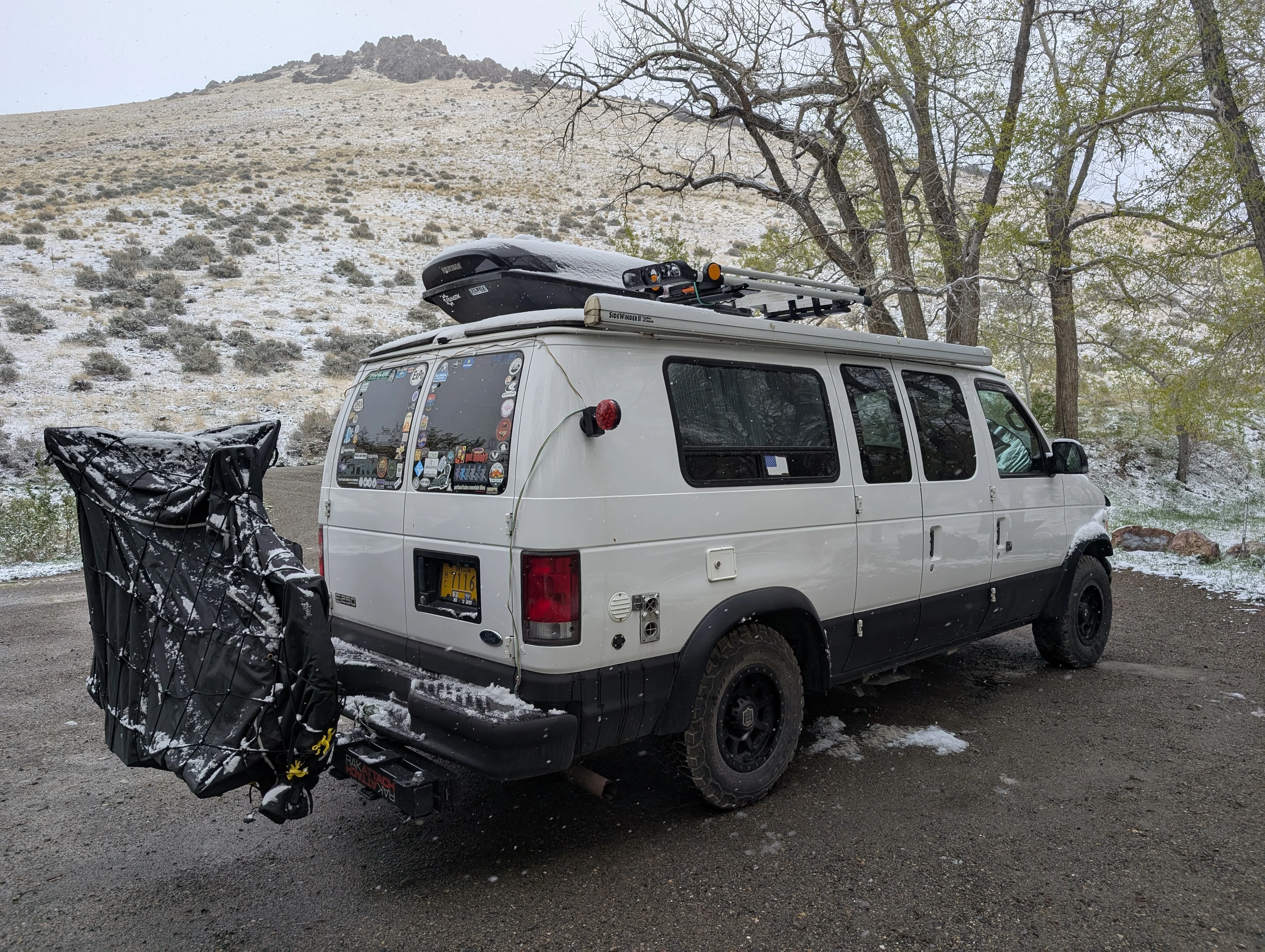

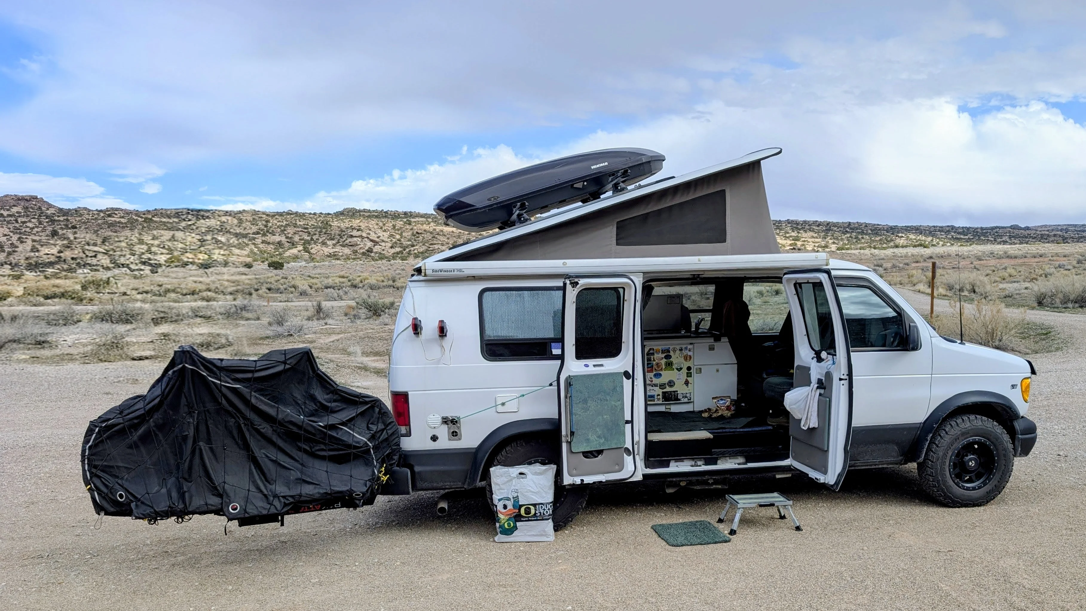

I like having a cover I can put on if conditions are nasty. After I got my Canyon, I upgraded my rear rack from a Yakima Swingaway rack to a 1Up Super Duty with RakAttach. This setup also allowed me to fit a cover so I purchased a "Team Obsidian" size XL cover that's big enough to cover two bikes. I added a bungee cargo net to secure it, so no flapping at freeway speeds to destroy the cover. When I tried it all out, I realized my tail lights were covered so I added a set of magnetic tow lights. On my first trip I realized the magnets in the tow lights were too weak to hold them securely in the horizontal position I was using so I found some stronger magnets and retrofit my tow lights. Finally, I installed some command hooks on the outside of the van for routing and securing the tow light cables. This probably seems like a lot (and it was) but I'm satisfied with the results. I travel frequently in my van with my EMTB and I like being able to cover it in inclement weather while traveling or even just to throw the cover on in camp to keep the bike out of the rain . I like the added security of having it out of sight too. I've gotten fairly quick at deploying the whole thing. The hardest part is unhooking the cargo net hooks from itself when I go to put it on. Is all this necessary to protect the EMTB? Perhaps not, but it give me peace of mind.
Love that van! 😊👍
