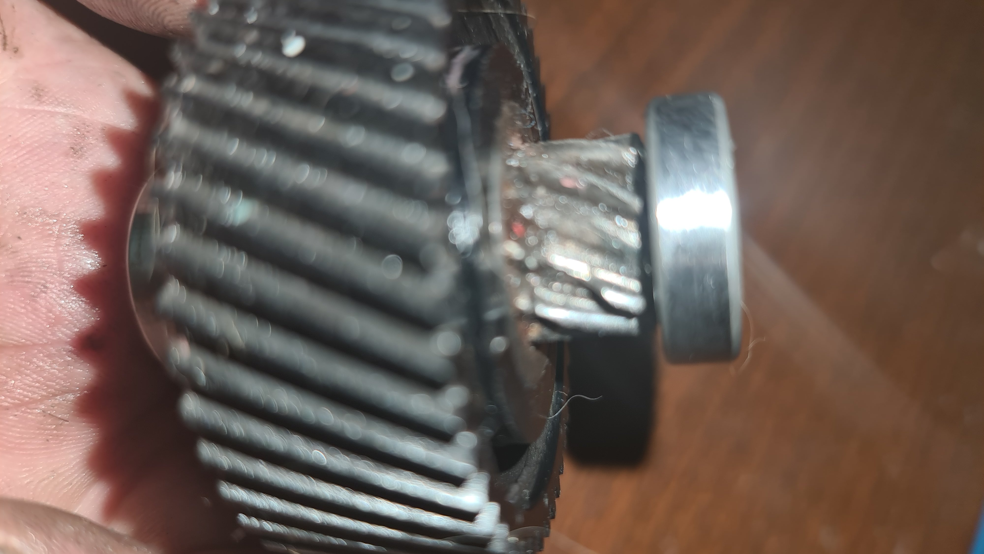

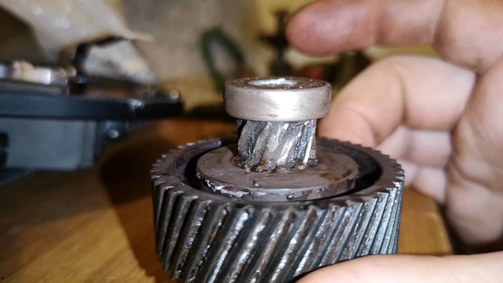

I have a Husqvarna Mc6 2019 with a Steps E8000 motor. It started making strange noises intermittent until the whole motor assembly started rattling and vibrating. Could not move the bike backwards because the whole unit locked up and it only drove like 1/4 of a turn until it stopped assisting completely. Opened it up just to see that the smaller cog on the first intermediate axle (right after the motor axle) was missing 3 teeth. Shimano won't look for any spare parts because their only answer was "you do not disassemble these motors!" (what a consumer world we live in!)
So to the question, would anyone have a spare motor with some other problem that could provide me these 2 intermediate axles (because I'm anxious that the large cog on the second axle may have caught some damage too) so I can get it running again? Or do you think it's repairable through welding and grinding by a specialist? Maybe someone's sitting on a used unit that still works?

Fuck me that looks nasty :oops: Question is where did all the ground metal paste go?
The bike has done 8200km and has a chip installed since one month after the purchase. Maybe the rpm's inside the motor assembly is too high when you run them limitless so all the grease is getting flung to the sides?

8200km in 4 years? That is a lot, to be honest I'm surprised the motor lasted that long ...

What does the mating gear look like ? It has to be trash also
What are you willing to pay . I have those parts
to be honest, I can't see any deformation on any teeth at all, it does have a bit of play (like, it can wobble) on the axle and I'm not sure if that's okey or not. So maybe I'll replace both of them just to be safe. Let me send you a PM for price.
