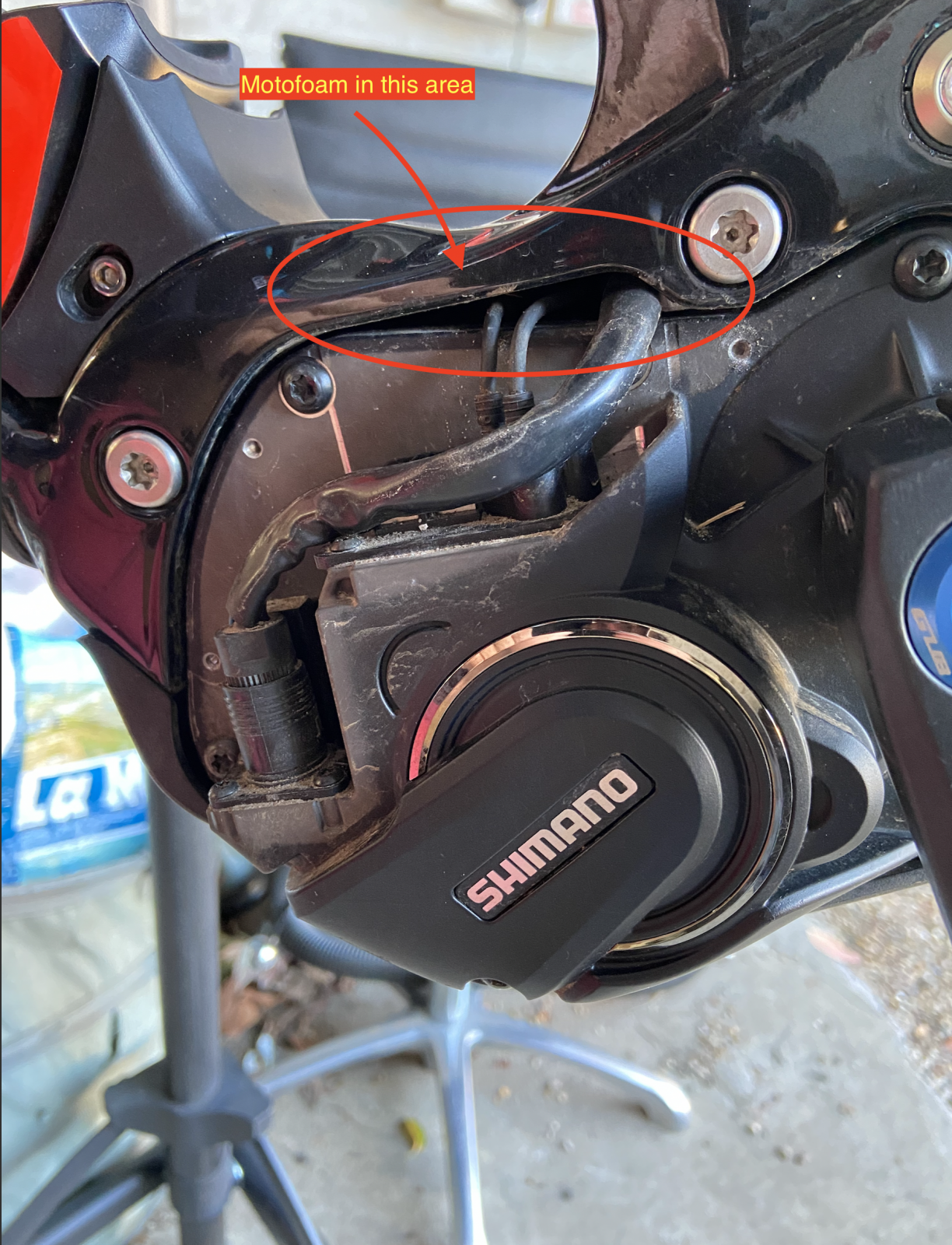

I see what you have done there, but I think crap would still get down that, and though the back - it tends to get stuck where the cables go above the motor.
I dont actually think its a massive issue, as long as you are aware that stuff gets in there and clean it out. The main place collect is between the frame and the motor, where the cables go in, putting some motofoam in that area stops this, but its easy enough to clear out, unless you never do it over a winter and it gets jammed up.
This is behind my motor cover, opened it up the other day for the first time since Autumn as was pleasantly surprised at how little had got in there. My other bike I have moto foamed in this area, but not got round to doing it on the e-sommet. Lots of people have also taped over the edge of the cover with gaffer tape etc to seal it up

No. As R120 says, I wouldn't do it like that either.
It looks like you've made a nice wee collecting cup for crap to sit in
The important parts to tape/silicone/motofoam are the connector bay (silicone or tape along the top) and filling the red circled opening in R120s pic)
I have motofoam under the wiring nest too. as it stops anything getting through and between the frame and top of the motor.

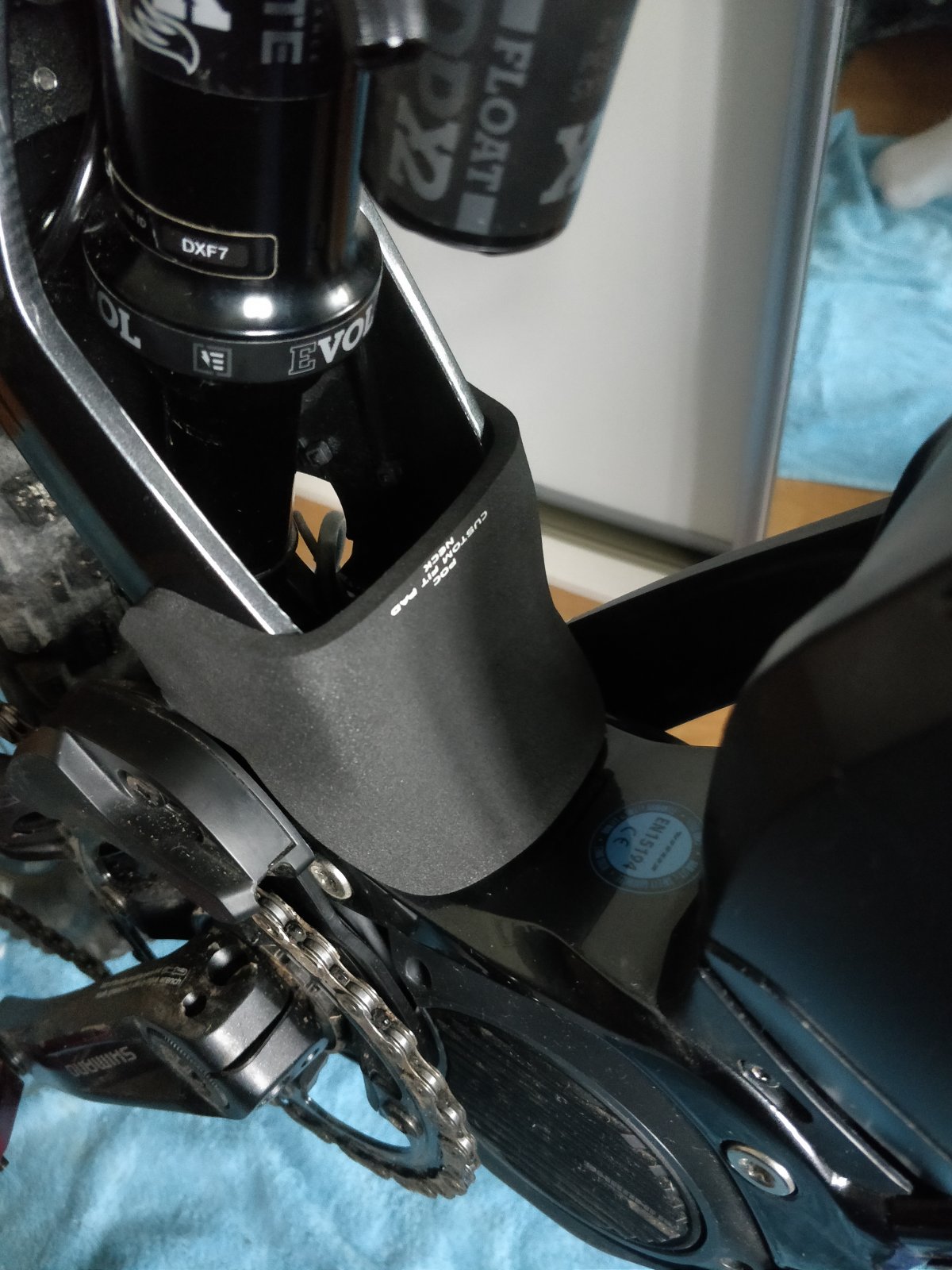

Just a update on this post. I've had a few goes at making something suitable to cover this section using different materials and I think I've got it as good as it can get.
5mm foam cut so size and also cut around the shock mount. This seems to keep any crap from getting in from the rear wheel and doesn't foul the shock. Silicone at the front so that it can be lifted like a flap if needed.
I was thinking about silicone all the way around the edges but I don't think its needed as it's a pretty tight fit.
Hope this helps ?
