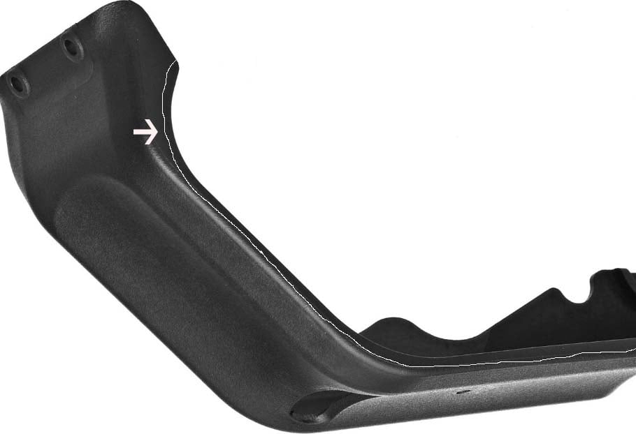

From what I’ve read then mounting points are the same but the engine casing is a slightly different shape so you have to dremel the side of the guard, unless they’ve changed it. Thanks again :-)

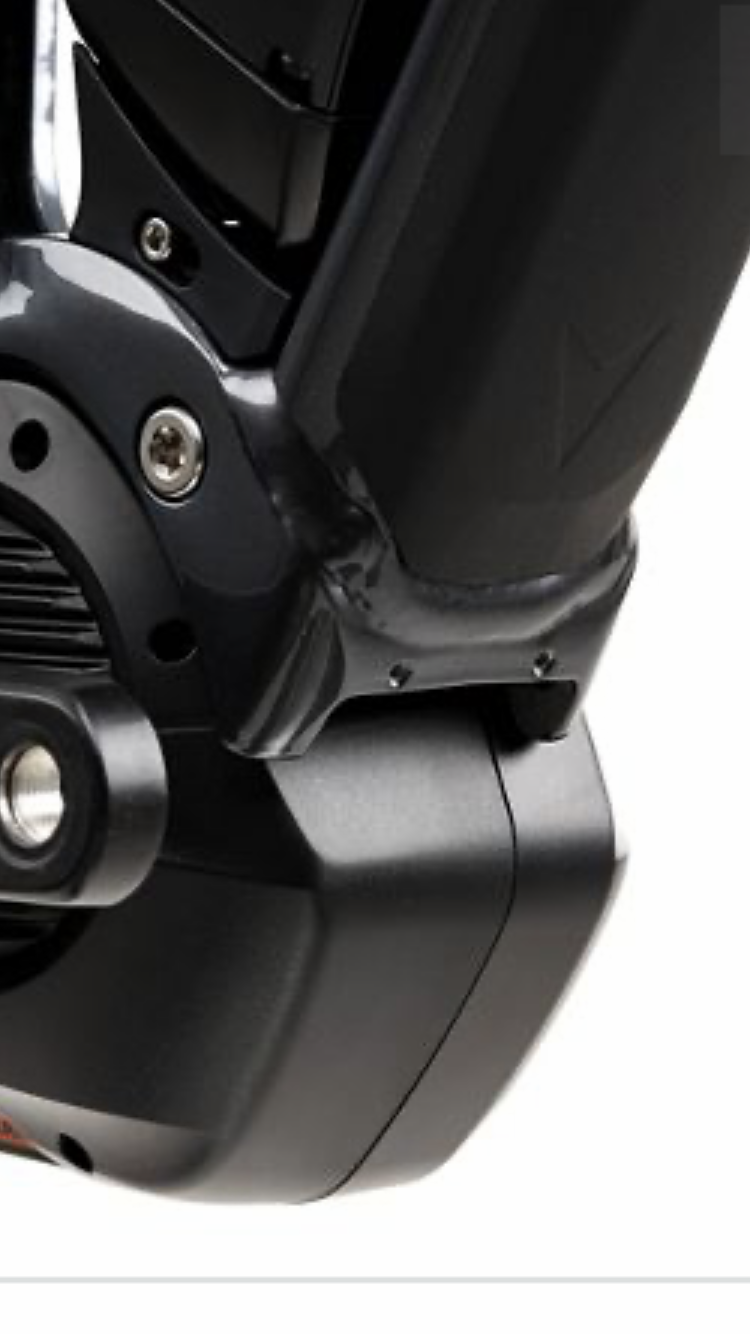

I thought the E7000 Es0mmets didn't have the two mounting bolt drillings ?
these ones?
Yes. those.

It will fit but you have to take this edge off. I used a grinder but a dremal would be better. I use a rockguardz as I'd already ordered it but the original for £8 works fine. The bike already comes with protect ion for the down tube.

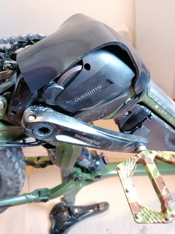

I have an E-Sommet 2020. I made a bashguard with 3mm Kydex. Really easy to do. Just put it in the oven, slap it on the frame and shape it and voila! Kydex is really good for impact protection compared to ordinary plastic
I will probably make one a little more stylish but this was the first attempt :) .
. View attachment 28743
That looks like it’s worked really well. I will have a look into getting some ?

Where did you buy that piece?
Yeah, I'd go for the mk 2 more stylish effort ????
