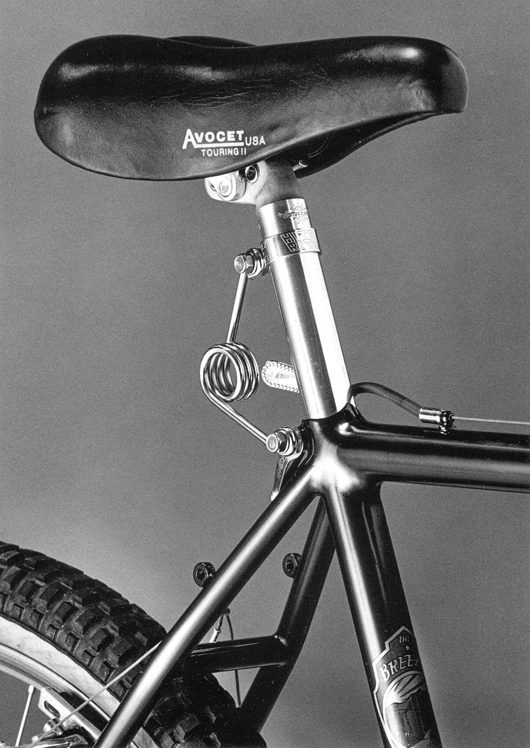

markloch
May 14, 2021
124
117
NorCal
"Clearly, you are a visionary"
Except for this nifty device Breeze came up with:
