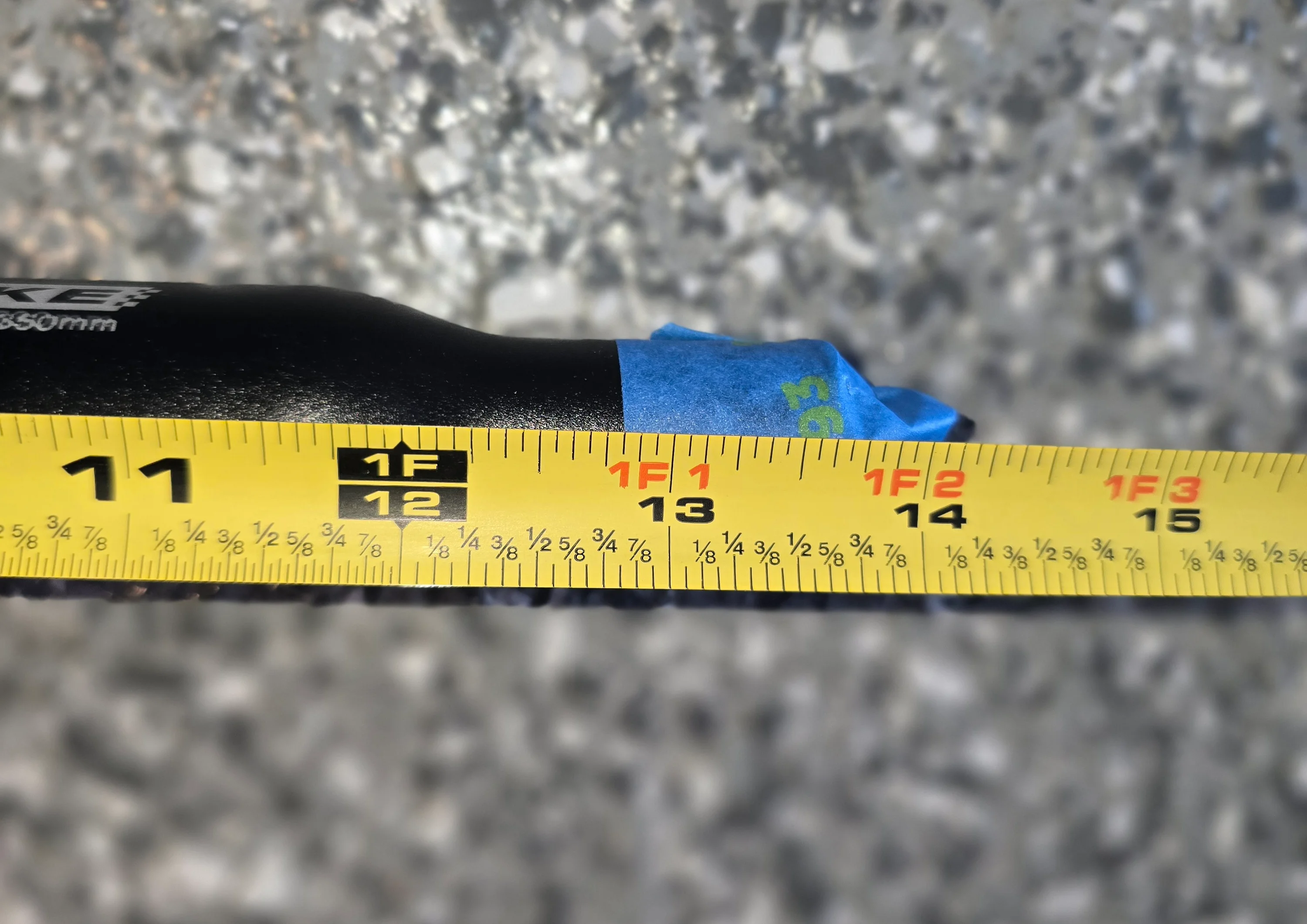

By chance do you know the insertion death for the dropper on the large wild?
I've looked online but have been unable to locate it?

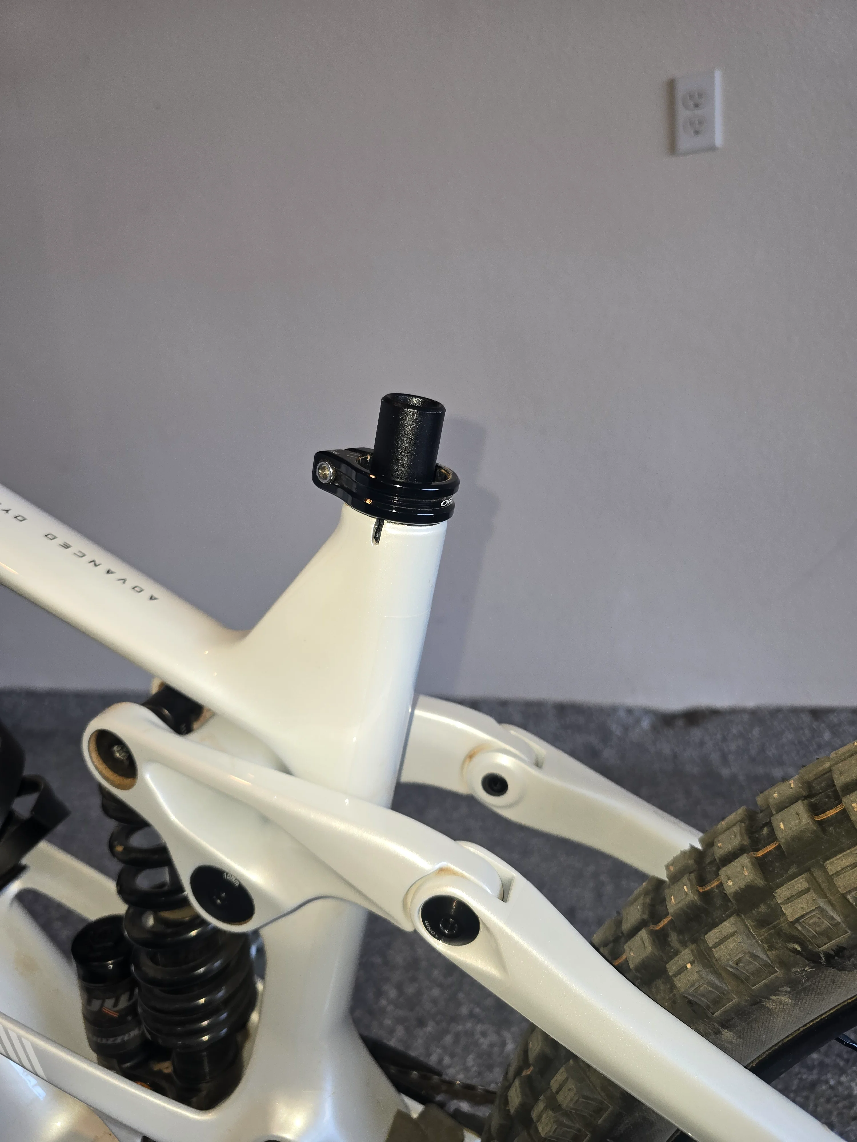

I don't know off the top of my head, can check a little later using a regular seat post I utilize when attaching my bikes to a mechanic stand.

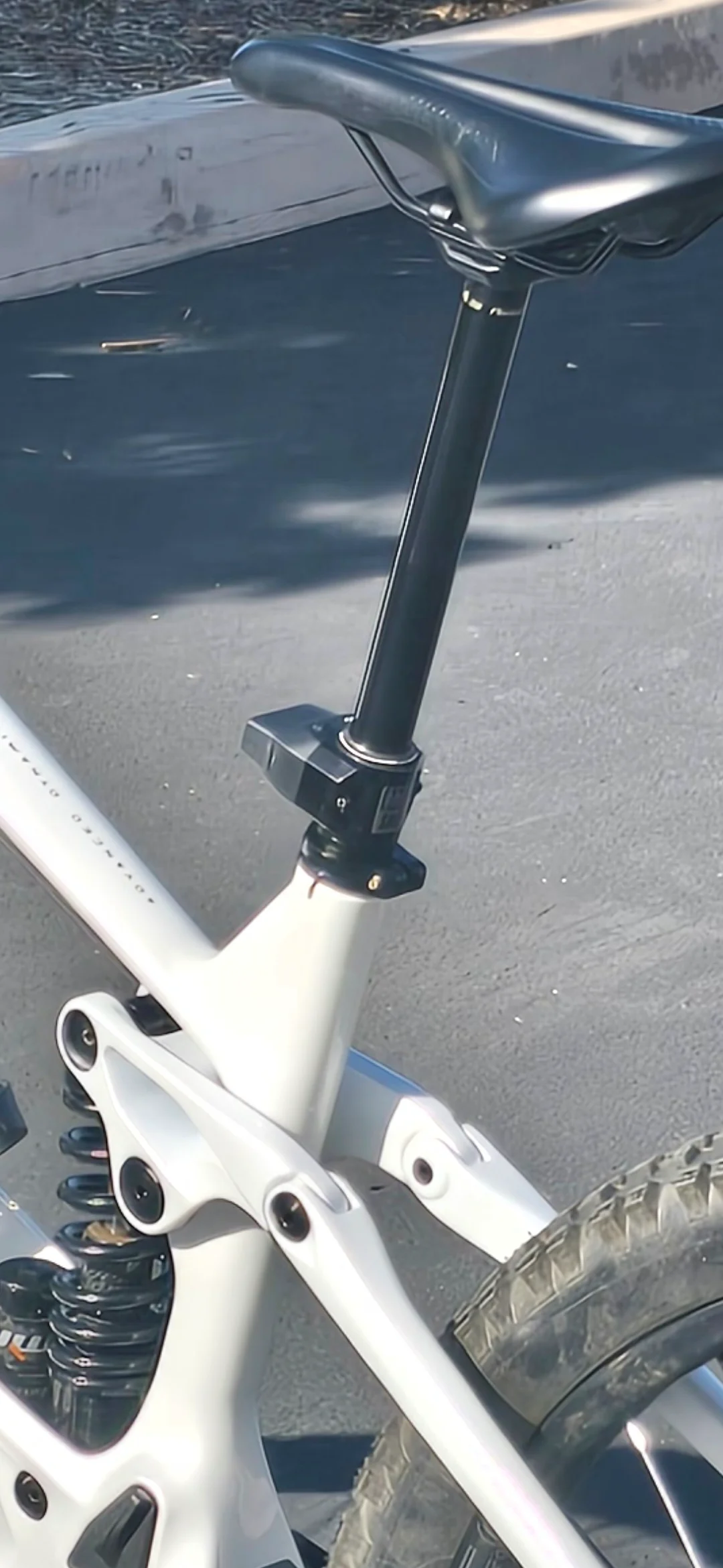

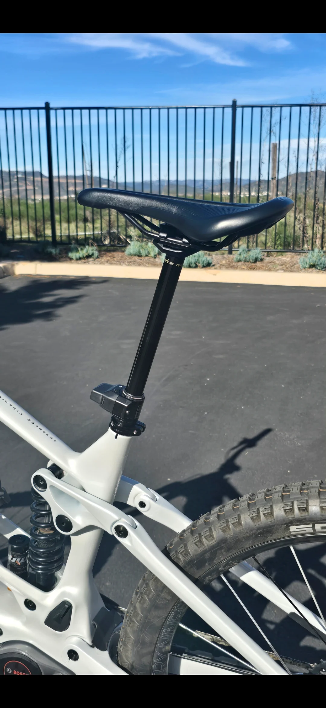

I just installed a 200mm Rockshox AXS B1 dropper and it goes all the way down. I am ~6' 1"/32" inseam and run it almost all the way slammed.
Thanks so much for that info. Super hard to track down actually.
I'm shaped weird I guess and I also run SQ lab saddles which have a very short distance from rails to seat surface. I run a 210mm Oneup on my current Relay with 165mm cranks, and I'm only 5'11".
I'm wanting to see if I can squeeze a 225mm AXS on my incoming Wild.
MInd if I ask what the distance is from your pedal in the farthest away position to the top edge of your seat? I'm at 35 1/8".

@Singletrackmind's measurement of 320mm insertion depth on the Large Wild should theoretically accommodate a 225mm AXS (which has roughly 290mm insertion requirements), but the real question is whether you'll have enough adjustment range once it's fitted.
The pedal-to-saddle measurement @Singletrackmind offered would be genuinely useful here. That's the critical dimension that tells you if the extra 15mm of drop from the 225mm will actually be usable, or if you'll just end up with a longer post that can't go low enough to matter.

The Large Wild has a 435mm seat tube, with a 320mm insertion depth.

One thing worth noting: that 320mm insertion depth measurement from @Singletrackmind is the practical limit he found, not necessarily an Orbea published spec. Your OneUp at 305mm insertion sits well within that, so you should be fine, but it's worth confirming with a bare seatpost when the frame arrives just to be sure nothing internal (cable routing, battery housing) gets in the way at depth.
It's 35 3/4" from top of pedal to top edge of seat.
