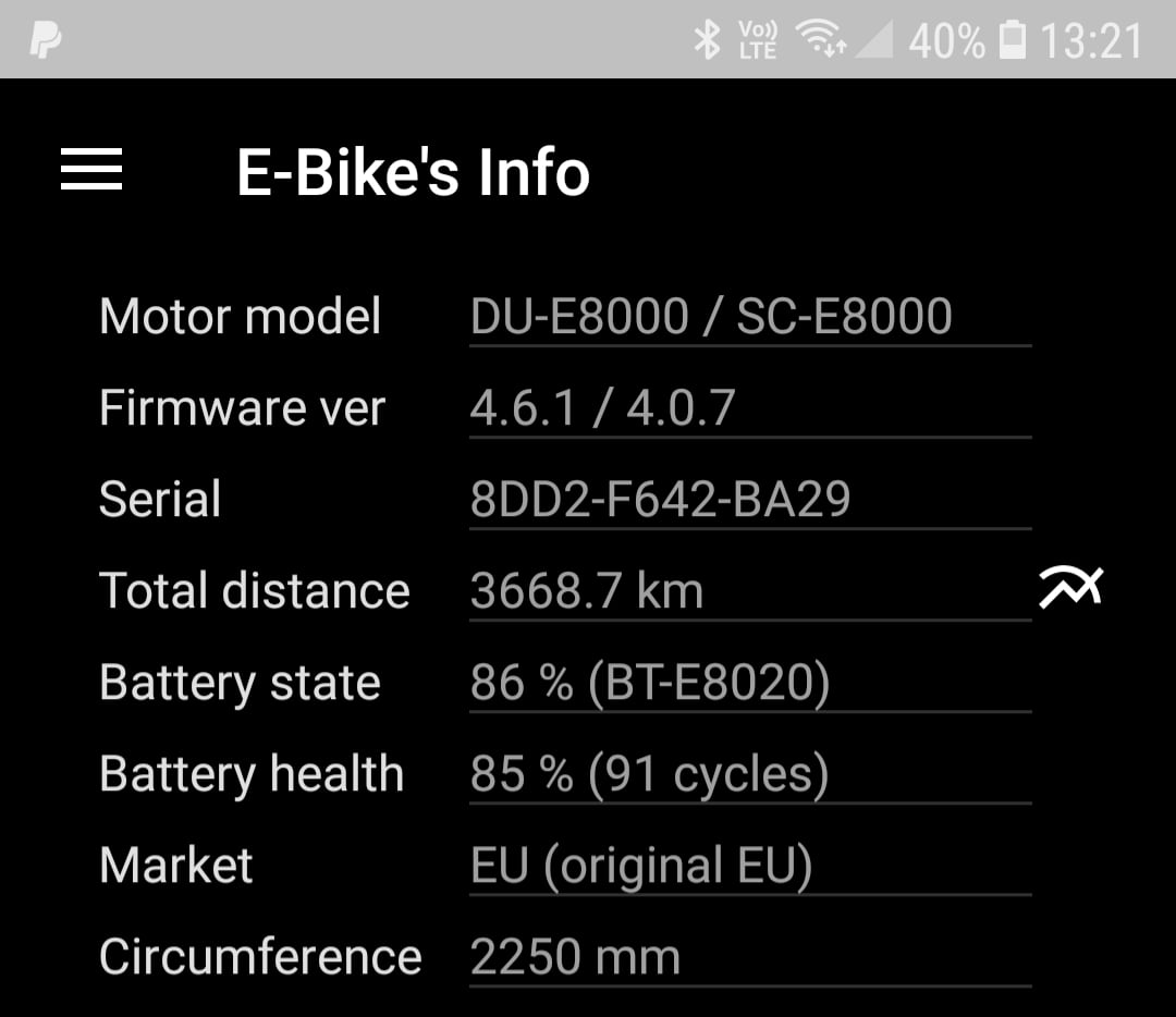

i`ve always recharged shortly after returning from a ride when i was riding weekly but my last ride was november last year so it`s been sitting for almost 2 months all full charge. what`s puzzled me though is that the estimated range in eco on 100% has always shown 52 miles but when i checked a couple of days ago it`s dropped to 44. i put it on charge (i realise now it probably wasn`t the best idea) but range still showed 44. is it normal to drop as much as that so quickly?
i`ve discovered stunlocker thanks to this forum so attached a shot of the battery data,not sure if it shows good,average or bad stats.
2 months at full charge isn't a great idea. Not good for battery health. But you really need to ride it before you can tell if range has dropped. The estimates on the bike are pretty poor and I don't personally trust the data shown by STUnlocker (not sure how it's reported to the app from the battery) is a real indicator of range either.
Strongly suggest you move to charging battery the night before you ride.
Gordon
When I had two Shimano E bikes and each used the same 504wh external batteries. Stunlocker would give me a different battery health % for each bike. One showed as 100% and the other 92% and if I swapped the batteries between the bikes the health %s would remain the same for each bike. So yeah. I've no idea how it's reported to the app either but it's definitely not accurate.
