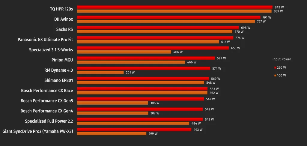

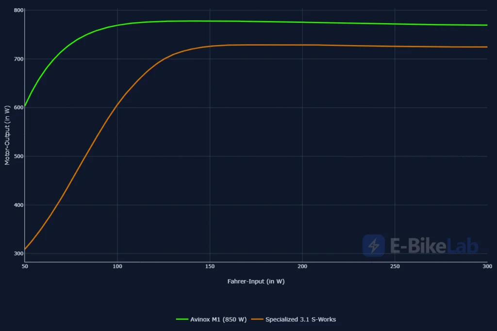

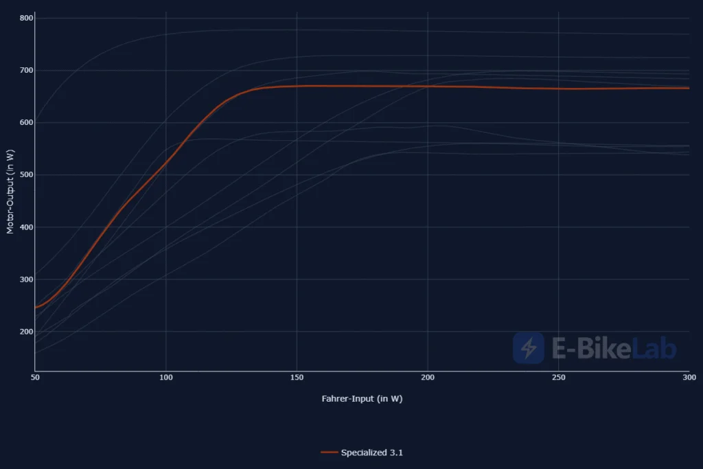

Thanks Greg, what is the Levos "meaningful edge elsewhere". Saying its better suited to riding somewhere else?
I just switched to the Levo 4 Turbo Comp (Size S4) about 6 weeks ago (Before they went on sale :-( ).. I think the same bike you are looking at. I came from a Giant Trance X Advanced E+1 (Carbon frame). I am 5'11", 205lbs. I started at about 240lbs on the Trance (:) ). The Trance and the AmFlow are longer chain stay bikes than the Levo. The Levo is also a mullet (Which I think the new AMFlows are too). My friend has the original AMFlow with the M1 motor. We both got our bikes the same time. We ride a lot of steep up/down stuff. The Levo has way more power than you will ever need. I use Turbo mode less than 5% of my miles and mostly on the way back to the car when we are tired and just want to get back fast. Probably 80% Eco, 20% Trail most of the time. But most importantly for me, the Levo geometry is just slight smaller feeling than the Trance and my friends AMFlow. It just feels like the bike is part of my body on the descents and I am not fight the bike through flow, chops or rock gardens. My downhill riding has improved a lot with the Levo. You gain some bike weight with the Levo, but also 840w (levo) vs 800w (AmFlow) battery. And I don't know how the new M2 will use power vs. the M1, but my friend (who is a stronger climber than me) and I often come back with the same (within 1 or 2 percent) percentage of battery left.
My point in all of this is you should ride both bikes downhill, flow, chop, rack gardens and see which one "fits/feels" better for you and buy the bike that works best for you on the downhill's. Both bikes will get you up the hill with no problem and comparable battery usage. Buying more power than you need isn't going to do you any good on the downhill, and will only marginally get you up hill faster but more than likely will just cause the front wheel to lift or rear wheel to spin as it is more power than you need to get up the hill.
