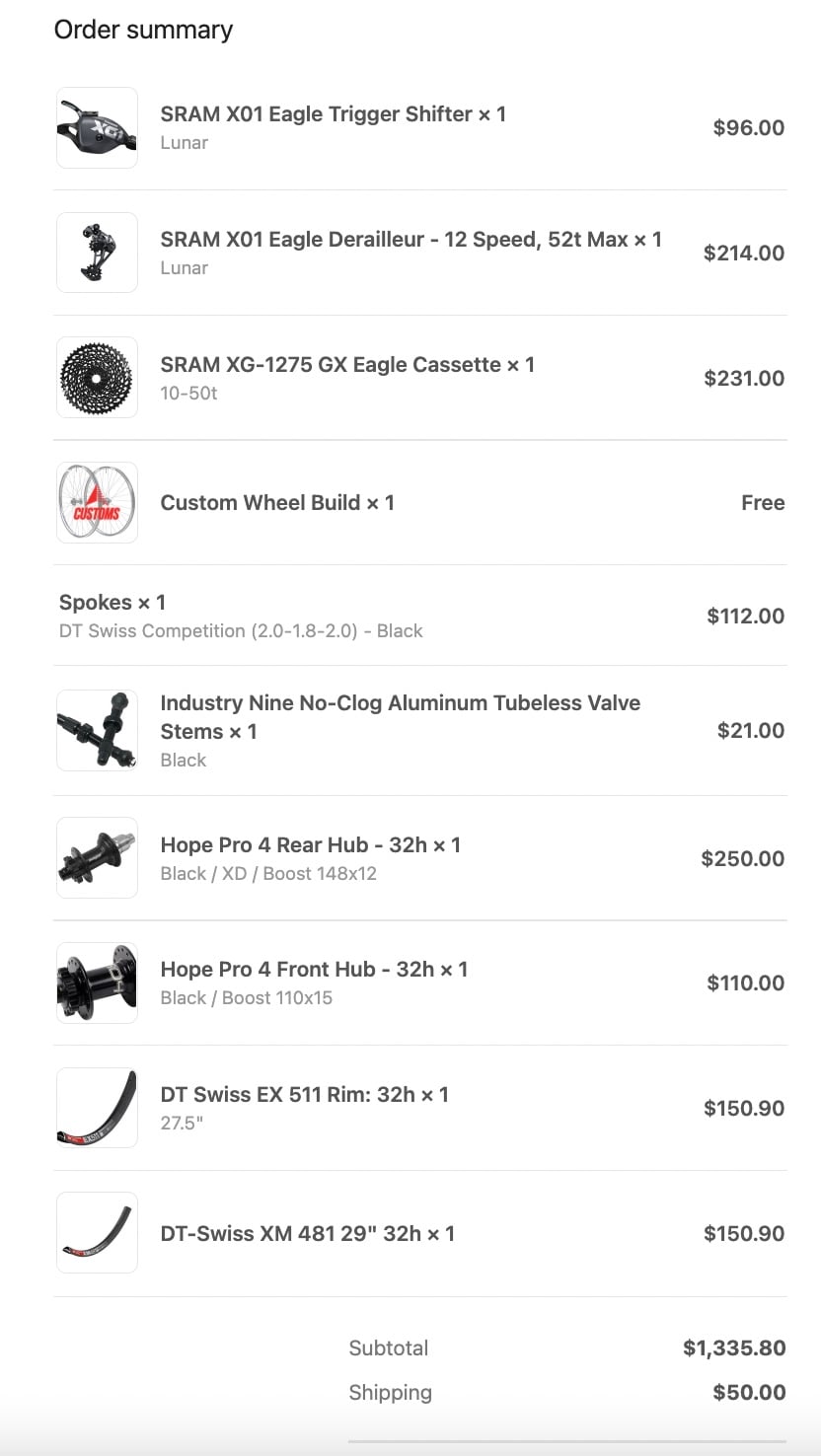

This is what I ordered... a custom set from The Lost Co. I ended up having to get a new cassette because the old one wouldn't work with the new hubs, and thus the current derailleur wouldn't work either. I had been considering upgrading those anyway, so just as well.
I'm prepared to order up another cushcore (or two); I just need to know that they'll work. As for my riding conditions, it will vary considerably, as I travel fulltime in my RV (I work remote). Right now I'm in Montana, so lots of loam, tree roots and some rocks. But in the winter, it'll be desert areas with lots of loose, sharp rocks, etc. Singletrack whenever possible. Bike parks eventually. I suppose Enduro more than XC, but I've been liking the term, "All Mountain."
In the last couple weeks, I've changed my rear shock to a Fox Float DPS Performance (all the "better" ones were all out of stock) and a Zeb Ultimate (2022 model; it was on sale). Huge improvement all around.
We have a similar wheel setup on our Levo SLs and have had no issues (EX511 front and rear). Some would argue there is no need for a 12 speed setup as it just adds to the cost. Enduro vs, All mountain implies the emphasis is on the DH part. I probably only use 7 gears on my bike but I don't do XC. Depending on which bike you are riding, how much you weigh, which trails you are mostly riding, how aggressive you are on the bike and what tire pressure you prefer, some would say to put a Assagai DD MaxxGrip on the front without Cushcore if you are changing tires a lot and find it frustrating. It does get pretty easy after you have done it a bunch of times!

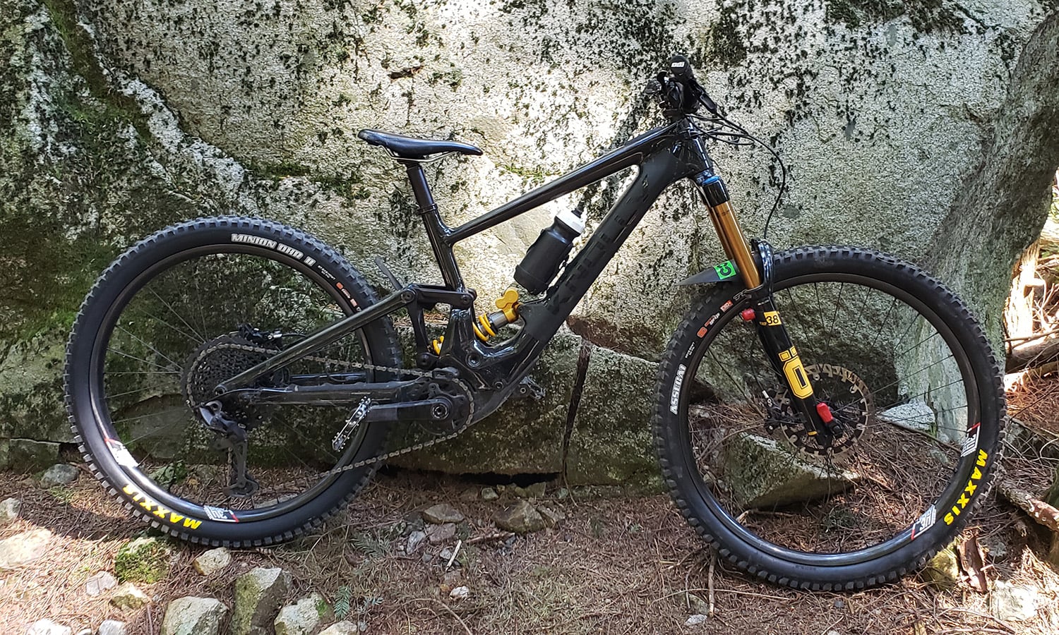

I just noticed your pic in this post. What bike is that? Looks amazing.
Thanks! Its a mulletted Kenevo SL in stealth mode. I am still not convinced I can ride it $6,000 better than the Levo SL I have been riding for the past couple of years but as I keep telling my wife, the more I spend on it, the better IT has to get!
I thought the frame looked familiar and too straight for a knolly. I hadn't heard of knolly going eeb yet, but I did get excited for a moment.
100% those upgrades will make everything faster, because science. At least that's what the marketing teams tell us.
Really nice looking set up though.👌
