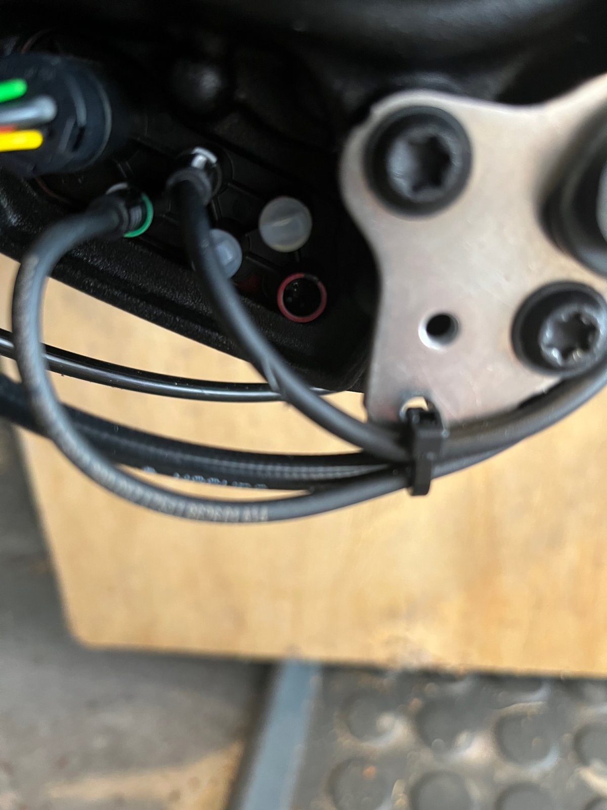

Yes, I have the same issue. They have changed the Ports on the motor to a round shape, see the picture of my motor. I bought a rear light from a local dealer, well it was eventually shipped from Germany weeks later. Stupidly I took over an hour threading the cable though the mudguard into the motor, not easy and placing rubber seals, only to realise the plug would not go in (square with rounded corners). I was told they have no clue when or if lights would be available. The only solution is to buy an additional cable with the new plug and solder it onto the light, a further £15 or so.

I know it's pretty poor, my local dealer didn't know until I took my rear light back in and showed him the picture of the round port. It's a pity because the Cube rear light is such a neat solution in the mudguard. I did find what I think is the right cable, made by Lupine who are more on the ball than Bosch as lights are their business. It's a BES3 connector and says its for '22 Bosch motors on their website. I don't have too much of a need for the rear light as I am using the bike mostly off road. I just think to pay £13 plus postage for a £20 light that should have it anyway is a bit much. Plus I wouldn't want to buy it and find it doesn't fit either.

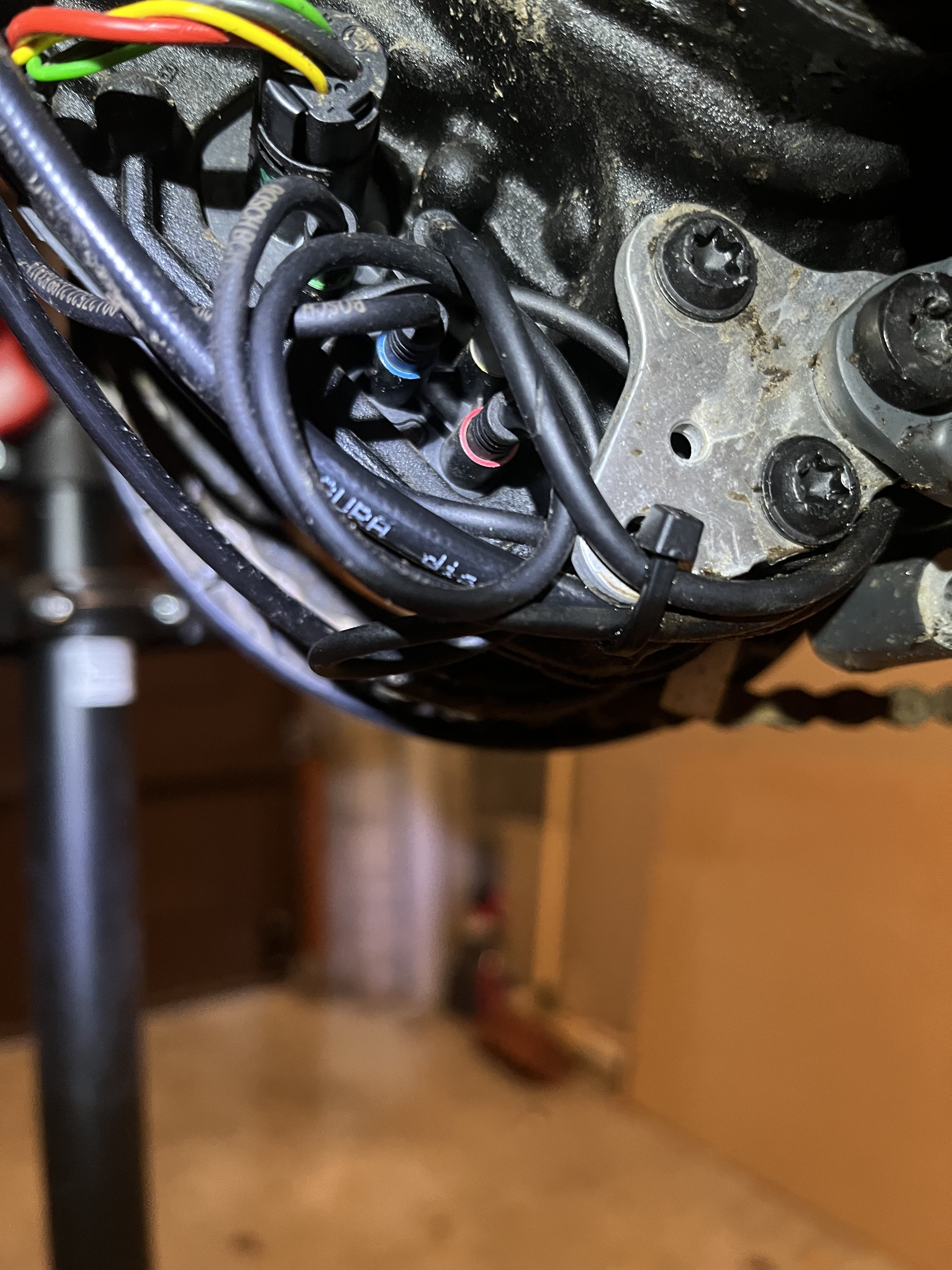

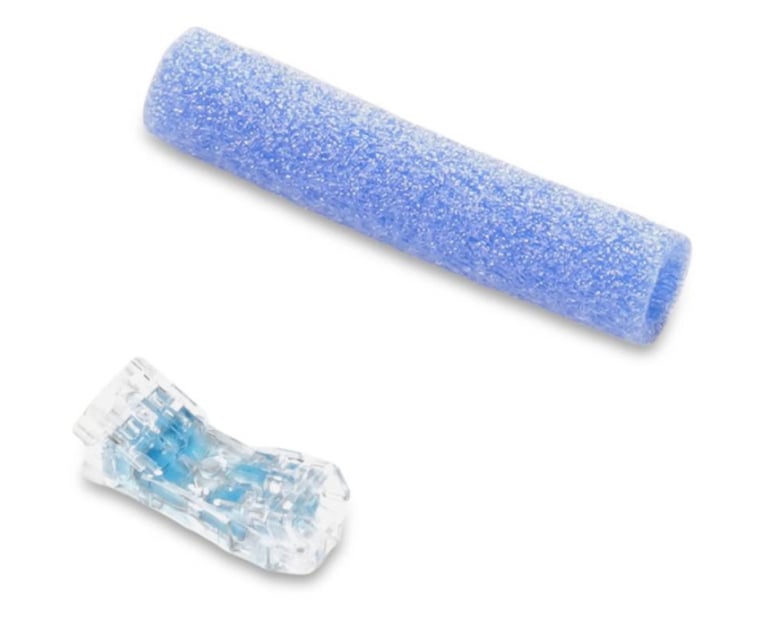

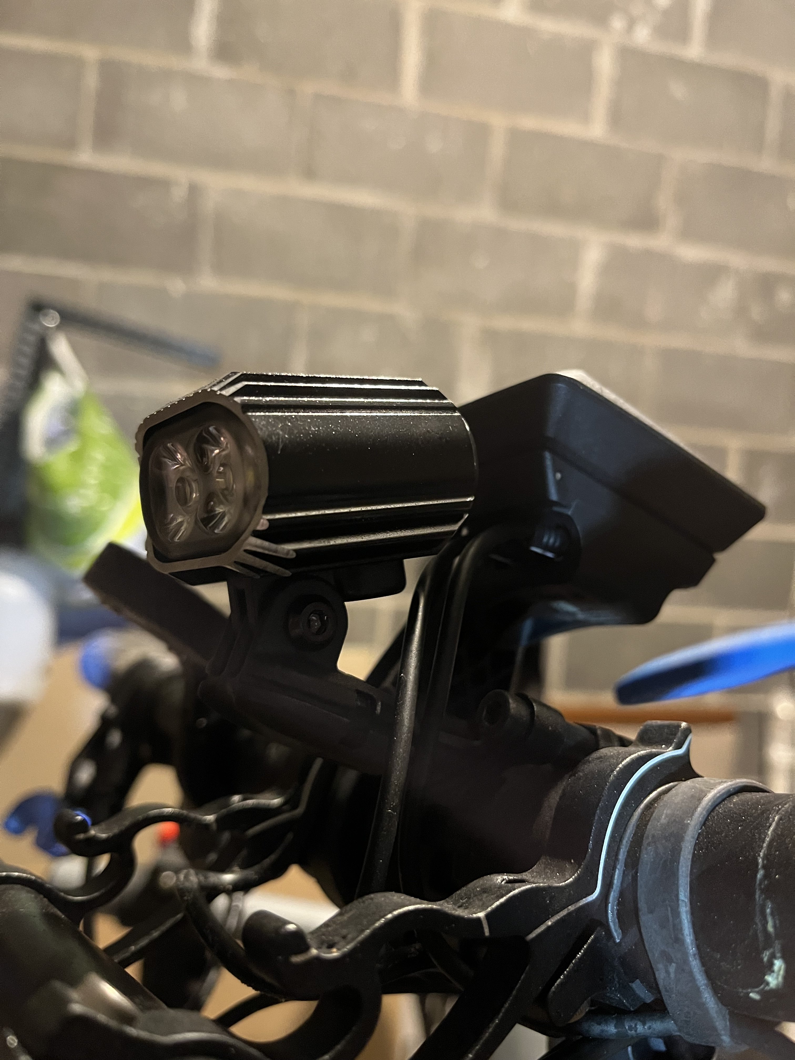

Thought I'd better just close this out as I have finished set up. Thanks to sipaldi for the heads up that the rear light was available. I ordered one and received it in December, No front light was available at that time (backorder) with the BES3 fitting. I didn't want a standard light anyway, I keep my eBike in Scotland for Bike/Hiking so I wanted a more powerful front light for off road but also with an ability to just have a flashing mode when on road. The std Cube lights didn't seem to fit the bill. I bought a Lezyne eBike Macro Drive Front Light. I then had to buy a cable with a BES3 plug on it, blue for the front. I managed to get one from eBay. It was quite short, so the joint is just behind the bottom battery connection, but that's all I could get. I soldered the wires, remembering to put the heat shrink tubing first Ha Ha. Slightly awkward as the Lezyne & Bosch cables were different diameters, fortunately I'd bought one of these sets of Aldi that has various diameters of heat shrink. Bought in the middle of aisle in the hope I'd use them sometime, we have all been there? There is a spare cable conduit in the battery compartment to secure the cable, likewise inside the inner part of the Cube specific mudguard I fitted on the rear.
No BES3 front cable light was available from Cube, so my dealer couldn't order it, though plenty of EU sites have them.
I am happy with the set-up, no messing about with USB charging, the Lezyne defaults to the last mode, so ideal as mostly the lights are switched on for the road use. Rear light is neatly under the rack so no issues when loading the panniers and top bag for the overnights,

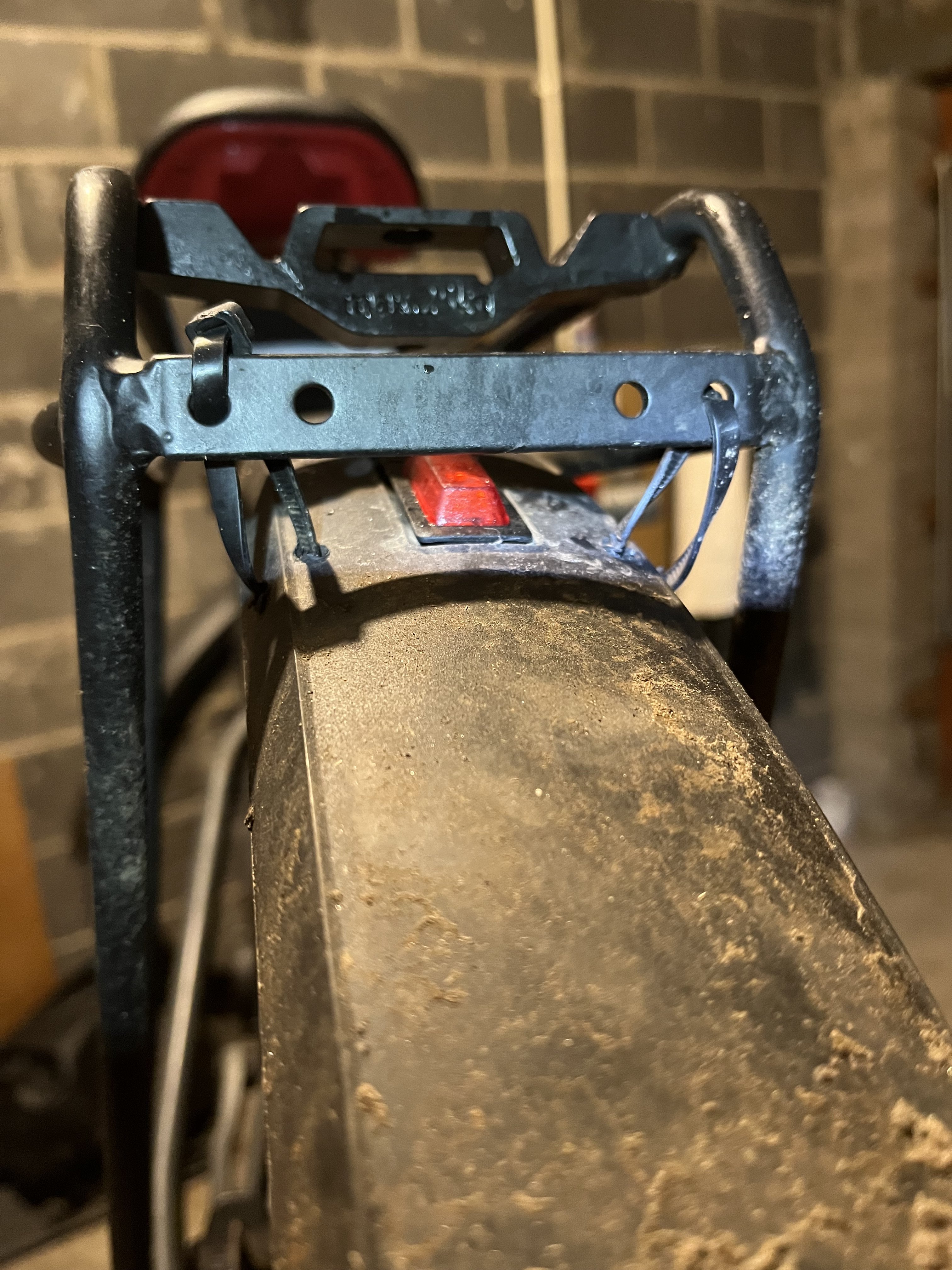

@JockG can you please post some pictures how the wire for the rear light is routed out of the frame and into the mudguard channel? I have just installed the Acid mudguards and I'm planning to add lights as well. Thank you.

Hi, Sorry I am away from the bike at the moment, but I might be able to explain:
I bought a Cube Acid MTB 75 Mudguard Set and an Acid SIC Pure 27.5in RILink Rear Carrier.
I wanted to avoid stays on the rear mudguard and this rack kit has a support bar in the centre that mounts to the rear bike frame/carrier/mudguard all in one. Its a neat solution though the very back of the mudguard rattled about too much on track, so you'll notice in the picture of the rear light I drilled a couple of holes in it and tie wrapped it to the rack, that works well.
If you look inside the Acid mudguard, you'll see what looks like a plastic pipe clipped on the inside. That's the cable guide. The pipe actually is slit down its length, pop it out. So once you mount the rear light you can just feed the wire into the slit, this overcomes any issue with the larger BES plug already connected to the light, it doesn't need to be fed down the tube. There's a hole in the mudguard near the bottom of the frame and this matches a hole in bottom of the frame leading in the motor. There is a solid grommet covering this hole in the frame that can be popped out. The mudguard kit comes with a grommet with a hole and slit. So again it make it easy for you to put this in place and keep the BES plug intact. I was mindful that the BES plug and the Acid rear light has some sort of o-ring seal on it and I didn't want to damage that as it seals the plug in the motor. Feeding the plug through this frame hole to the motor was a little bit fiddly. I taped it to a tie wrap and used it to feed through.
