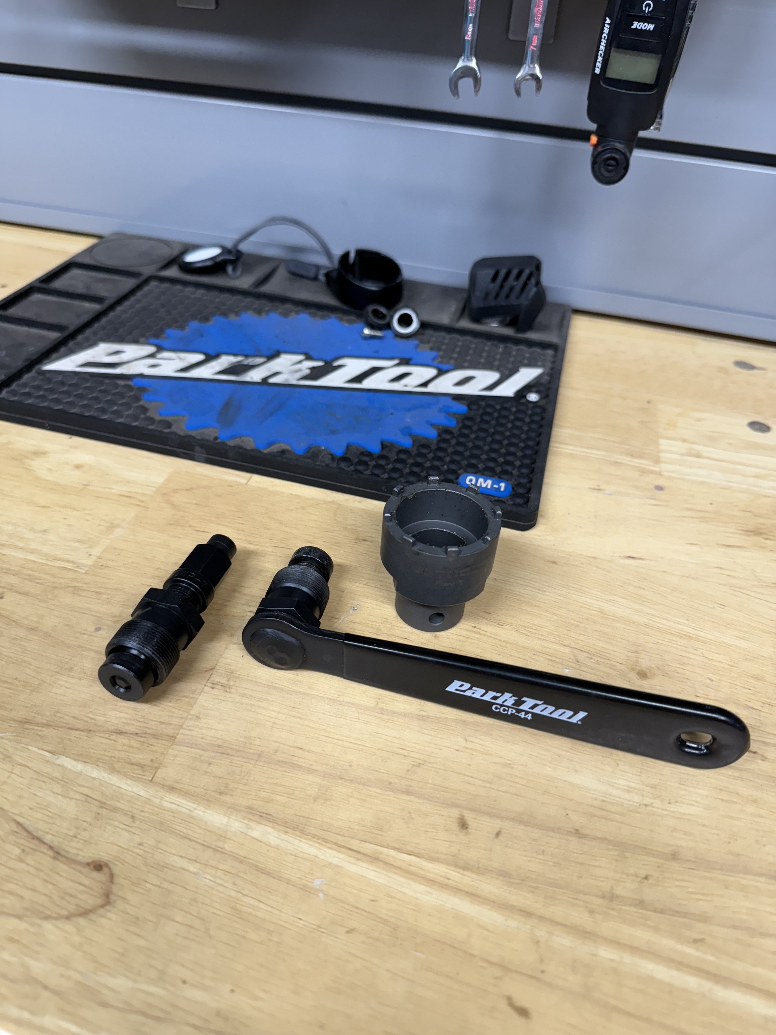

The crank bolt does seem a little high (50nm) but it is what it is? Beware of the metal O ring behind the crank bolt.
Some tools you may need besides the correct Allen wrenches.
