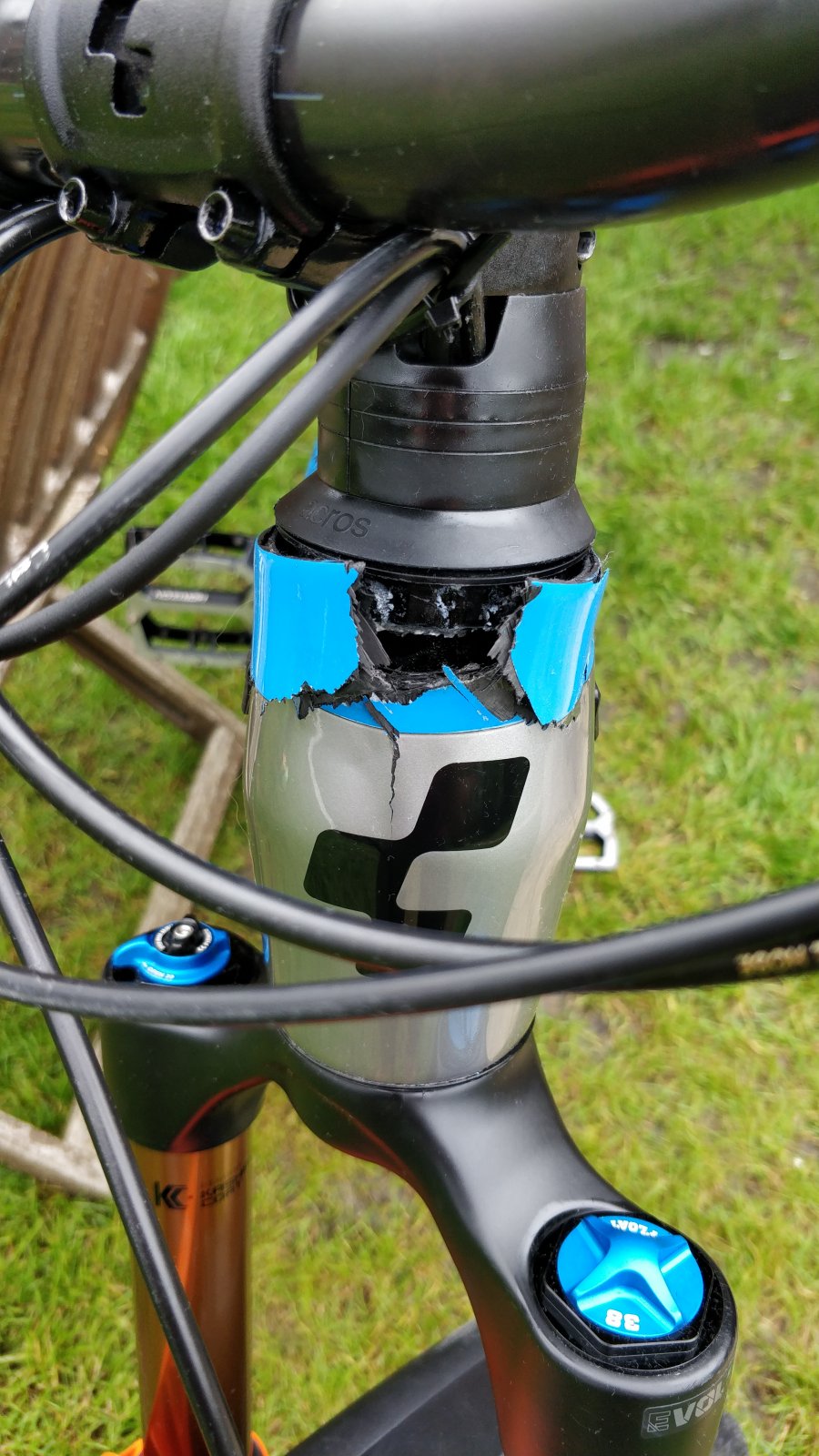

Cracked Cube-can you help?!
HybridCraig
Sep 12, 2021
7
10
2021 Cube Stereo Hybrid 160 Actionteam
Cracked upper headtube during normal riding for a bike of this spec, the bike has been with the shop for a month now, they inspected and confirmed that the carbon appears to not have been bonded correctly, also a hairline crack is continuing down the headtube. They raised a warranty claim as they agree the bike has failed in dramatic fashion, Cube are repeatedly saying they won't replace under warranty as it is external impact damage-meaning something has hit it, this is clearly impossible without damaging other components on the bike. Cube have made their diagnosis from photos-not from a physical inspection. They are ignoring the repeated advice from their authorised dealer/repairer, who continue to fight my claim for me. The shop believe Cube may need to inspect all of the models with this frame-i.e. recall them.
I've contacted Cube via their website-no response. Any good advice or similar issues with Cube from experience?

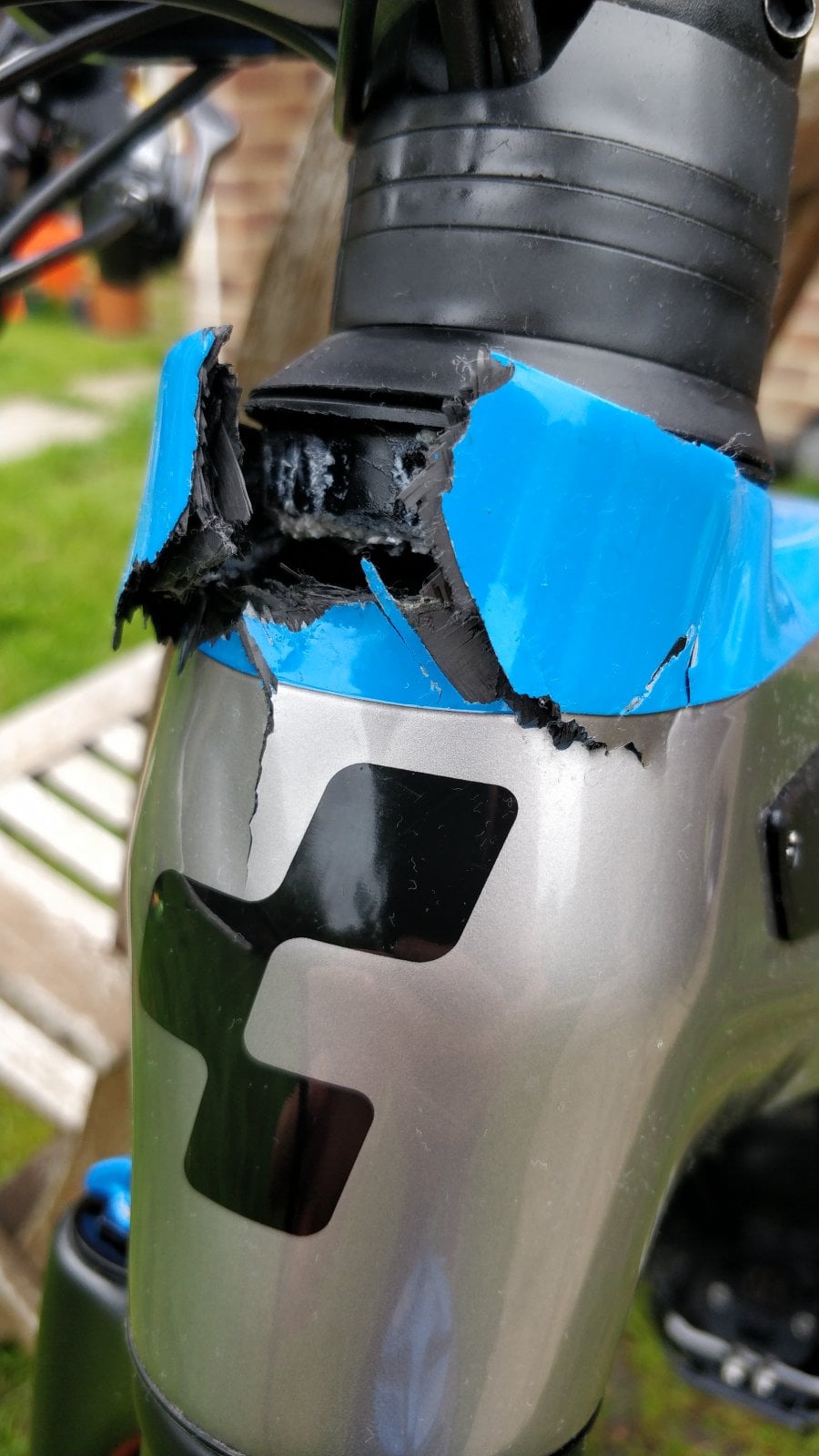

Can't help with the legal side of things, but that definitely looks like it's exploded from the inside out, rather than impact damage, the only other thing that could cause that kind of break would be landing on the front wheel vertically after a biggish drop-off, guessing that's not the case? And even then I'd expect the forks to bend or the front wheel to pretzel, good luck with your claim, don't let them fob you off (y)

Daaaaaaammmm. Did you run in to something that doesn’t move? Ground? Tree? We’re not cube here so don’t feed us some ‘I was riding normal tails’ shit that’s from a front wheel impact. Hope you’re ok.
Yea I'd agree with you if I saw this! But yea it went on a steep descent in the Surrey Hills. The shop confirmed the carbon weave looks poor in the headtube, have this in writing ?
Had other cube users confirm similar issues with the crack down the front, unfortunately I didn't notice that on mine!

Well buddy, the bike shop in writing is being your friend. I do like most bike mechanics but I’m afraid they’re not at the tech level or education level to evaluate carbon weave strength. For sure the carbon weave was not strong enough for what it met, on you r steep decent. Look man, compression pushes on the head tube in the opposite direction, so that can only happen from a head on collision and its dead in center so I’m glad youre typing and not all in a body cast!
That's what it looked like to me: impact at the front resulted on blowing out the head tube. But if it was done during riding, then it clearly wasn't robust enough.

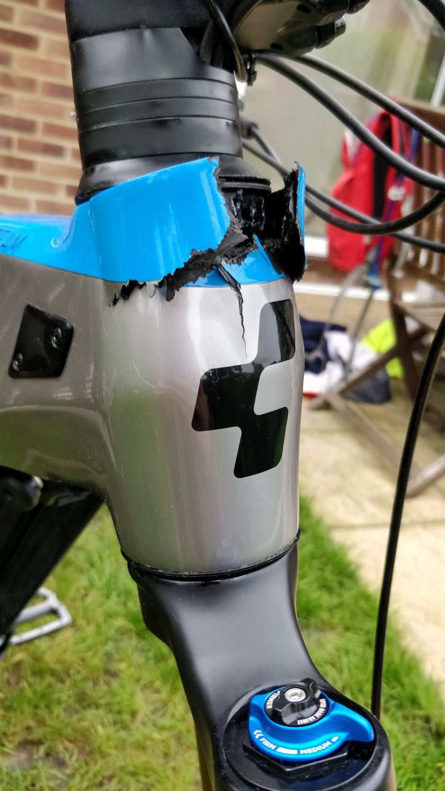

I can, I think, see why Cube have classified that as impact damage. The headtube appears to have a compression dent just above the left cube of the 3 cubes that make up the brand insignia. The carbon is also folded to the left of that dent. It is likely that the impact that caused that dent cracked the laminate with the rest of the more catastrophic damage resulting from the fact that th entire headest construction was then compromised and could well have exploded just with the sort of pressure imposed on it by a steep downhill run.

Carbon is immensely strong and can be laid up to be stiff or flexible............however neither type of lay up can resist a hard impact because carbon is brittle and loses all its strength if the laminate is damaged. Worse still, it is often not possible to see the damage and sudden/catostrophic failure results at some future stage.
A composite that includes glass or better still kevlar has better impact resistance but is heavier and kevlar is not easy to form into a moulded shape like a headset.
I use a lot of 100% carbon components for windsurfing and I know how careful you have to be with it. I absolutely understand it being used in road bikes but I would never contemplate buying a carbon MTB!!

Final update on the bike for those interested.
It went to Cube HQ in Germany, they inspected the failed frame and have replaced it under warranty.
It's now back at the shop waiting for me to collect-busy with work so hopefully I'll get it early next week.
Took some time but great Cube have honoured their warranty after inspecting the frame.
