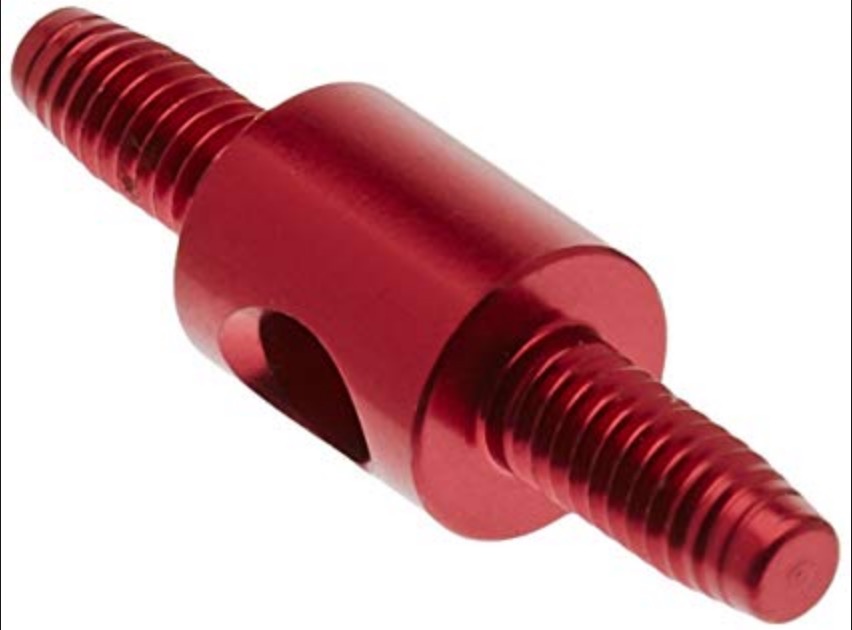

You can pull the brake hose through without dropping the motor although it's not a big deal.
I use the Reverb hose connector for this stuff.

I've managed to get the hose back up to the entry point in the frame since my original post and see the hose goes through a foam tube. I assume its for keeping the cable quiet in the frame. I guess the duct tape is not allowing the hose to slide through the foam. I've ordered a Reverb hose connector as suggested above and will try and "pull" the new hose up through from the caliper end when it arrives. That is if the Reverb tool isn't too fat for the foam..... in which case I'll be stumped again.
