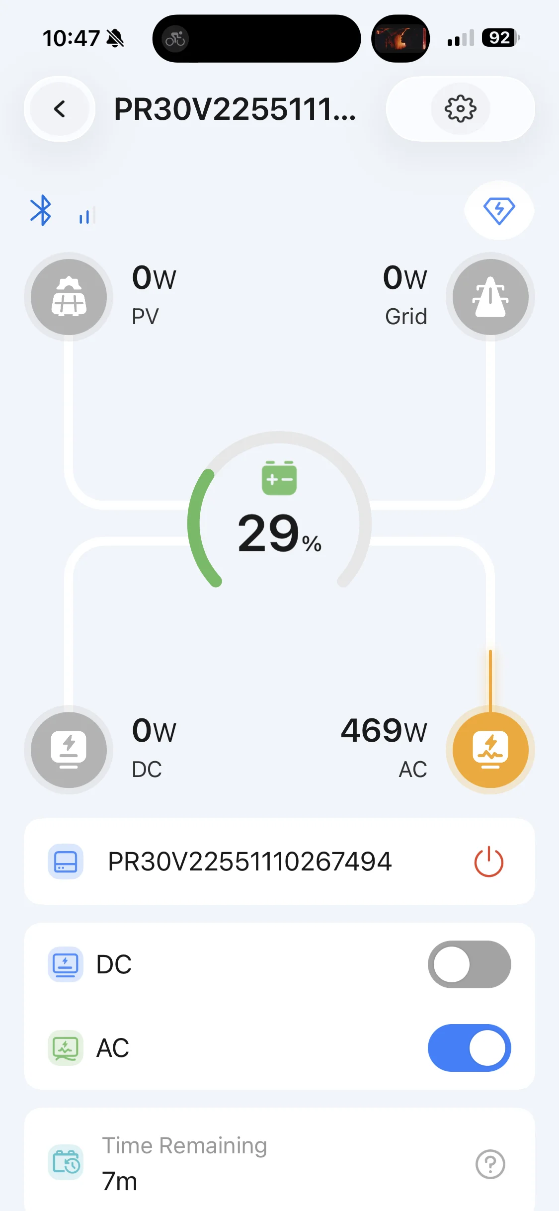

I'm using a "PECRON E500LFP 600W 576Wh" and while testing it with the 12amp charger at home and once out on the trail it has worked fine. Pulling about 330watts and about 1%/Minute charge rate. Now just yesterday I had just made a climb back to the parking lot, probably around 600ft of vert in something like 90nm/500watts and I plugged it into the charging setup. It would not charge. Kept tripping the Pecron. Bike battery was at 25%. Went home later that day plugged it back into the pecron and charged just fine.
Do you think the bike battery was on the warmer side causing the need for more watts? I know the 12 amp is suppose to use 508W max. Kinda weird. Thoughts?
Yes, warm batteries have lower resistance so can take more current whilst charging.
The charger should regulate it though, it’s the charger that ultimately decides what current the battery can have, so can only conclude that the charger was trying to give the battery more current than your power pack could deliver?
Whilst the nominal max watts demanded may be 508w, it could demand more on startup for a ‘hungry’ battery.
Probably what it was then. I would see the watts start to creep up on the Pecron then it would trip. That's the first time i've tried charging with that setup when the bike was "hot".

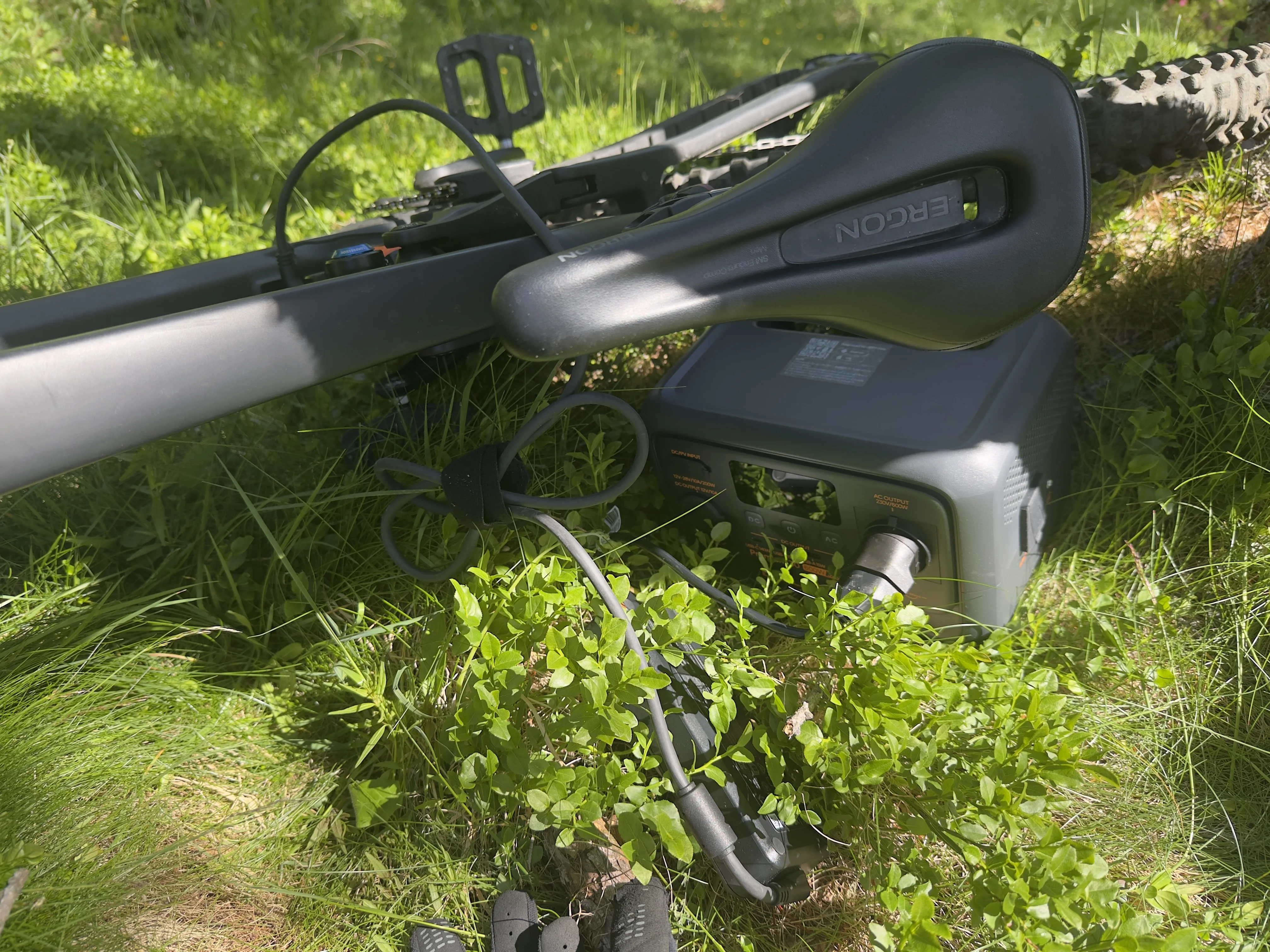

Charged mine with a Bluetti 600w from 50 to 82% after 780m elevation climb with the last 360m all in Turbo as it is a very steep climb. I did not wait, plugged it in right a way and no issue. I did charge at the end of that climb so at the peak of the heat.
It is strange that you mention 330w draw as mine was around 460-480w draw until 80% the when down to 420w for the additional 2%.
I confirmed again last night. Bike was at 15%, pecron 98%, plugged it in no issues. Pulling around 315w and did 9% in 10 minutes. Maybe the pecron was also hot sitting in the truck for a few hours? I hate to run out and buy a bigger one right now without knowing for sure if it's going to work or not.
I find the power station battery too hot a more plausible explanation. How hot was that day? Was the power station under the sun?
Avinox will delay charging or more slowly charge the the battery if is too hot, not pull above 600w, so it should not trip the power station
Btw the math does not add up as 315w in 10 min would equate to 6.5% (assuming 800wh battery).... and this is without the loss of the charger that is no 100% efficient so I guess it would be more like 6% and surely not 9%.
All the reports say between 410 to 490w so the 315w seems strange.

No idea. 600wh battery is what I have. The power station says what it says..... Both times I've used it, it was one percent less than how much time had passed. 15 mins net 14% and 10 mins nets 9%. Ill try again this weekend. The power station was in the truck in the shade and it was around 85 degrees out.
Ok then it makes sense as you have the 600wh battery, as 315w for 10min would make around ~8-9%.

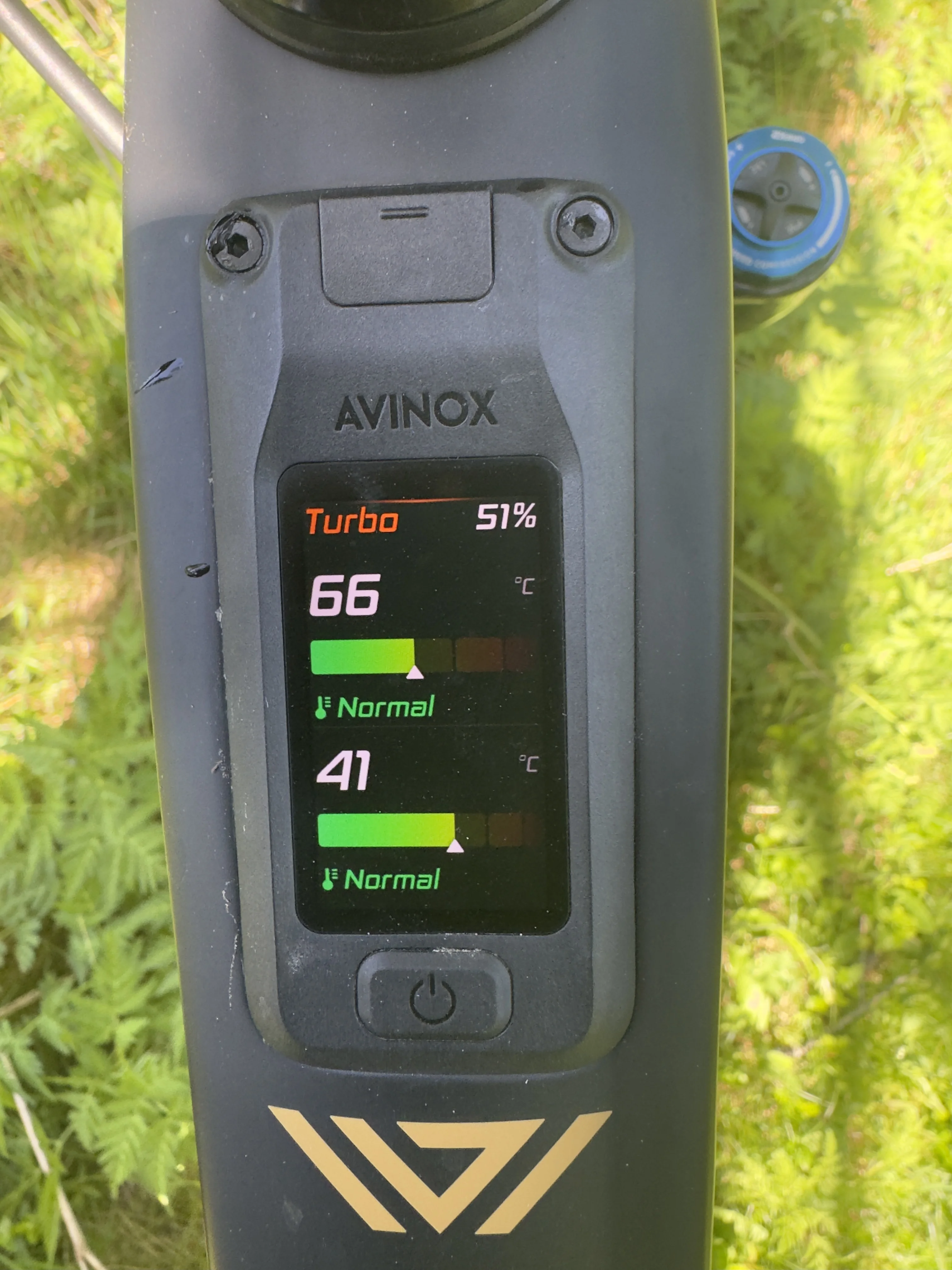

Btw you can add a custom display that shows the battery temperature on Avinox, it maybe useful to find the root cause
85 degrees in the shade should not be a problem.
