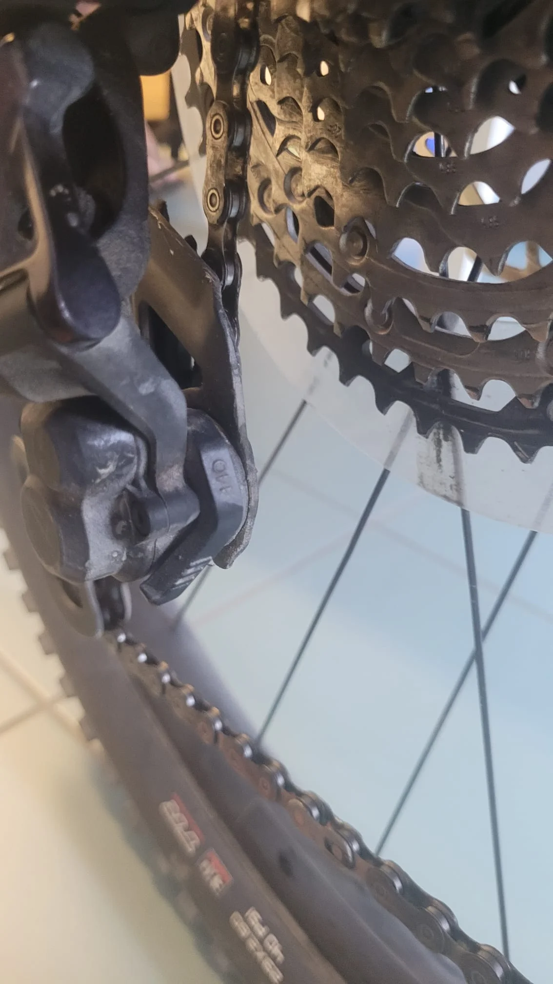

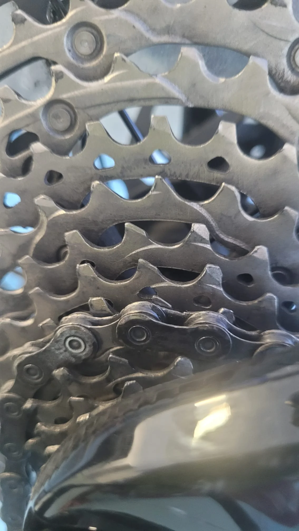

Chain skipping under load after bike service
2200km and the chain is skipping?
Not surprising, Sounds like a worn out drive train to me.
It also sounds like you don't have a very good bike shop. They should easily pick this up and suggest replacement.

My point was, your motor wasn't part of the issue of 'skipping'. Unless i'm very confused.
One other point, your rear wheel cannot be misaligned, you've got a thru-axle into a UDH, therefore there cannot possibly ever in any world be a misalignement there. There can of course be a wheel being untrue, or something else causing the issue, but not a misaligned wheel in the old context of a QR axle/dropouts.

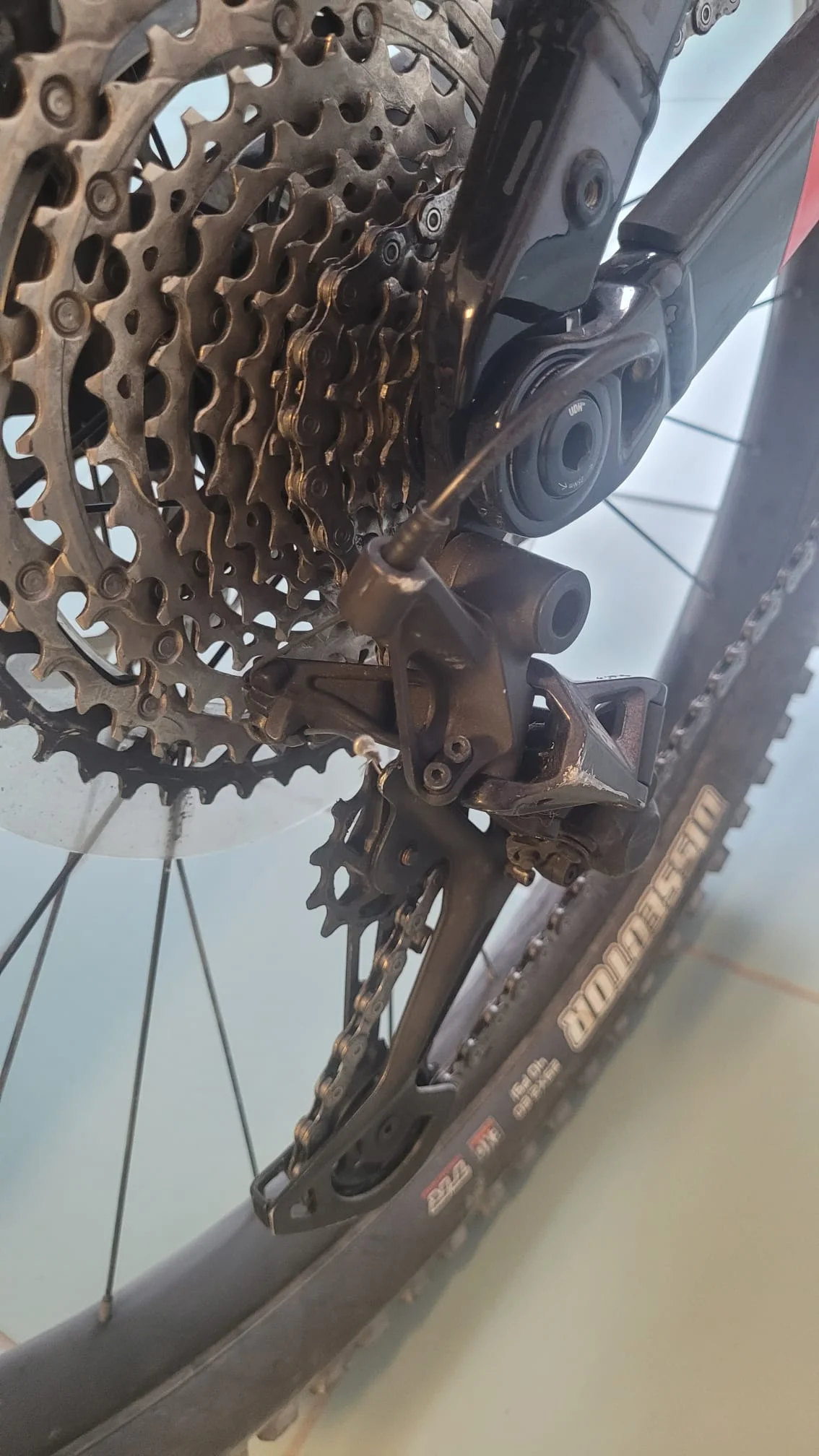

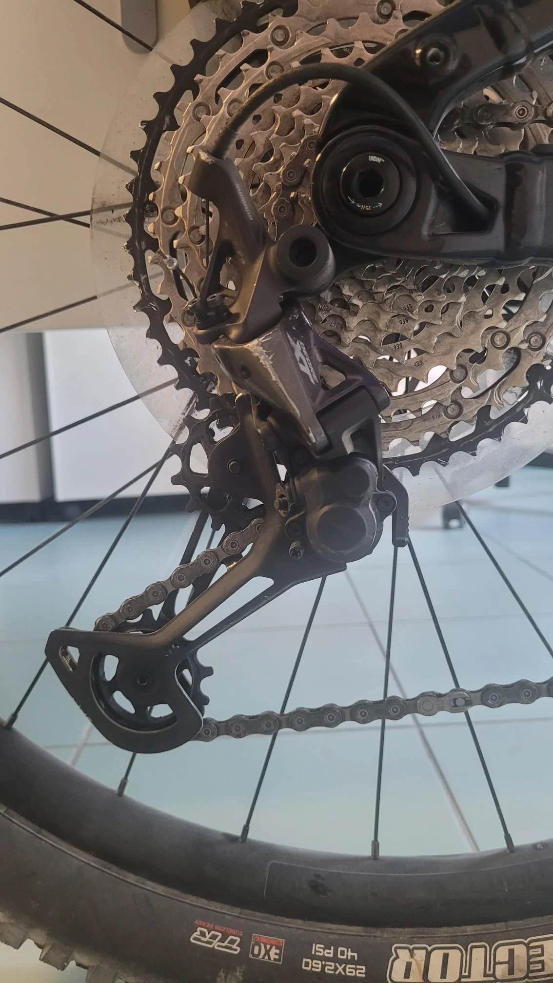

mate, i offered you a LOT of ideas, thoughts and suggestions as did everyone else. You asked what it could be but did nothing with the information anyone provided.
Look at the little cable end for example, if someone has serviced that drivetrain, that involves a new gear cable and a new end-cap, but that's not been done. Looking at your high and low screws i suspect they're both wrong too and you've been told about the B screw by multiple people.
You can google and check the B screw by putting the bike in the largest cog and checking what the gap it, either by eye or the little plastic tool... but you're not going to do that, you're going to take it to the same shit shop that did a shit job.
Guess how far back through the thread you have to scroll before finding the last time this guy was advised on how to adjust his B tension? Bonus points for who did that. That's right, DIS GUY!
