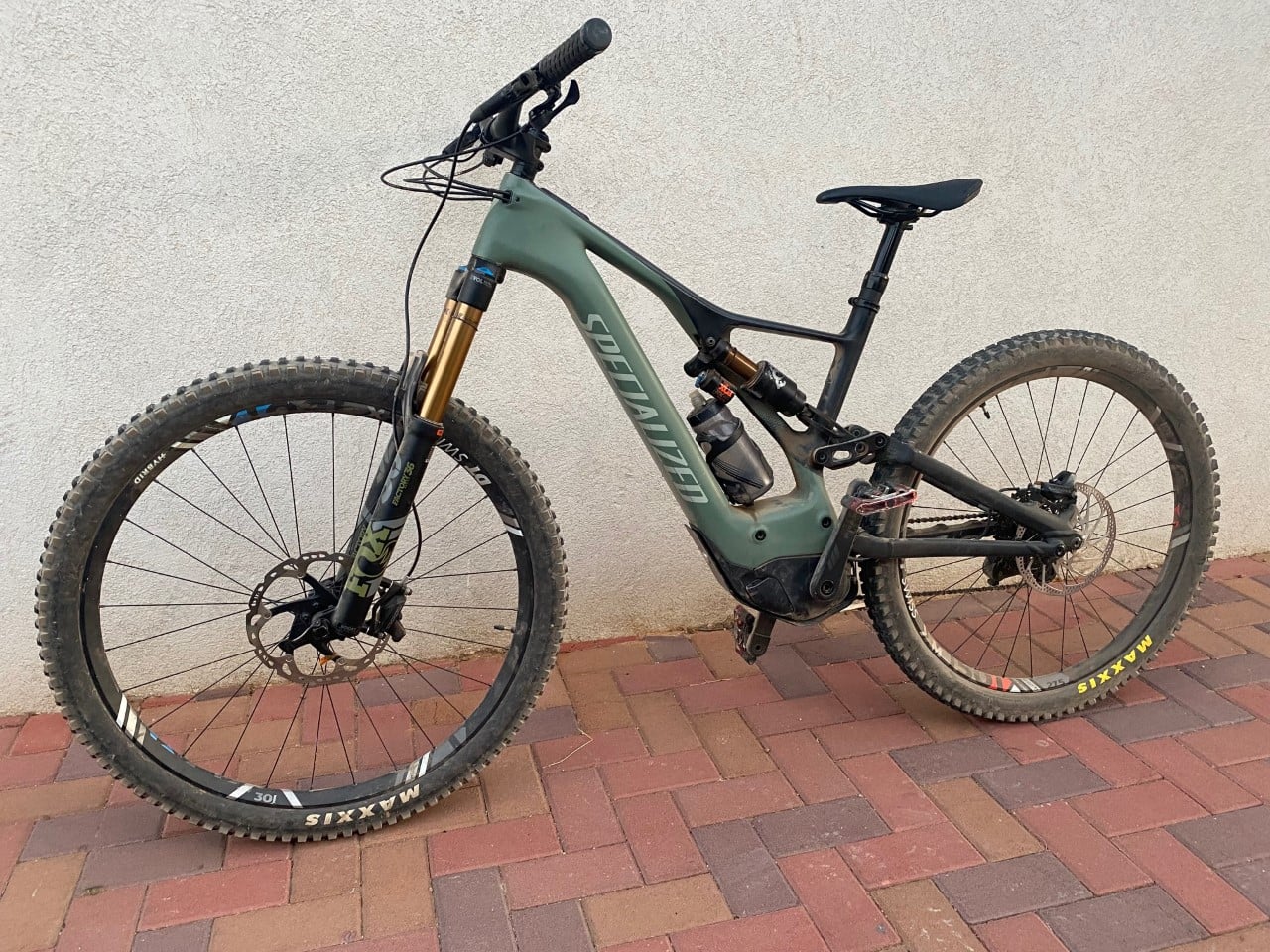

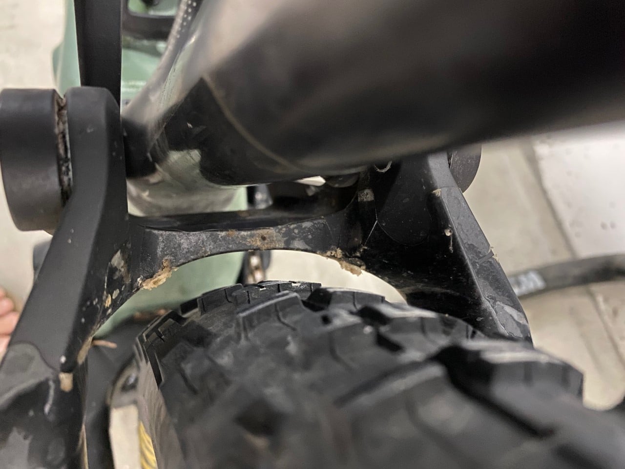

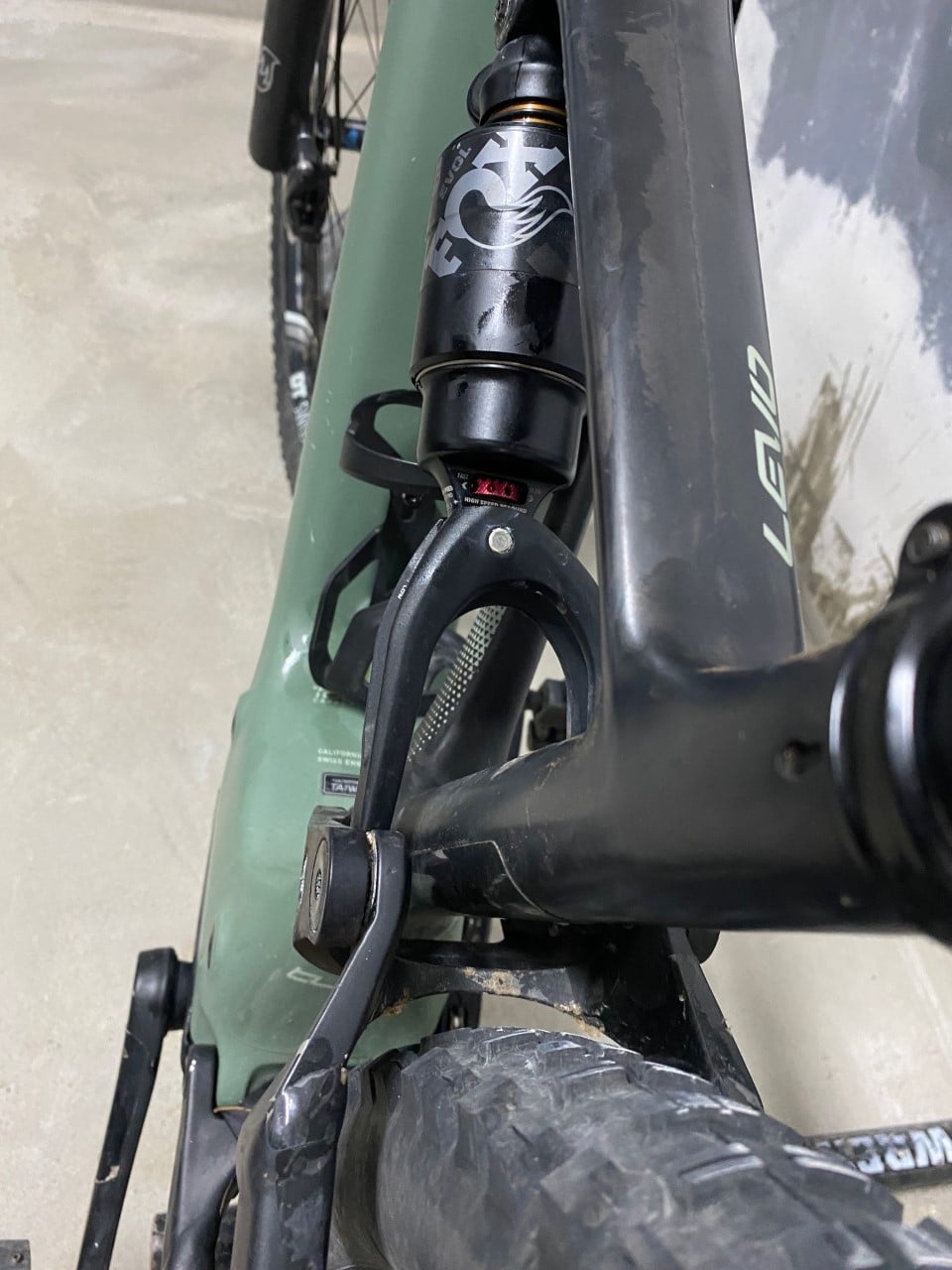

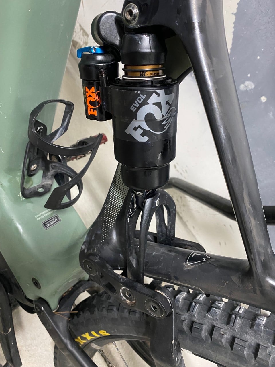

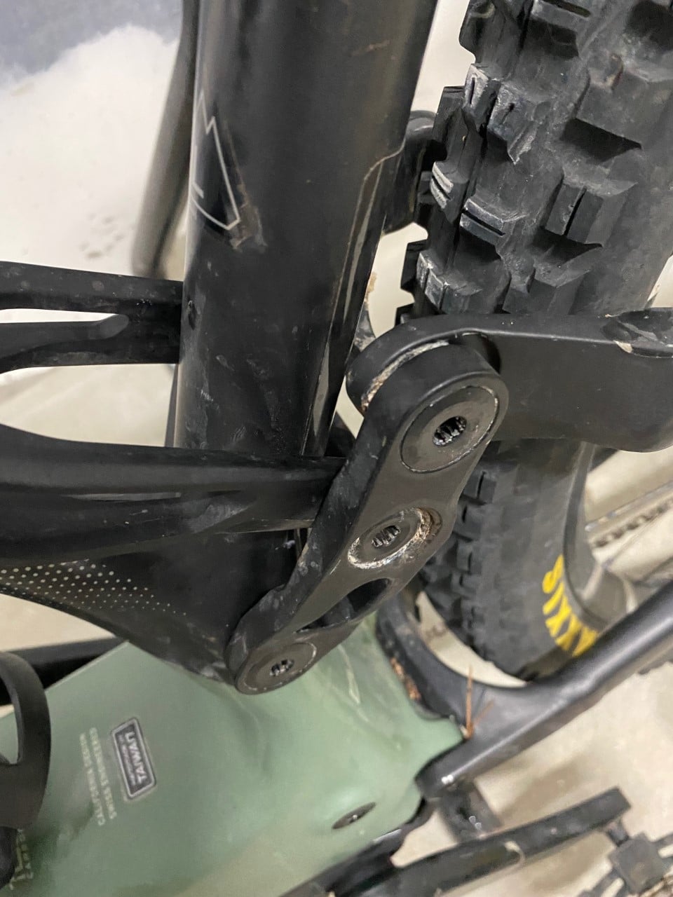

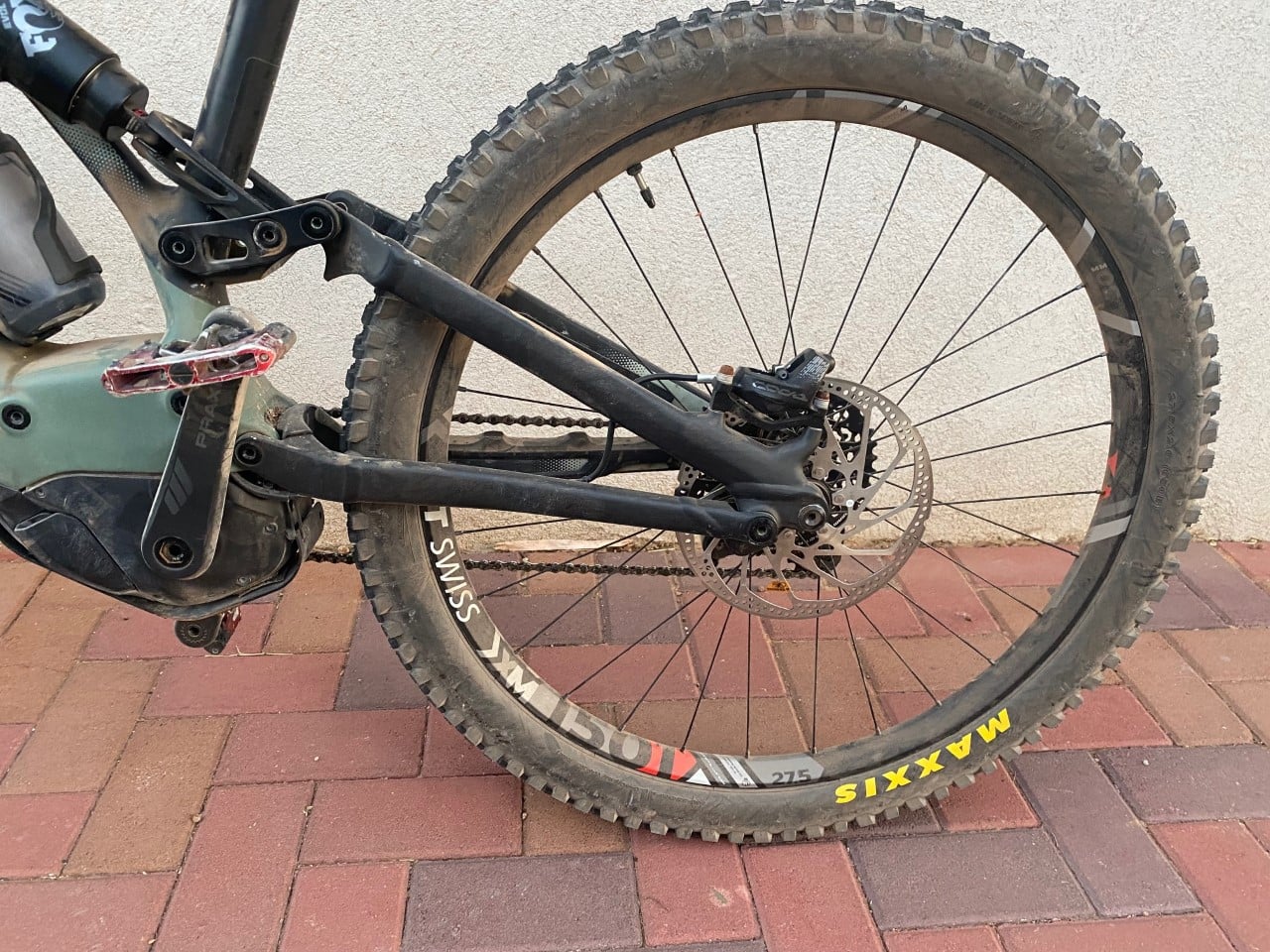

It works Cascade link + X2 210X55

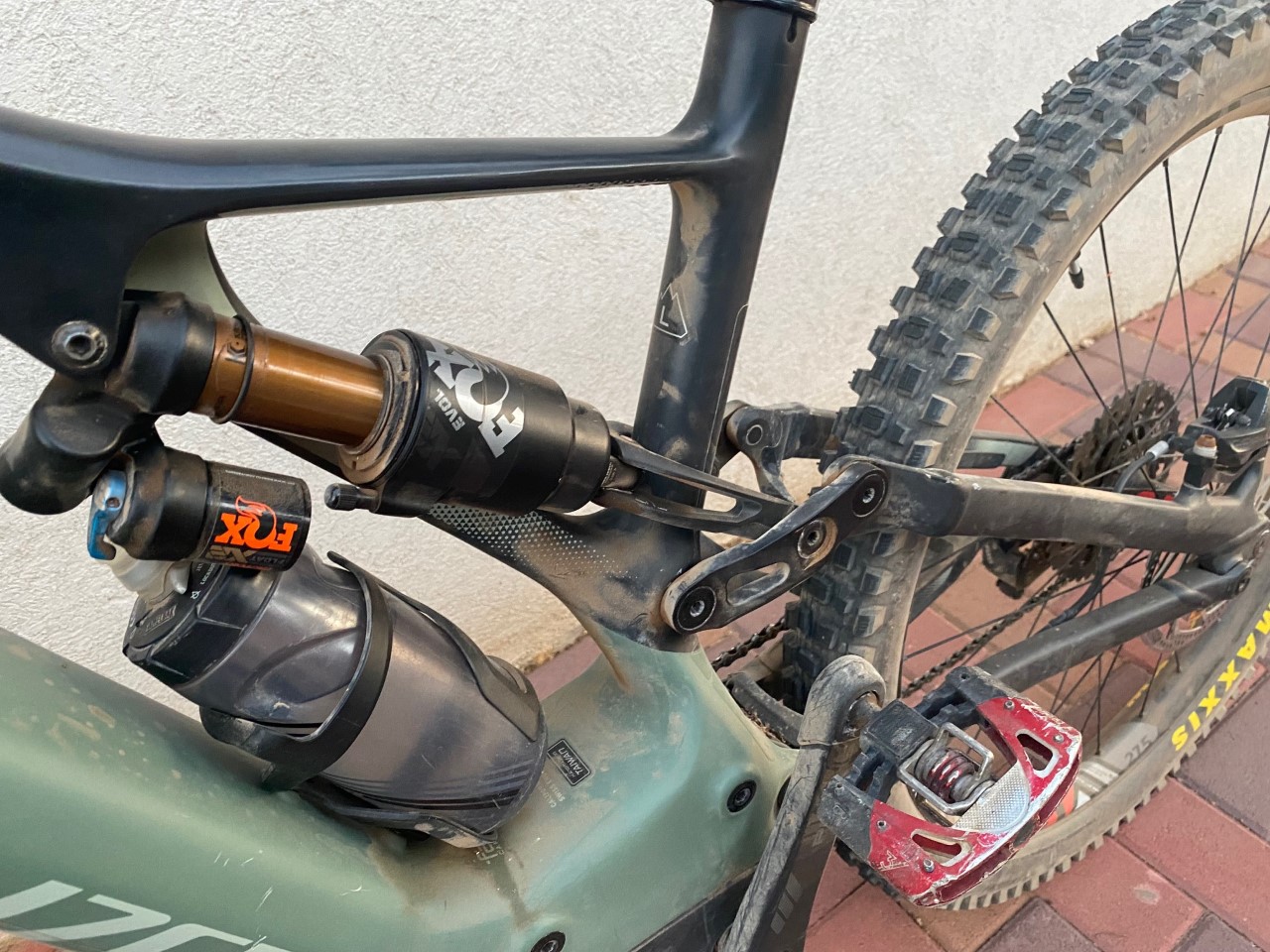

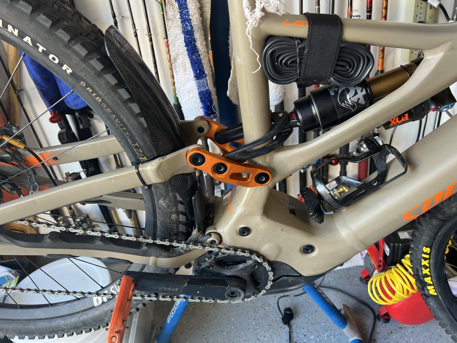

Its a winning combination! Here is my 2020 Comp with cascade link and 2021 Fox Float X2 210x55. Handles big hits and is super planted. I will warn you...if you are a bigger rider, this shock may not be for you. I am 220 lbs and near max 300 PSI just to get a little over 30% sag. I called Fox and they claim that the geometry on the Levo makes the Float X2 difficult to set up and adjust.

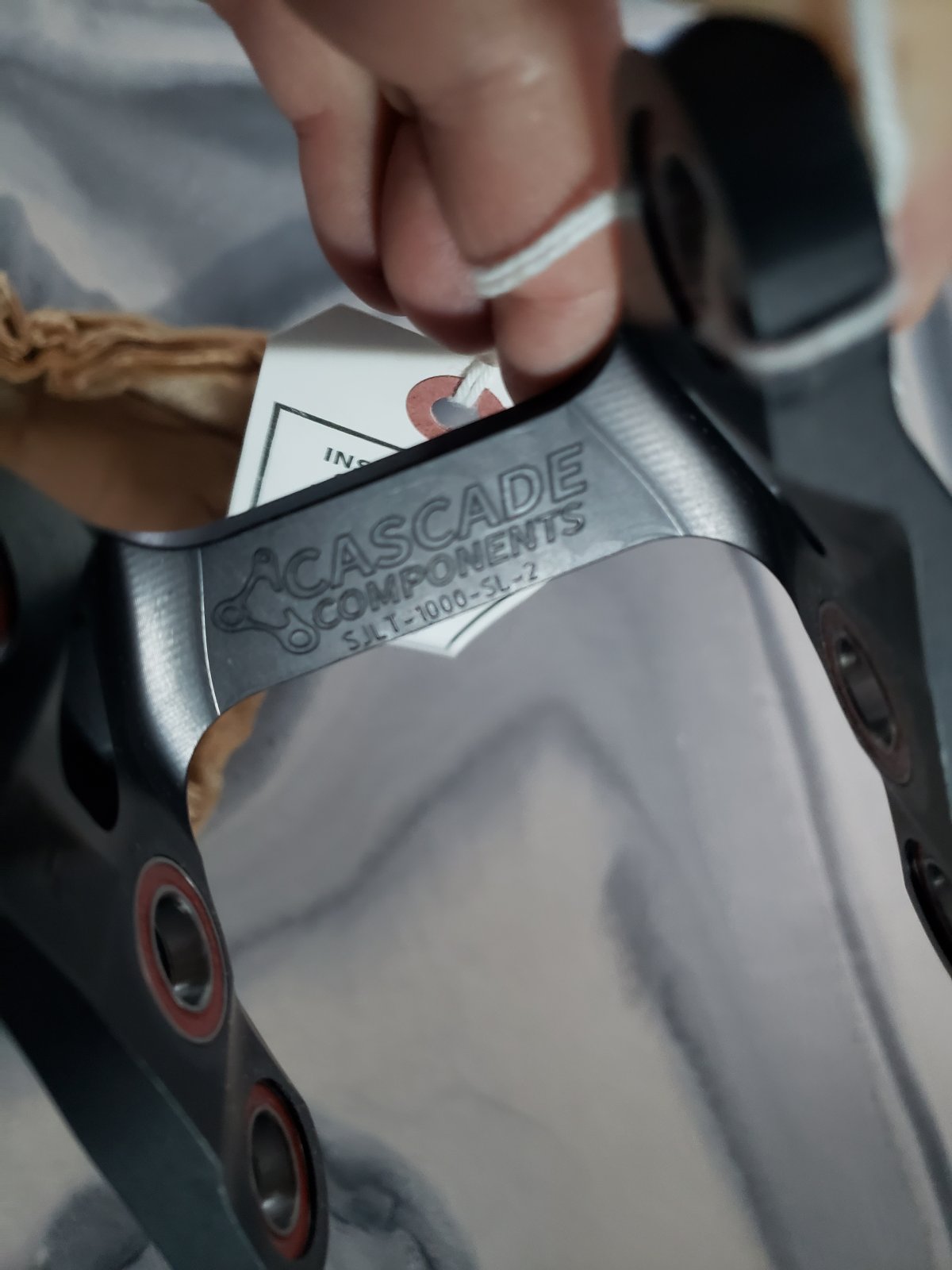

Got my Link last night. Gonna throw it on and ride later today and this weekend. Excited to see how it performs.. .mostly because I bought the SL to pair with 22 EVO and want to ride them in the same fashion.
