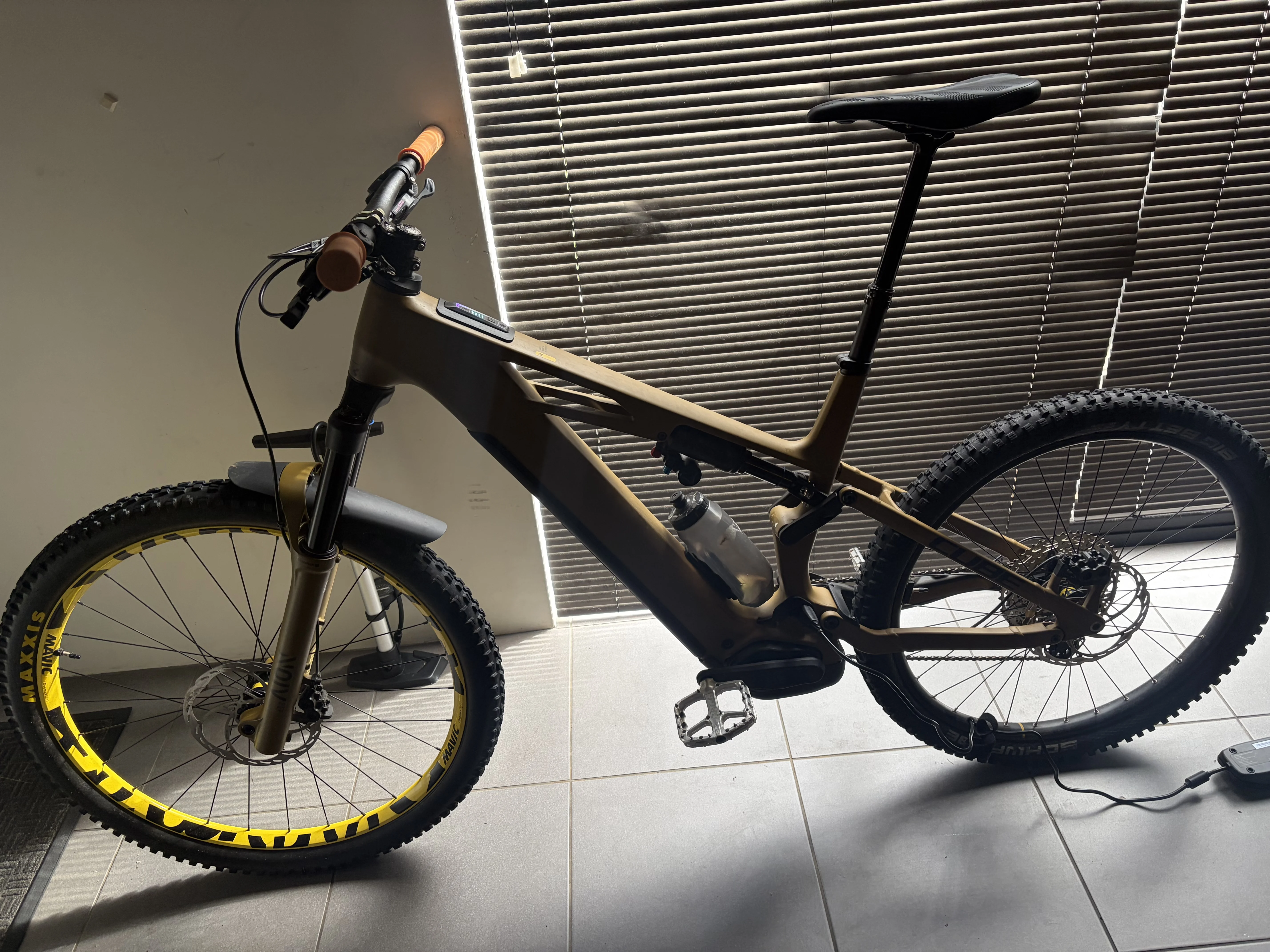

i want to run a Deemax DH rear wheel on my bike (to match my front wheel). As shown.
I know Mavic make the e-Deemax, but I’m vibing the yellow. I could get a rim laced up to an e specific hub, but would rather not.

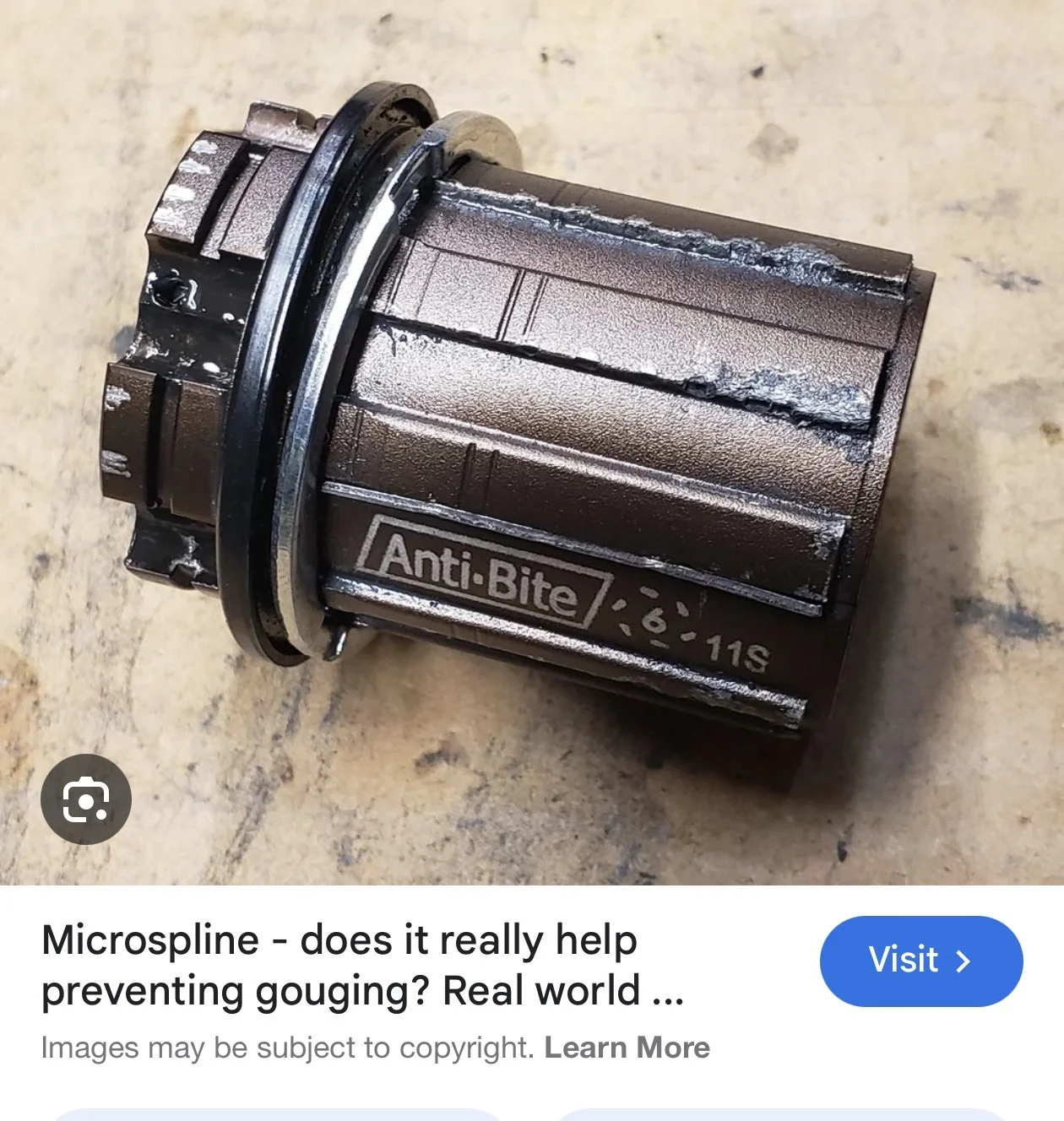

The hub is one place where you want to choose something that's durable and reliable under constant high power. Wimpy, no-name 3 pawl hubs are not something I'd put on an eMTB. But I'd think the Mavic Deemax hubs (newer ones with ID360) are probably fairly stout. It also depends on what type of cassette you're running. I've destroyed HG alloy freehub bodies on eMTBs, so that can be another source of issues.

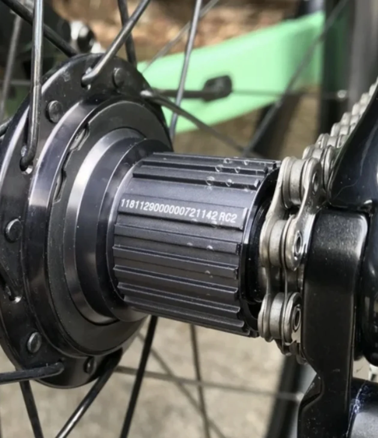

I don't see why not. A hub is just pawls, a ratchet & two or three bearings. FWIW I've run a non eeb Spesh back wheel on my Focus for two years & it's been fine. The other option is buy the decals & go matchy matchy for cheap.
E-Bikes can exert a significantly higher torque on the hub, BUT that will only affect you when you are a strong and heavy rider yourself and you often use full power with low cadence.
The new Mavic and most DT Swiss hubs don't even use pawls anymore
