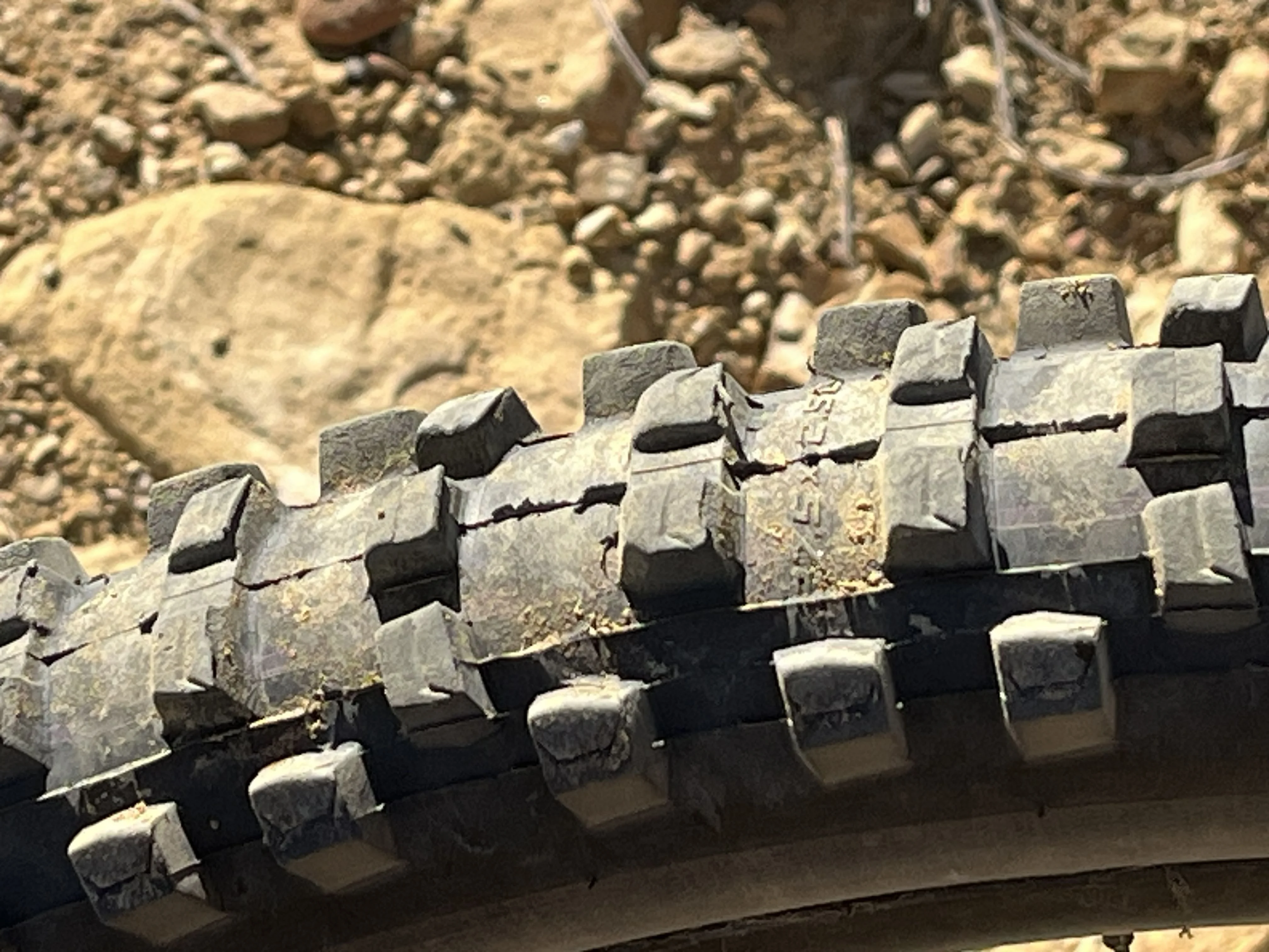

Speaking of Shreddas, I put one on the rear 2 weeks ago and while I'm not skilled enough to rate them on cornering, both climbing and braking traction are beyond compare. I ride loose desert rubble and these are the only tires I've ever had which don't spin on crumbly steep climbs. The added bonus is that I can actually use the rear brake to slow down significantly on steep loose descents!
I didn't want the Ultra-Soft for my rear, but it's what was available and I figured it'd be fun to experience the ultimate. I'd rate the Shredda as at least 20% better than the Big Betty in climbing/braking traction, 100% better than the Albert, and 200% better than the Hans Dampf.
That said, my next tire (within a few weeks?) will probably be an old school Betty or DHRII because wow, just like @unclezz, I'm finding that these Shredda's really do shred. I only have 60 miles on them so far and already the knobs are all smeared from climbing too hard. Yeah, definitely a mistake to put ultra-soft on the rear but note that uncle had only somewhat better results with the regular compound.
