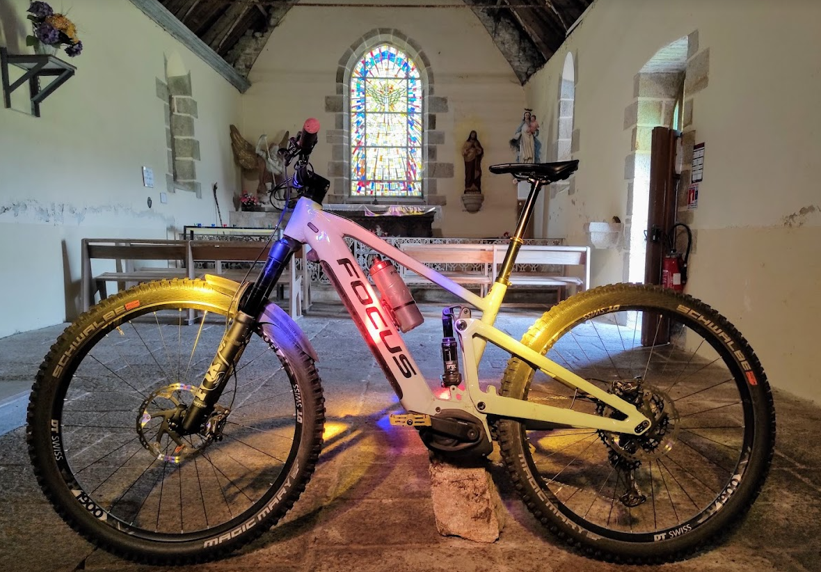

Only to give some examples, my 2019 Kenevo's had the crap knocked out of it, has all new bearings and rides like new.
My Focus Jam2 has been ridden reasonably hard, but if anything rides better than new and other than a scratch on the Purion - is like new.
Yup, things have scratches on, but lets face it, it's a mountain bike - so there's a good chance you'll add your own war wounds to it 10 minutes down the trail.
13,771
20,455
It might be psychosomatic, but I really think the Focus has got better with time .. (maybe fox suspension sometimes needs the sh1t kicking out of it when it's been assembled incorrectly ..........)
I'm selling both of them as I don't have space, or the time. I once imagined I'd keep all my bikes and hang them from ceilings in the chateau, but it's dumb and not going to happen ....
I'm only selling them due to small minded lust of newer models. I won't go any quicker or further .. well, maybe further .. I seem to have reached peak quicker - mechanics can only compensate so much for ineptitude !
I think it's a good time to buy second hand, I have mine as the cheapest in France just to get rid of them and have absolutely zero interest.

Moreover what do you want for the Jam? (I've always secretly been jealous of the colourway!)
13,771
20,455
So what new bike have you got your eye on then ? I’m guessing the Orbea Wild ?
That would be telling ! :)
Bosch, yes ... but not the Wild.
Good question ... If I was even remotely sensible I'd just keep it as it does everything you could ever want and the next gen looks fugly !
It's just had new pads .. it must be worth more than new now !
Probably somewhere in the region of €4200 ... What's that £3800 ish ?! Including the Switchgrade as it probably won't be compatible with the new dropper.
