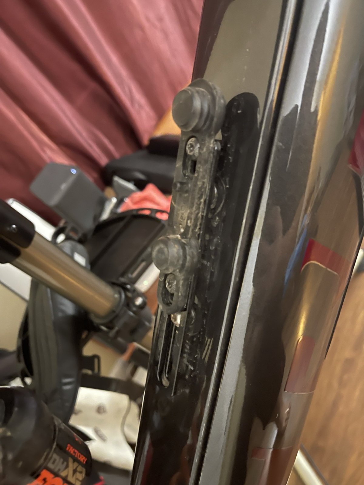

Does a side entry cage and bottle work on an XL rail with the super deluxe thrushaft shock?
hey.
so i just busted the bottom of my drink bottle. the piggy back canister on the shock hit the brink bottle.
im using a bontrager side load bottle cage (in its highest position) and the bottle was a 600Ml M20 (camelbak podium equivalent)
trek rail 9 XL
now trying to either re-think the mount, or find a bottle with a bigger bevel on the bottom.
Dam, this is the combo I’ve got on order. I guess I’ll use a backpack
Hey @ G
hey Grundy, i saw in another tread the suggestion of using a Wolf Tooth B-RAD 2 Mounting Base. this would/could move the bottle up the extra few millimetres to avoid the shock. i think ill try this

Heres a pic of the B-Rad2 w/ fidlock mount attached.
