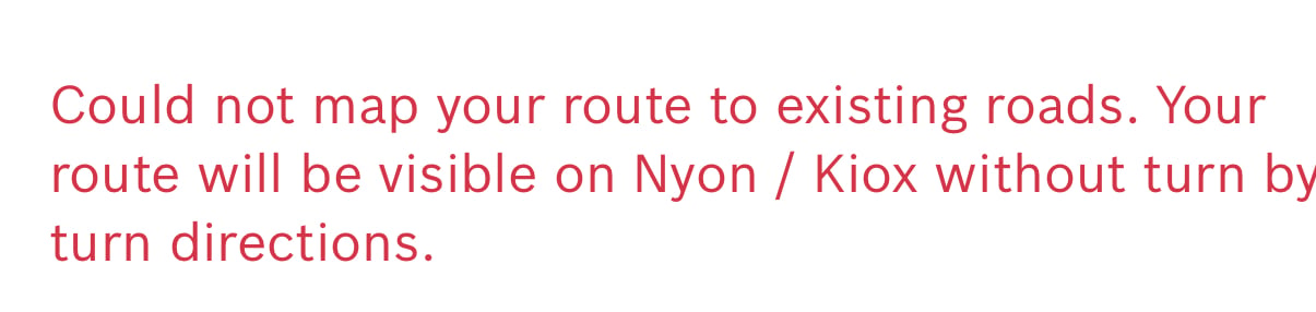

I've got a new Bosch Nyon and every time I import a gpx route into the eBike Connect portal from Komoot it says "Could not map your route to existing roads. Your route will be visible on Nyon without turn by turn directions."
I have tried making sure that the route is on roads only and not on any paths, cycleways, etc etc and it still gives the same error and sure eough the rout displays on the Nyon but it won't give any distance information or turn by turn instructions. I've even tried converting an already ridden route into a Nyon route and it still does not give me any turn by turn info. The only time it will give me turn by turn info is if I put a destination into the Nyon and let it calculate its own route.
Has anyone else seen this and/or got a fix for it? It's a massive PITA!
