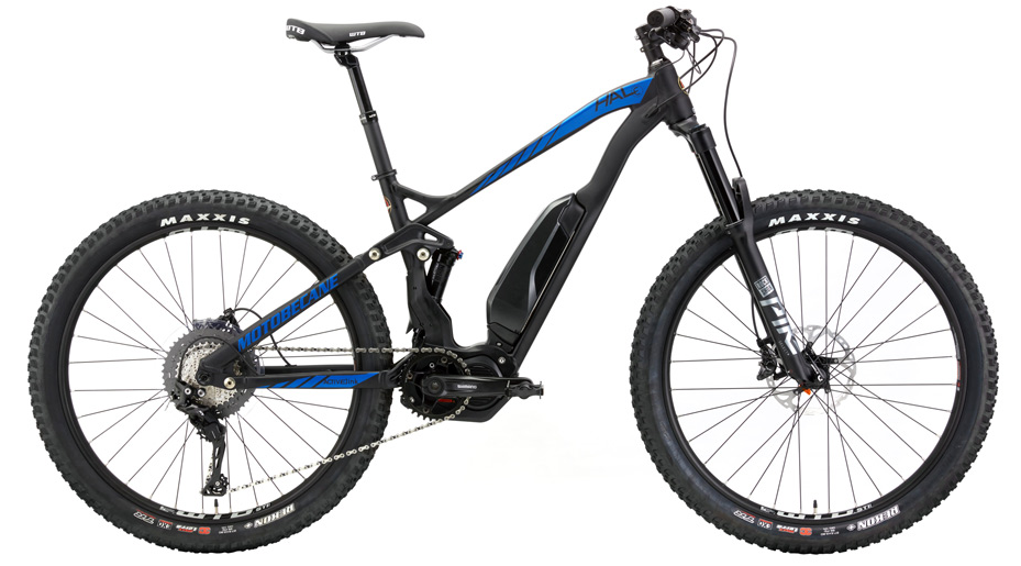

Interesting, looks like its using the same OEM frame as quite a few brands, e.g Megamo, and Decathlon use the Bosch version.

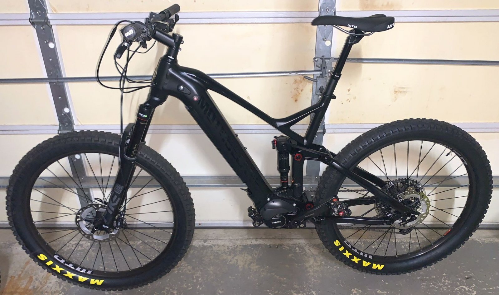

Looks like the BikesDirect's front wheel is a bit more tucked in... big turn off, as that makes it more prone to nose-dives/nose-plants.
I don't know...seems OK to me after one ride. I measure the HT angle at about 68 degrees. The front end is a bit on the short side, which works well for my proportions.

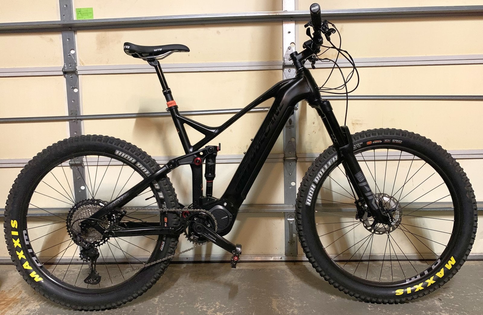

I don't see anything wrong with Motobecane e-mtb. I bought the other model with the battery on the frame. Been riding it since August 2019.

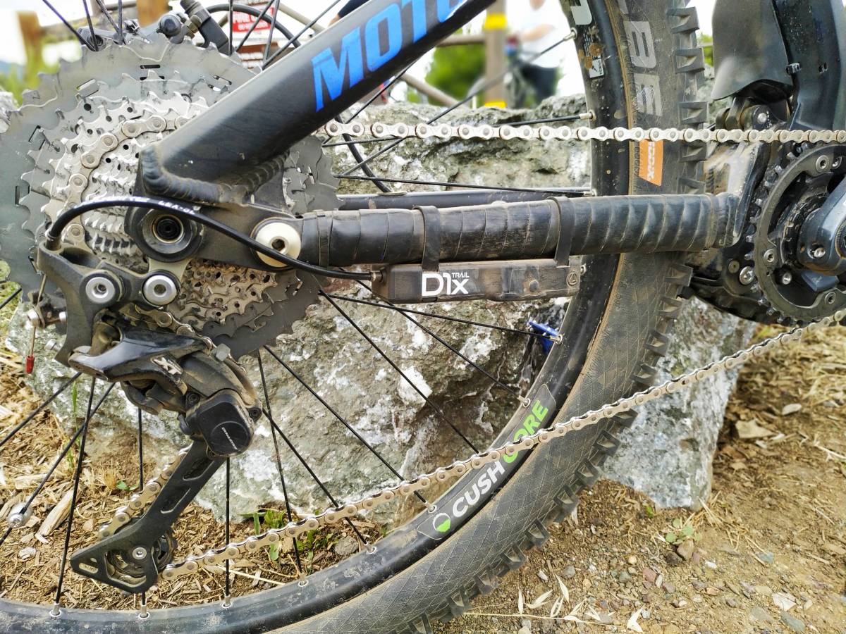

I think they are very good mountain bikes but you do have to swap out some parts to fit your riding style. At least for me, that's what I had to do. Anyways, here are the mods that I made on my Motobecane to fit my riding style.

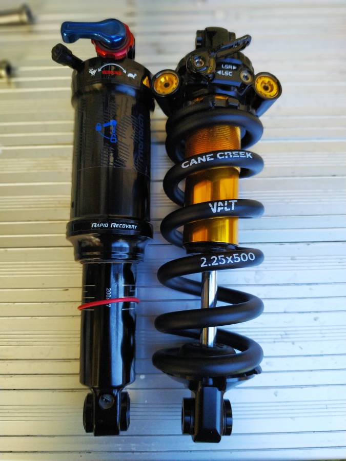

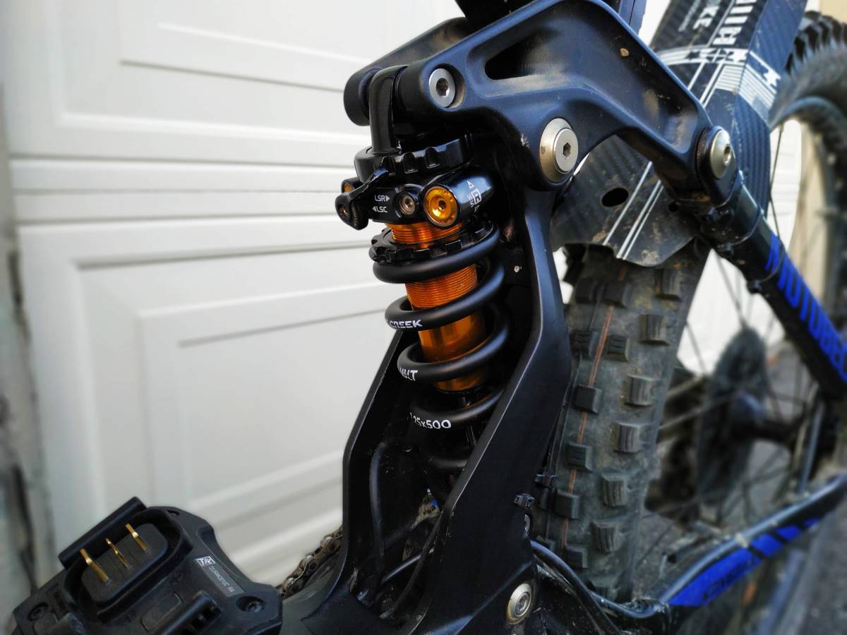

Cane Creek In-Line DB coil shock with 500 pound Valt spring (set to factory setting but with an extra clockwise turn on the spring perch to add a little more preload)

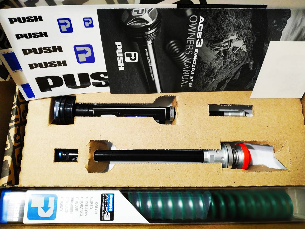

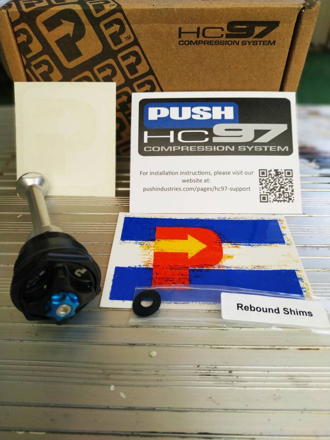

Converted the Rockshox Pike Select+ RC2 fork to Push ACS3 coil and Push HC97 damper.
With the coil fork and coil rear shock, the bike feels stiff, supple, and planted all at the same time. It reacts to high and low frequency bumpy terrain changes instantly. The traction is so good that I've found myself using the brakes 70% less. All I do is pick my line and the bike just does it for me, while I'm just there chillin.

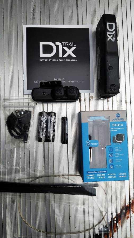

Archer Components D1x wireless shifter.

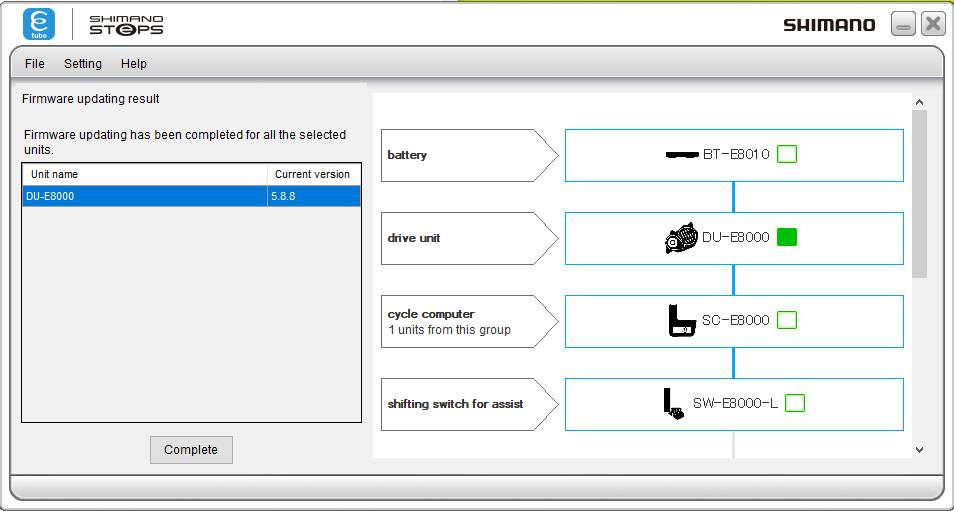

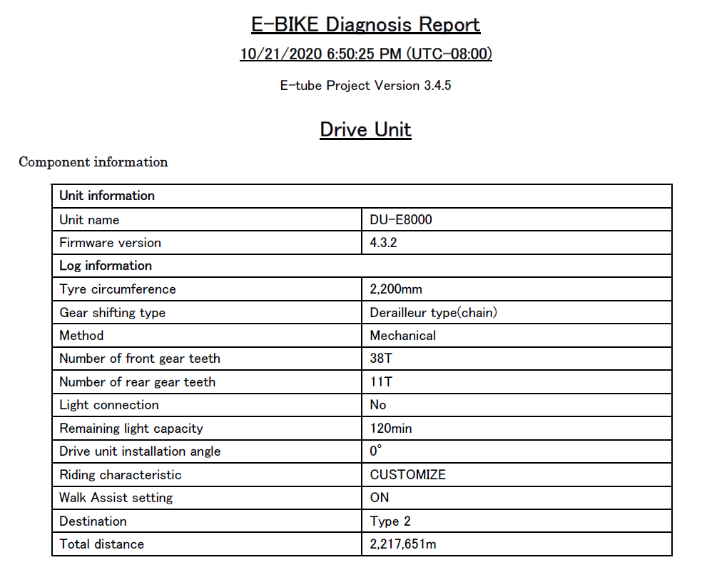

Downgraded the 4.7.1 firmware to 5.8.8 (aka version 4.3.2) and tuned it to my riding style.

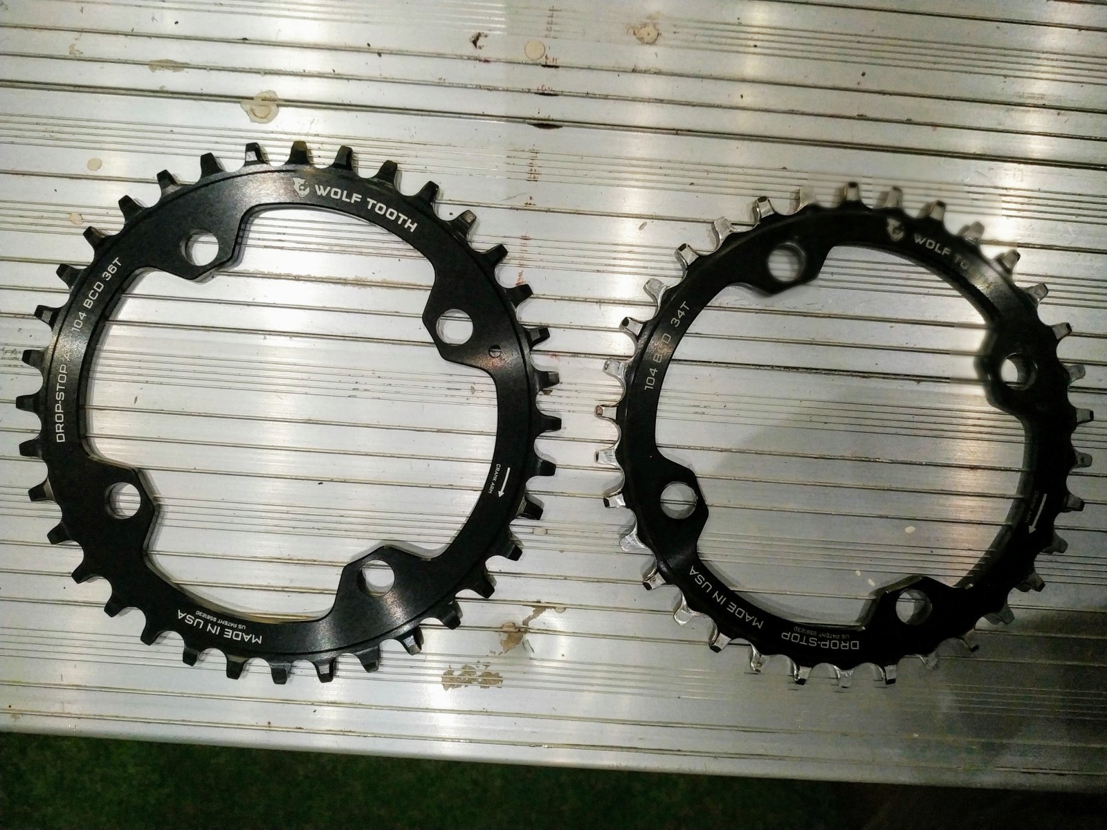

Replaced the Shimano chainring to Wolf Tooth Drop-Stop "A" 104 BCD 34T (and recent changed it again to Wolf Tooth Drop-Stop "A" 104 BCD 36T for more speed).

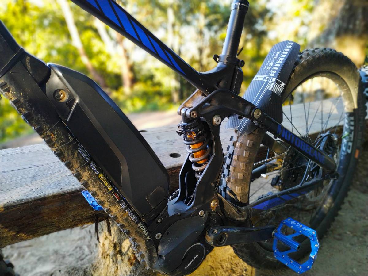

Installed a set of Cushcore Pro (these are my favorite mod on all of my bikes since I often get pinch flats). I also put on a set of 27.5x2.8 Magic Mary.
About 3 months ago, I was offered a 51% discount on a brand new Trust Shout so that's on the Motobecane at the moment.
My personal impression on the Trust fork is that "they are just ok". They're definite not worth the full retail price of $2,000 but for $910, they are. There's also a learning curve with these forks. The turn-in are immediate, bouncing on the bike isn't as pronounced as traditional forks, it can handle square edges like magic but slow to respond at high frequency bumpy terrain, and you have to land with the rear wheel first because landing evenly causes the fork to have a quick burst of jitters that you feel on the handlebar (kinda feels like when you're holding a broomstick or long stick and hit the ground with it. You know that vibration you feel on your hand.). It's been 3 months now with the Trust fork and I still prefer my Push modified Pike.
