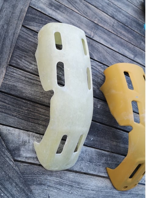

Any recommendations for a bash guard for a 2022 Rail 7 ?
I’m not sure if older models fit and which ones are any good.

I’m not sure if the older ones will fit but I’ve found that the aluminum bash guard is necessary for Rails on rocky terrain. My daughter has a plastic bash guard on her Powerfly 4, but that’s probably all she needs.
I’m on my third bash guard now and I keep one for a spare. If a small piece of cooling fin breaks off (outside of the bash guard protection area) make sure you soften the edges to prevent any migrating cracks into the motor casing.
A good bash guard is necessary (aluminum) but it will fit the Powerfly’s in my stable. I would not use the after-market fibre-glass or carbon fibre bash guards on my FS Rail or my HT Powerfly 5.
If a small crack develops in the “weak” area from a strike, then the bash guard is structurally compromised.
These after market bash guards are only good for looks or small pebbles.
