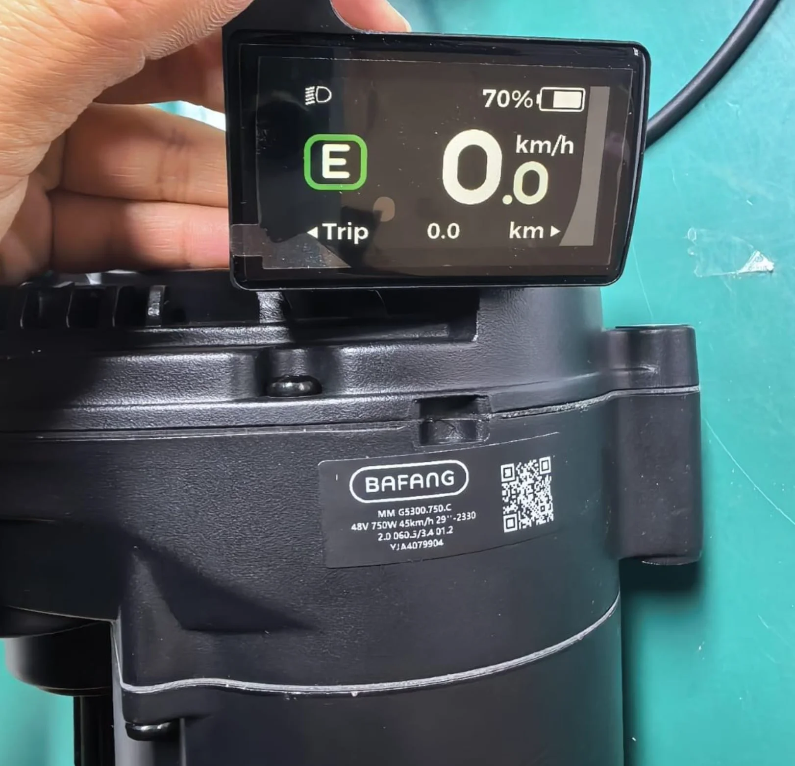

Looks like we have updated version of M560 FC2.0
So far only this label picture.
Unlucky, there is same torque sensor. Thought Bafang will use new torque sensor from RS model.
Firmware version 60.3 - these high number are usually custom firmwares for sellers.
27 Amps max. So plus 100W.
Will open it up, once it comes to my hands.

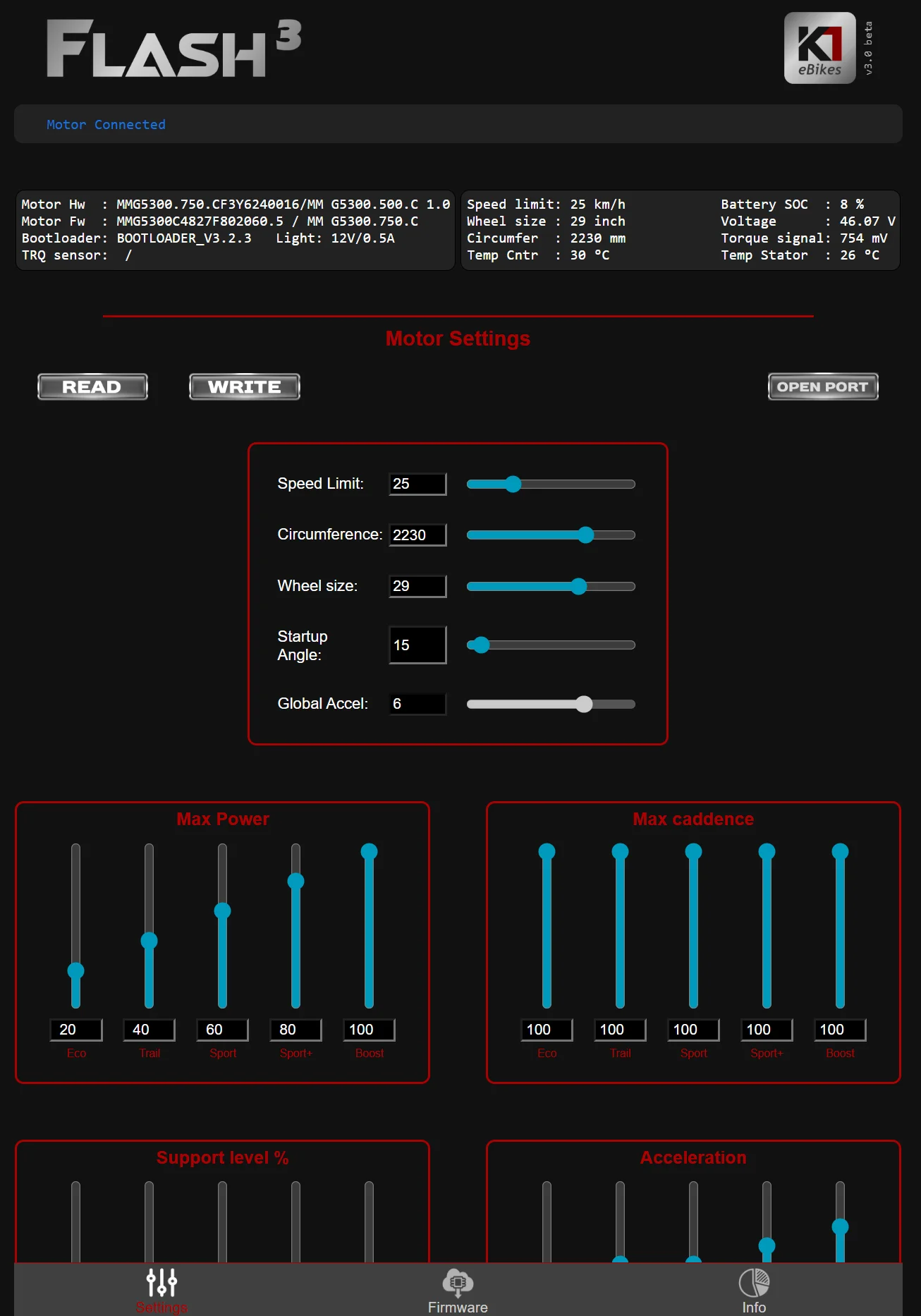

Possible to flash 27A firmware into M560 FC1.0 (same bootcode). Looks like all works on a bench. I am quite surprised FC2.0 firmware possible to load into FC1.0. It again breakes any labeling bafang conventions. ;)
Will try tomorrow on a road.
v60.5

Not possible to load older firmwares (v1.5 , v1.6) to FC2.0 - but it works other way (load 27A firmware v60.5 into FC1.0).

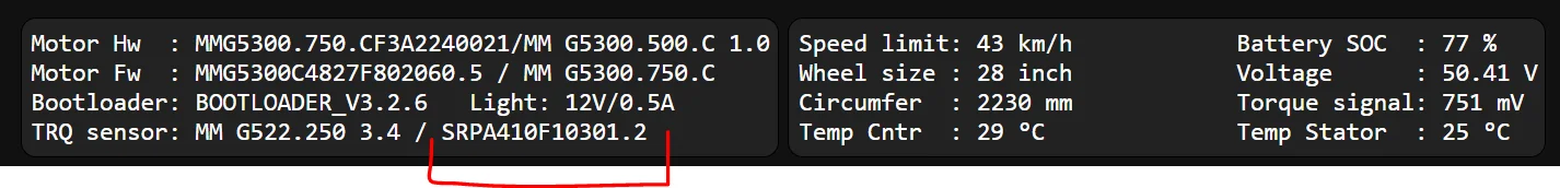

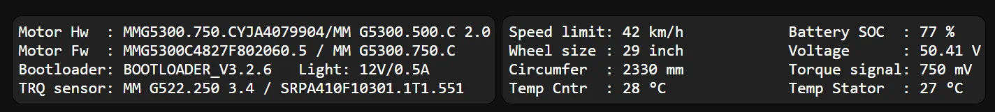

Looks like firmware in TS is different:
M560 FC1.0
M560 FC2.0
