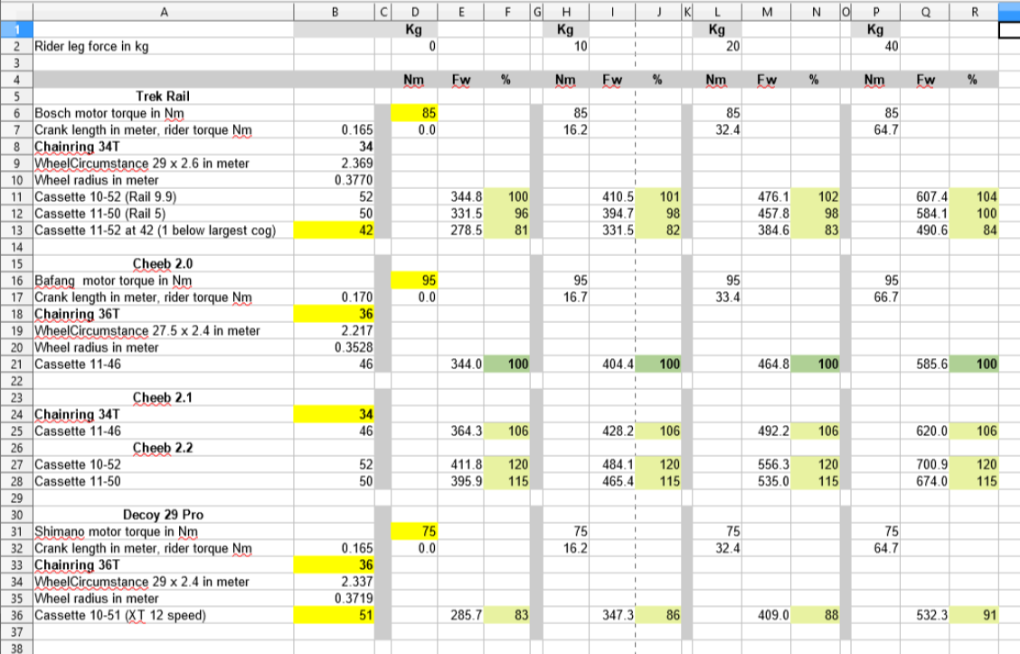

One thing is clear: the Cheeb just loosing against a top spec Trek Rail is a very good result for the Cheeb. But the Cheeb has more power...
I tried to understand it by doing a simple calculation. I hope what I did is correct and please correct me where I am wrong.
What did I do ? Put all in a spreadsheet and calculate the force at the rear wheel.
I ignored any kind of loses, motor characteristics, pedal stroke, begin speed, tires, etc. I assumed the motors are as strong as claimed (Bosch 85 Nm and Bafang 95 Nm). To compare the results I set the force at the rear wheel of the Cheeb 2.0 as the reference (100%).
The calculations show:
- the difference between both is not so much, in numbers
- the Trek seems to benefit more from the added rider leg force
- by replacing the chainring of the Cheeb from 36T to 34T it could win, although it is a minimal win
- if you are willing to upgrade the cassette (plus derailleur and shifter combination) there is much more to gain for the Cheeb
- my Decoy 29 Pro (Shimano E8000 75 Nm) cannot win from the Cheeb
What if you change some numbers (yellow fields) ?
A Decoy 29 Pro with Shimano EP800 (85 Nm) and a 34T chainring and 10-52 cassette should be a match to the Trek (in numbers).
What if the Bafang is just a bit less strong as claimed (94-92 Nm) or the Bosch is a bit stronger (86-87 Nm) or both ? The Trek wins.
What if you go for the Bafang M600 with 120 Nm ? The Cheeb wins.
For a self build I will choose: 34T chainring and a 10-50 cassette.
So what would be the force delivered at the wheel ? The formula would be, with:
Fr = Rider leg force in kg
Lc = Crank length in meter
g = gravity earth 9.81 (kg to Newton)
Mt = Motor torque in Newtonmeter (Nm)
Tc = Teeth cassette (largest)
Tm = Teeth chainring motor
Fw = Force at wheel in Newton
Rw = Rear wheel radius
The total input torque is the sum from driver input and motor: (g * Fr * Lc + Mt).
What you put in in torque must come out: (g * Fr * Lc + Mt) / Tm == Fw * Rw / Tc
or (rewritten) the force at the rear wheel :
Fw = (g * Fr * Lc + Mt) * Tc / (Tm * Rw)
TREK Rail:
Cassette 10-52 (Rail 9.9) or 10-50 (Rail 5), both chainring 34T, crank lenght 0.165 mtr
wheelcircumstance Bontrager XR5 Team Issue 700c/29 x 2.60 = 2.36901 mtr, radius 0.3770 mtr
CHEEB (assuming these are the correct numbers):
SHIMANO M4100 cassette 11-46 , chainring 36T, crank length 0.170 mtr
wheelcircumstance 650b/27.5 x 2.40 inch = 2.21771 mtr radius 0.3528 mtr
Wheelcircumstance from: BikeCalc.com - How to calculate Bicycle Wheel Size
Spreadsheet (free): made with LibreOffice.
TREK Rail:
Wow, what a job !!

I think @Equilibrium hit the nail on the head. Even if we assume that Bafang actually measured 95nm of torque accurately before making their claim, we don't know anything about the torque curve at a particular cadence. It's possible that either the software holds back at a certain cadence or the hardware has some kind of ceiling it runs into.
