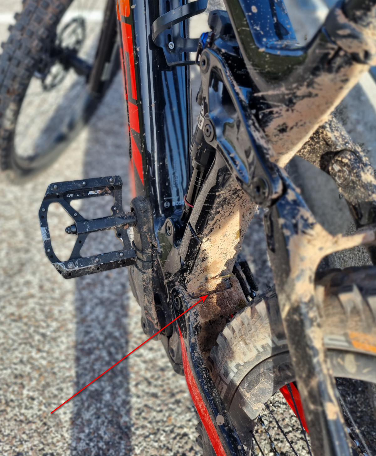

What do you think about this "slot" that fills with mud, pine needles, small pebbles that get stuck (they ruined my paint)?

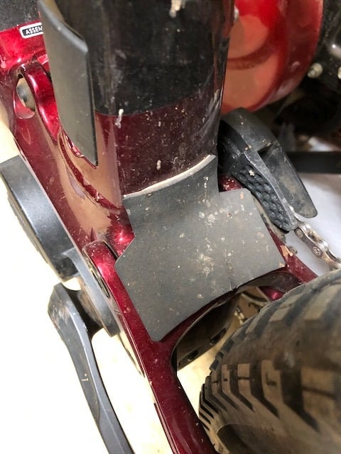

It is a common problem. If the slot was bigger, then bigger pebbles would jam in instead of bouncing off. The solution is a flexible cover. I have seen many different home-made on these pages.
Agree
This isn't exclusive to trek by a fair margin Most bikes have a gap there which can cause issues if left
But as already said a mud guard or small rubber flap can solve the problem in an instant.

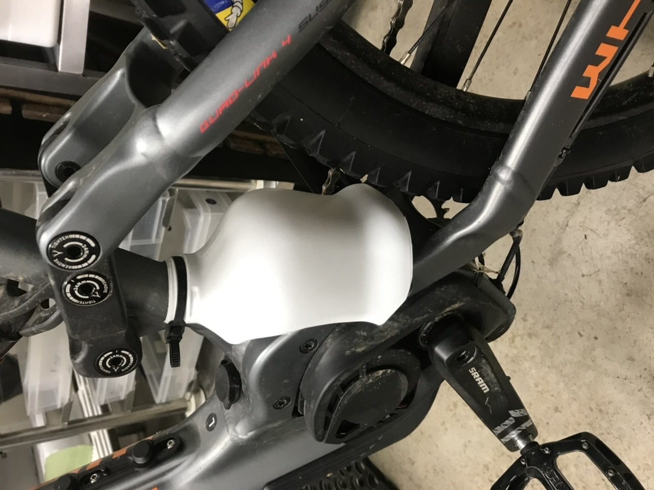

Er, I have to admit to not owning a 3D printer, but I did manage to salve my inner ‘Blue Peter’ instincts, courtesy of the milk marketing board! A removeable cable tie helps with easy on and off:
.....maybe a quick paint job would make it a little less.......Whyte! To be honest I' not sure why you do not just fit a rear mudguard to achieve protection of the chainstay pivots but also the seat stay/yoke linkage bearings which are in the direct firing line of trail mud/water coming off the rear tyre ( main exit point off the tyre is the top of the tyre). I use a Mudhugger FRX ( front mudguard but fitted on the back))
